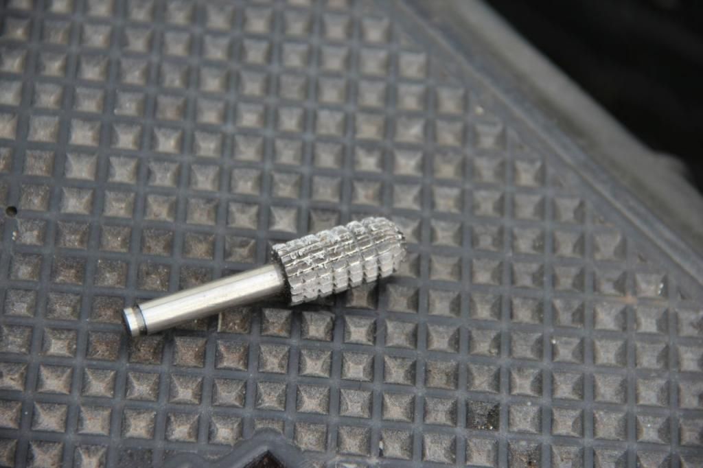

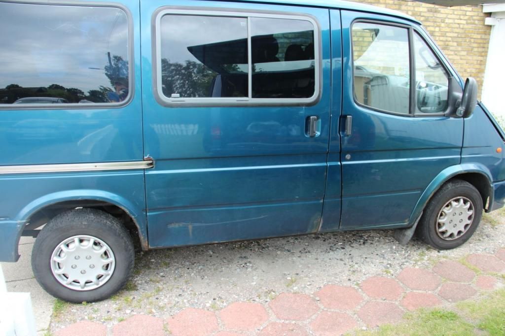

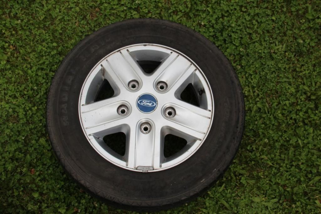

Here's how I modified some mk7 alloys to fit my mk5 Tourneo with only hand tools available.
This is how it looks now :D :D
I bought some used alloys from dba (a danish division of ebay) for 200£ - in very good condition and with good tyres :D

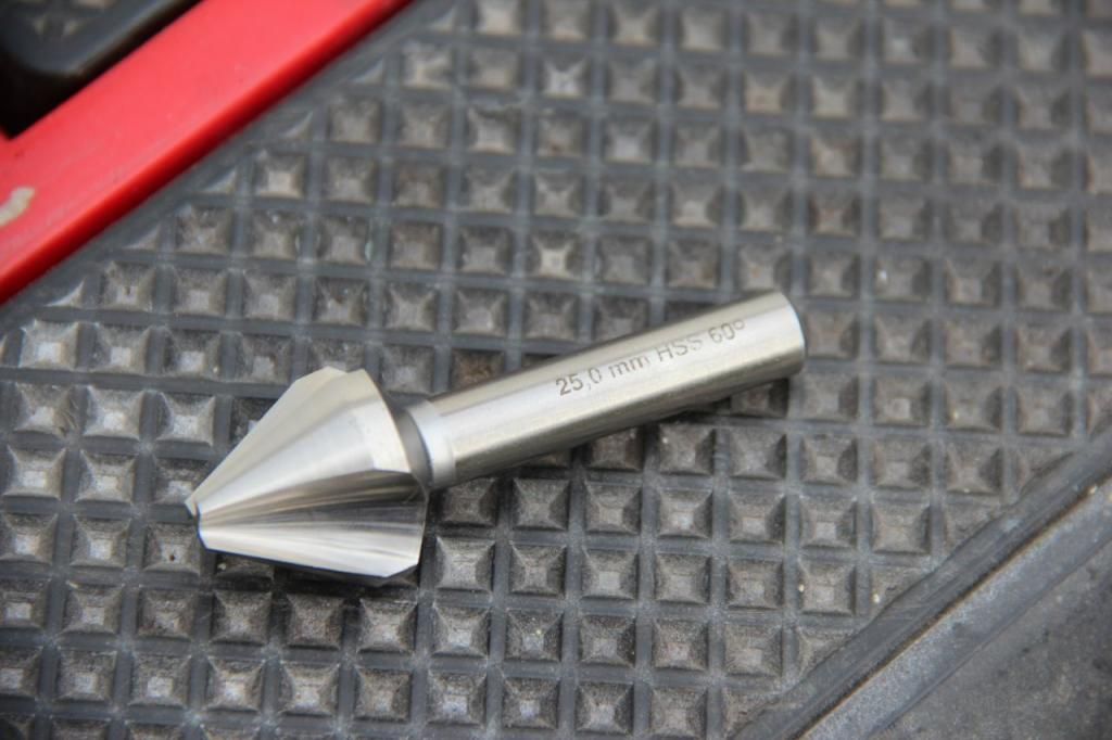

In the beginning my plan was to drill out the holes to 20mm and then mount them with "Toyota" style flat nuts - but I couldn't find them anywhere in Denmark :evil: (and I just couldn't wait - so ebay was not an option)
So instead I countersunk the holes to fit normal 60 degrees alloy nuts using this tool on a normal drill :D
With a mix of caution and patience it was actually an easy job - and the wheels are perfectly in balance - I didn't even have to change any wheel weights

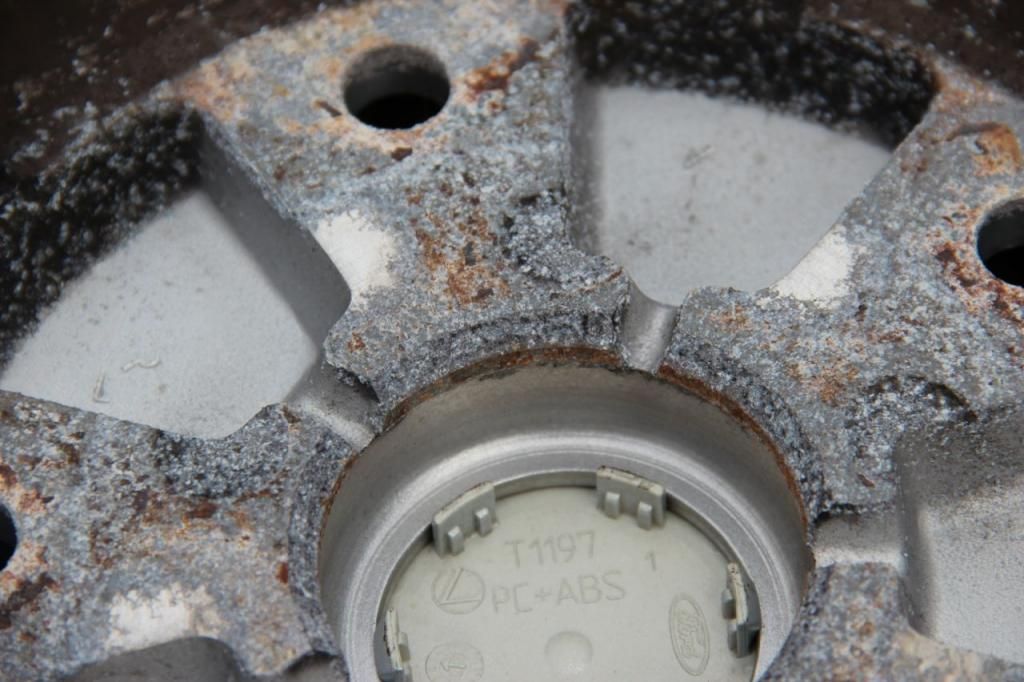

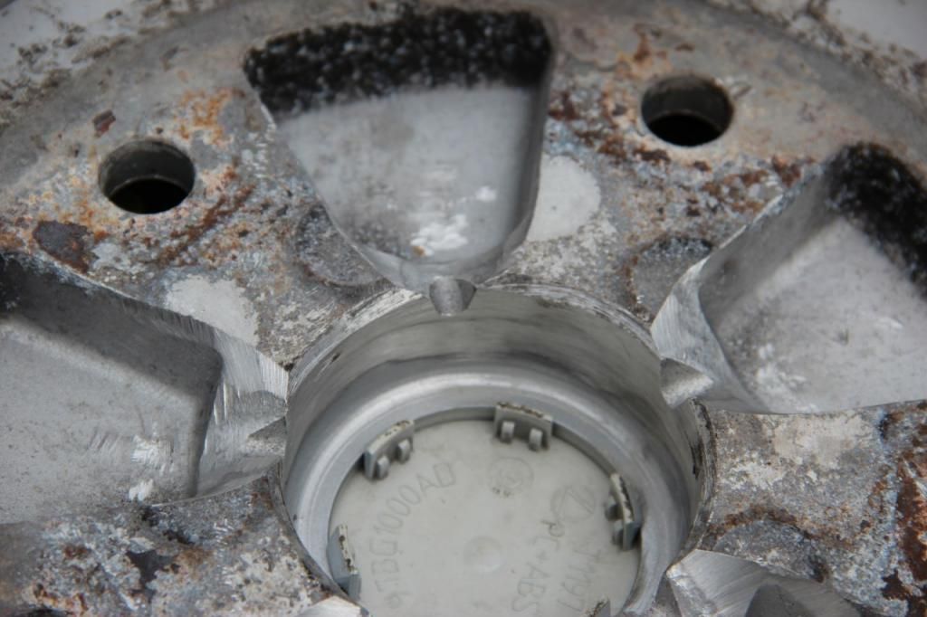

On the rear its a direct fit - but on the front axle the mod requires a bit more work
The inner boss is to narrow to fit over the bearing hub, and the 5 bolts on the hub take up too much place, so I had to grind some of the material off
This is the wheel before
And this is after
And heres the tool I used
In total it took about 2 hours - but what a different bus :D
Before
and after :D :D
They have been on the bus for half a year now, and they have done approx. 15000 miles and I can tell you that they run absolutely perfect, so there's no reason to fear an alloy mod with hand tools :lol: :lol: :lol:
