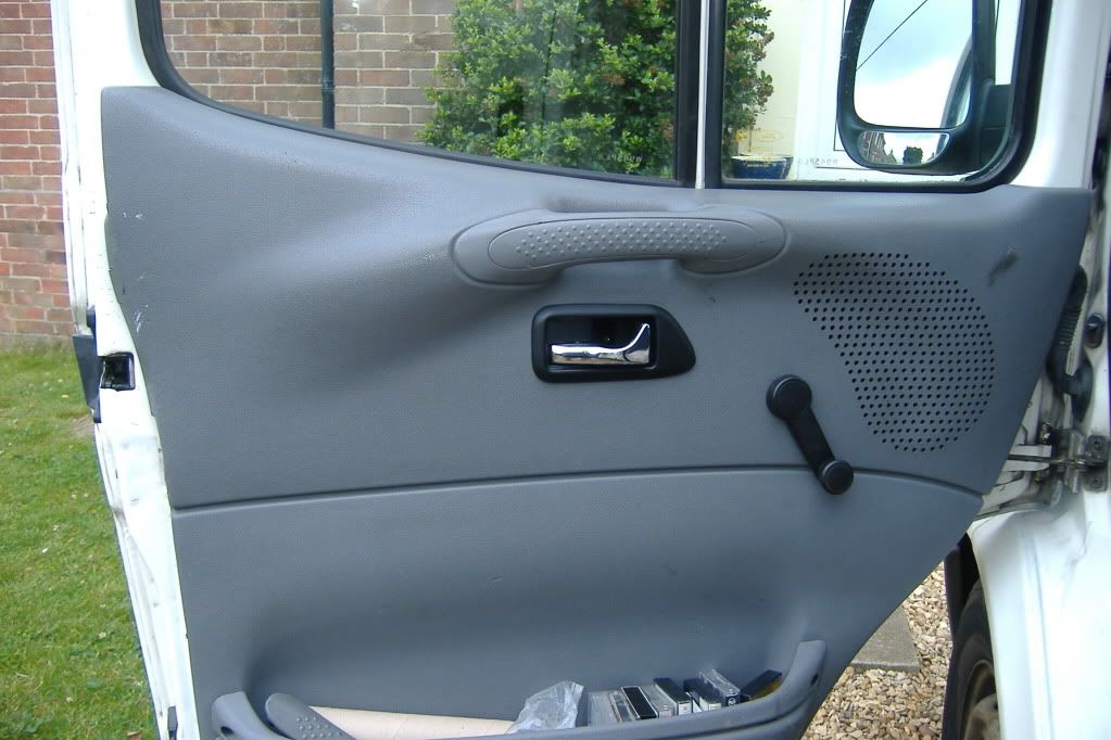

Hope you likey I know I do. Maybe I should have bought the tourneo DOHC in the first place.
These beauties are from a scorpio, the same cable size, the same bucket size. Very simple mod
Right, so, you have to find a donor first, scrap yards, can be bought for free! :wink: As you take these out you will see how they will go in to your van. The door cable is the same size, just push downwards to remove the plastic clip. The hardest part is removing the window winder spring clip on your van.
When I looked at the passenger doors they have the same chrome handle but a longer back piece with an ash tray fitted, I'll check these out next time. I do think the mondeo may have parts suitable for transfer, maybe the heater controls.
You can also see the passenger side door bucket i obtained for a quid.

I like it! 8)
Would like to do this upgrade as well, am I looking at the right year and parts below?
Handle surround:
Ford Scorpio MK2 (1994-1998) N/S Passenger Left Door Interior Handle Surround
Chrome handle:
ford scorpio ultima / frog eye n/s passenger rear interior door handle
£ 8.00 - did not sell
Ended Wed Feb 15th  7:20pm BST
Seller: essexusedcarparts
Also, would they work with central locking without and mods etc?

Postby halla » Fri Mar 03, 2017 11:50 am
mine is central locking. After years of service I would give this mod a 9/10. need a little fettling on occasion.

Here are my satin finish handles from a Focus ST on a MK7, straight swop.
