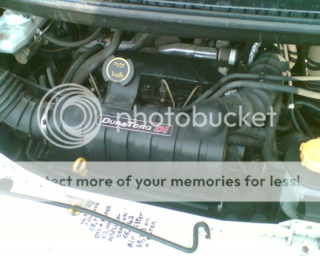

Postby Grumpy ol' man » Mon Jan 11, 2010 12:45 am
Right, mines been running ok now for two days since I had variouse bits off and on. I only found one thing obviously wrong which was the trapped and worn wire
(circled middle right of picture,) between the top of the intake manifold and bottom of the
air intake resonator, (box that has Dura Torq on it.) I haven't found
out what it's for yet as I've been too busy to check but after repairing it and moving it to
the side, the van has been fine since, touch wood.
