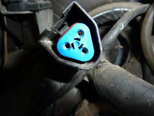

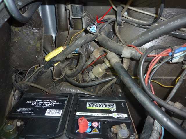

I have a Transit 2.5 Turbo Diesel camper build 1993 and I'm looking for information about it's diagnose plug.
The only connector I found in the engine compartment was that:
Is that the right one ? As far as I can see there are three pins, does anybody know the connector pin assignment ? What protocol is used for the data transfer, is it perhaps a simple serial protocol, which could be read by a simple serial interface and a terminal program ?
cheers
Sven
sven98de
Posts: 2
Joined: Tue Aug 23, 2011 12:44 pm
Location: Hamburg
Re: Transit 2.5 Turbo Diesel diagnose plug
Postby MinorMatt » Tue Aug 23, 2011 3:32 pm
that does look like a diagnostic plug - my mk5 has one there and as far as I have been able to work out its for ABS. I thought the mk4 socket was in/around the glovebox area?

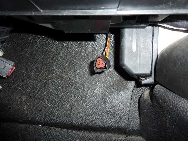

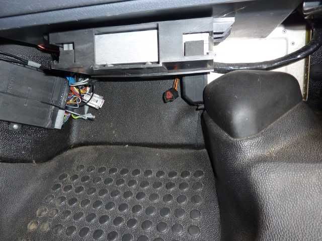

Postby sven98de » Tue Aug 23, 2011 4:41 pm
Do you mean these plugs, which are located under the glove box ?
What are they for ?
Postby MinorMatt » Tue Aug 23, 2011 5:03 pm
I think they are the engine diagnostics
Postby MrMPuk » Tue Aug 23, 2011 5:07 pm
That's the ones.

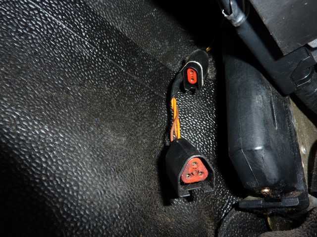

Postby V184 » Tue Aug 23, 2011 6:11 pm
The 2 pin is for the Ford fds2000 tester you used to have to fit a inline adapter, the 3 pin was for a star tester cant remember which one the Lucas tester used
V184
Posts: 3623
Location: You're right, V184 is a God !
Postby ake » Tue Aug 23, 2011 7:36 pm
Sure lucas uses 3 pin
