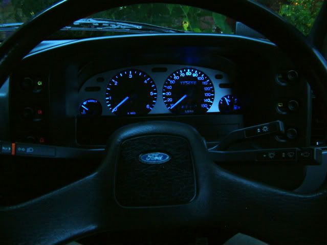

Anyway, got a bit bored today... so made up some new dials bulbs. Not sure I like them, but they might grown on me
Re: My MK3 Day Van
Postby gatecrasha » Mon Aug 04, 2008 1:42 pm
bloody hell alan,
that looks smart with the blue led's
i wont say anything at all about using a 1/4 tank of fuel while it was being worked on
:lol:

Re: My MK3 Day Van
Postby AlanN » Tue Aug 05, 2008 7:22 pm
gatecrasha wrote:bloody hell alan,
:lol:
:lol: must be running a bit rich!!!!
No I took the photo a day or two later

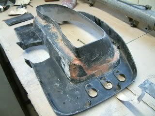

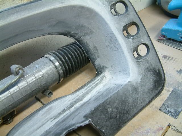

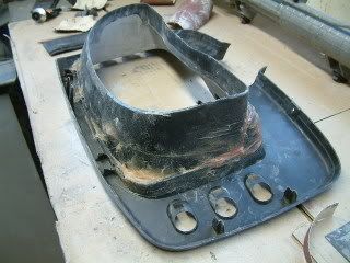

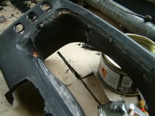

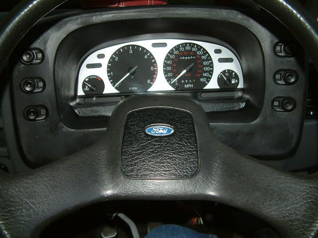

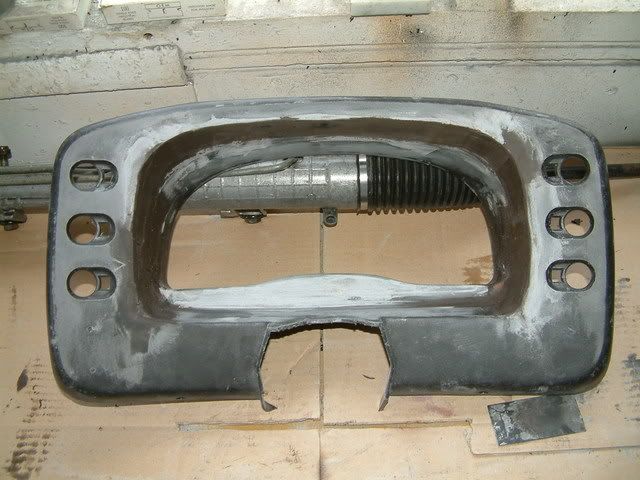

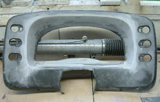

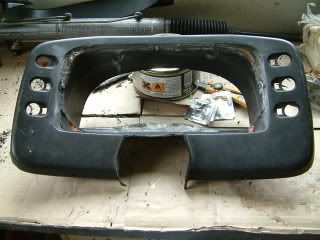

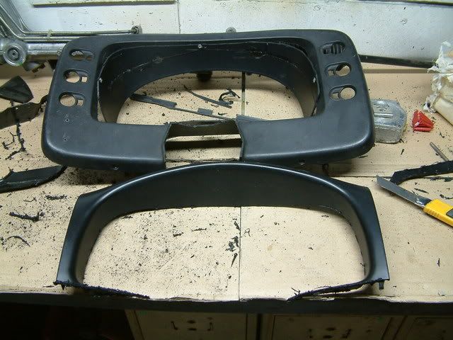

Ive been meaning to get on and finish the dash surround and thanks to Thrud, who gave me a transit/mondeo clock surround, I started to make the mould last night.
I had a couple of go's at cutting the two surrounds, which I ended up regluing back together, as it just didnt sit at the right angle.
Happy with the angle, I screwed them together and bonded them together with P40 fibreglass, not a pretty sight. Once set, using my favourite isopon bumper fill, started to blend in the joints between inner and outer contours, trying to make it look like it was made that way. Rubbing down with 80 grit and the electric sander, gave the right sort of shape and was starting to look like Ford could have made it :lol:
ImageWell, the mould is just about finished and Ive given it a quick prime and a splash of satin black, a quick test fit. If I gave this some more time, I could end up using this as a finished article, just needs a quality paint job, but Im still looking forward to seeing a carbon mould, which still havent been given a quote for as yet... Looks better in the dashboard, than the rough finish on my shed bench...

looks far better 8) :wink:
you throught how you gona paint your dash and colours?
