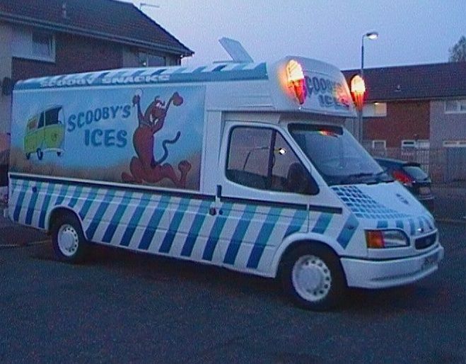

hi just thought id share some of the things ill be doing to my ice cream van trying things iv not done before hopefully come in useful to some of you guys n gals too,i want to give her a bit of a spruce up when i first got my van it was a bit of a bucket spent three days getting it ready for it mot due to welding shes a solid old bus now bit of a paint job she was neglected for years just getting patched up to get her throw her mots etc iv spent a lot of time getting her to be as reliable as poss not easy lol and i'm still struggling away but it more to do with the battery side of things but hopefully in the next week that will be sorted.want to put a A bar on which ill make i'm going to make a steel sun visor as well i will be putting up how i do this as well done 4 years in a fab shop shouldn't be a problem,i want to put a slight tint to front windows and the wee wind deflector things on them too. one thing i hate is electrics and guess what this is the first job i'm going to be tackling so bare with me as i'm still learning on this side of things here is couple of pics any advice or comments most welcome. :)

Thats a beauty 8) 8) 8)

Thanks transitandy took a fair bit of graft too get her too this stage but its becoming a bit of a passion and not so much of a choir lol :D

lovin the paint job, prefer this scheme to the old zig zag one that cocozza used to use.
is it the old muirend van :?:

bigmastif wrote:is it the old muirend van
leccie in them vans is always pants, my mates mk7 has had glitches since the build date.
really don't no much on the history of my van :(
