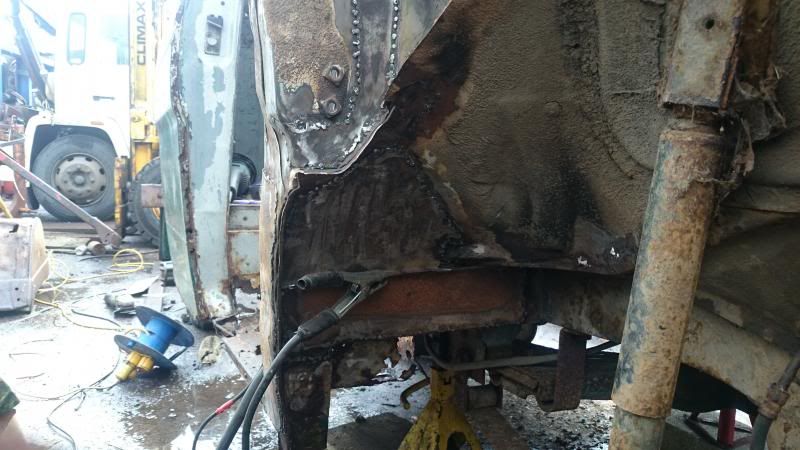

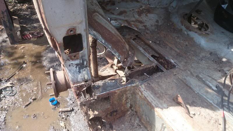

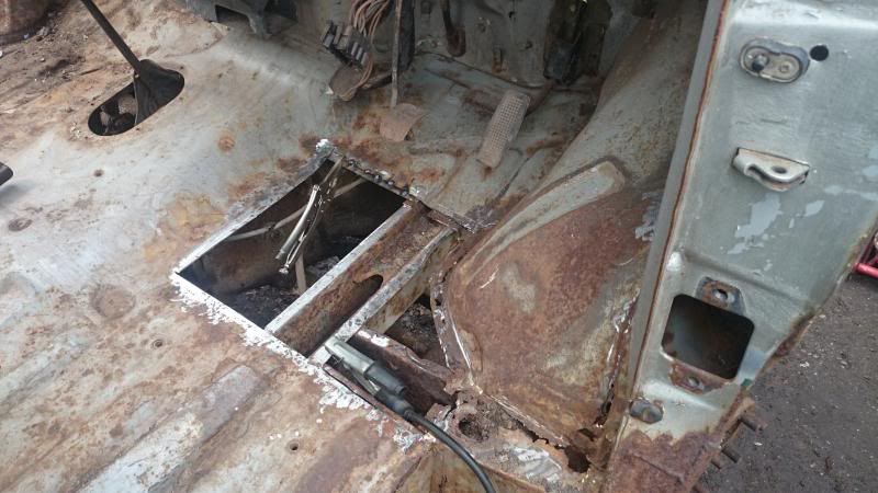

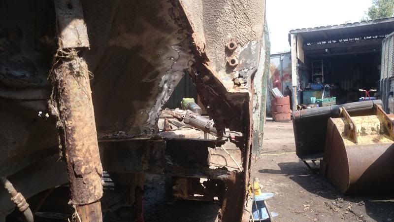

so today was cutting the floor out and the rotten metal i had to leave so metal for shaping purposes but did grind back to clean metal before hand
so here goes
this
to this

Actually it don't look as bad as I was expecting after seeing the rear chassis :shock: but the floor and the chassis beneath it look quite solid (at least what we can see does)
Stick with it young Karl it'll be a good'n when its done :!: :)

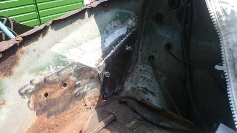

i done some more today welding the inner arches up manage to do it in two plates so weather was hot :lol: so left welding and the sun dont mix :lol:
pictures to follow :D

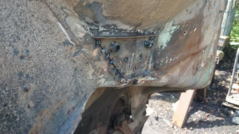

pictures as promised 8)
even folded the centre for strength

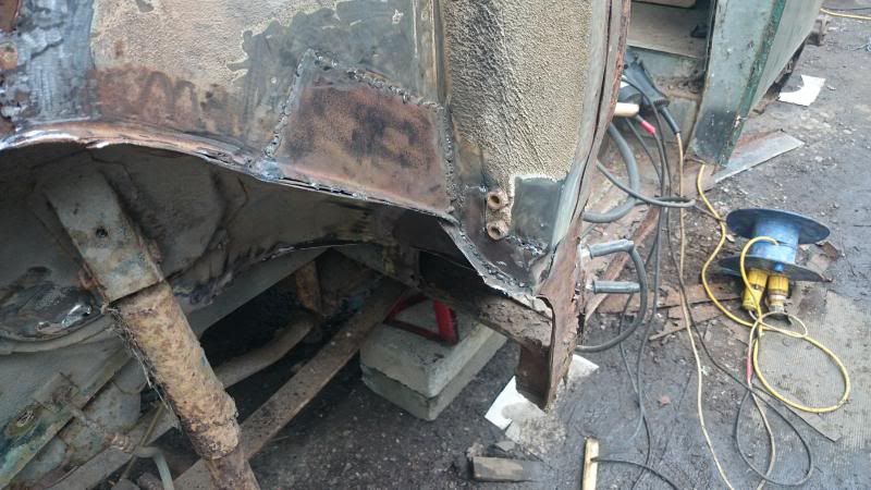

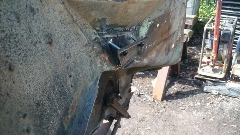

then today was patching the inner wing then fabricating/ making the bonnet hing mount (1side) which iam very chuffed about as never done anything like this before an id turned out great :D :D
paching
bonnet hing 8)
then started the other side as i need sills steps etc to finish the sides of then they will be done :D

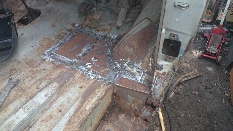

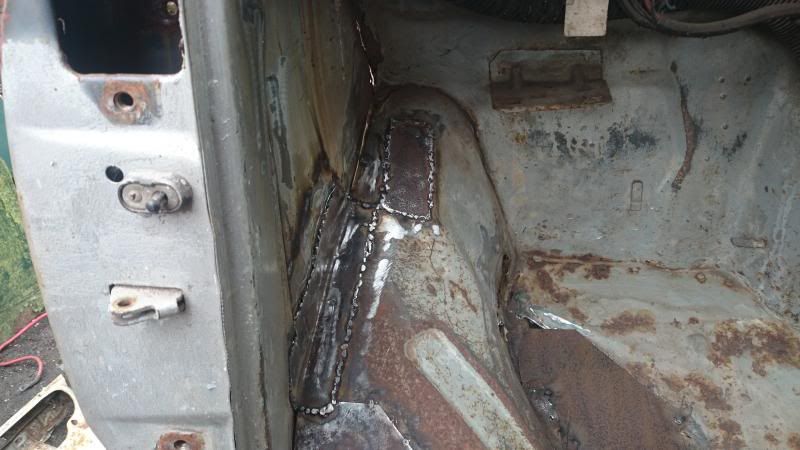

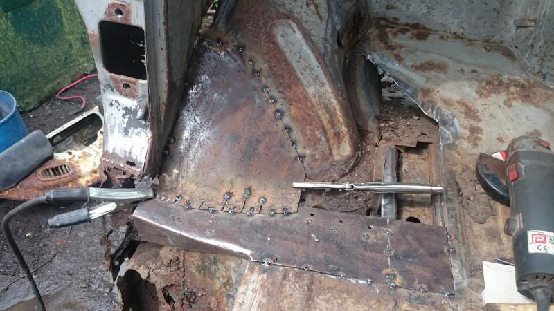

her are the pictures 8)
spot welded
new water channel inplace
inside top done
i have replaced the floor what ive cut out but no picture as i forgot :(
