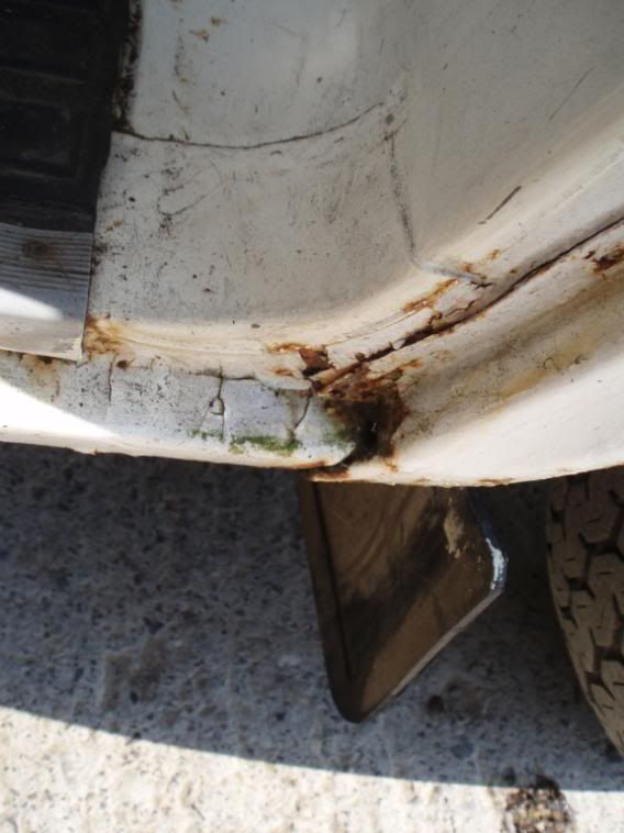

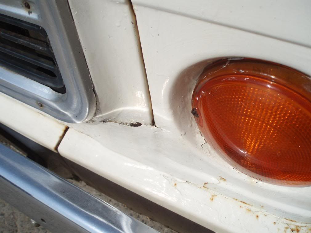

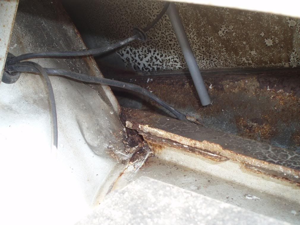

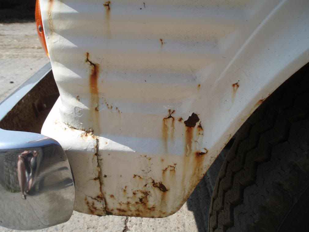

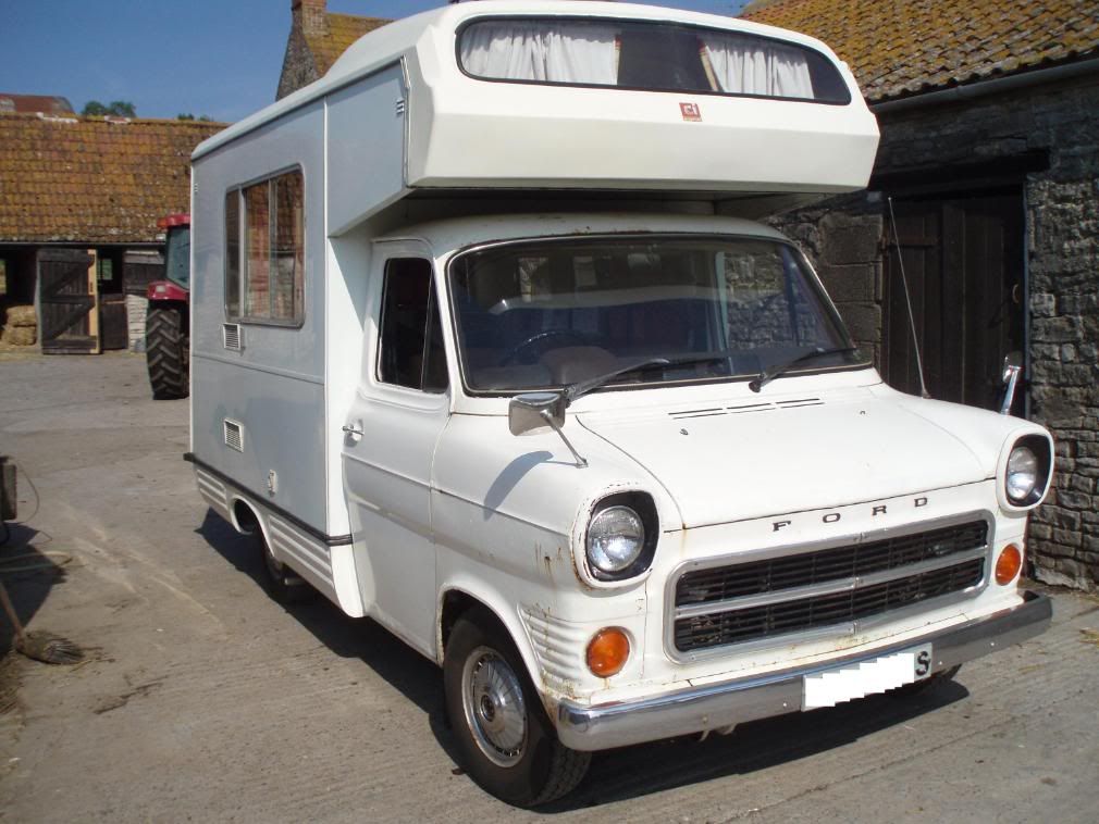

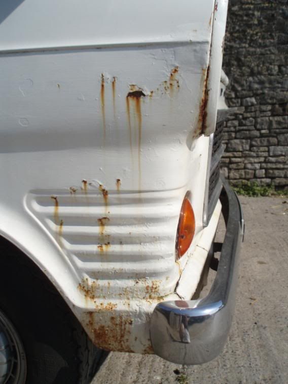

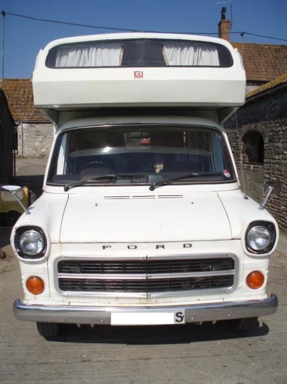

So I thought I'd post up some 'before' pictures taken yesterday.
It dosn't look too bad after a wash in the sunlight, but the close-ups show the true extent of the rust / filler and paintwork which looks like household gloss applied by brush ! !
It'll look awesome once everything has been replaced and resprayed though. Updates when work begins (hopefully next week).
Wish me luck :lol: :roll:

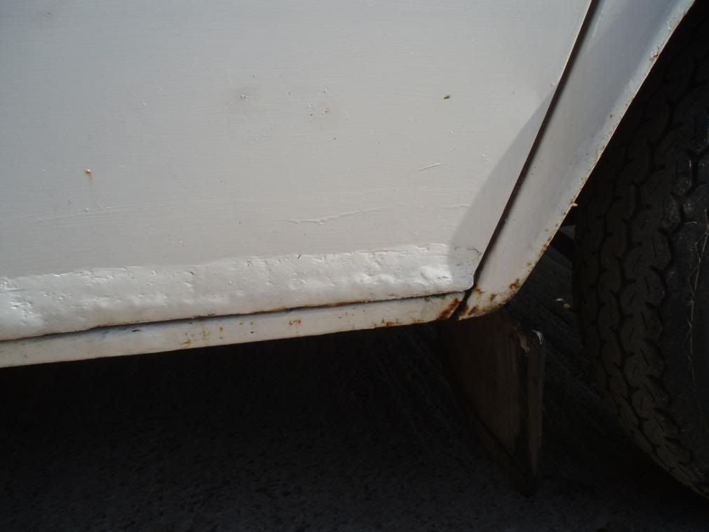

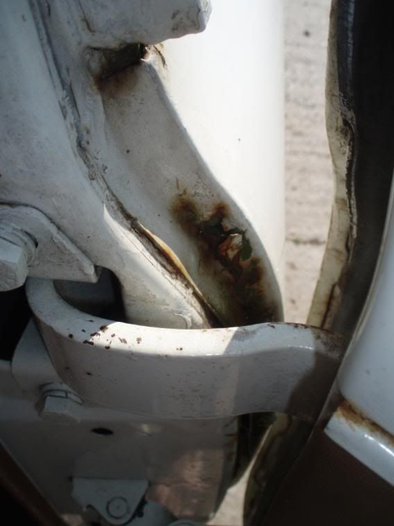

What's under this filler on the door?

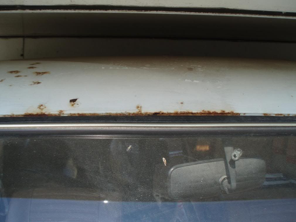

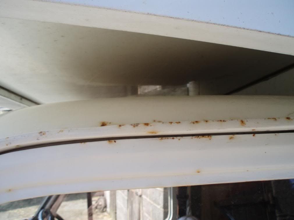

Rusty screen edge and cab roof.

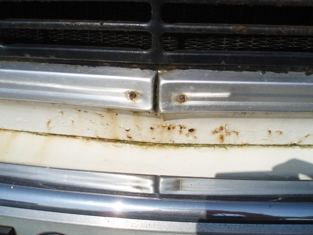

More filler courtesy of the previous owner.

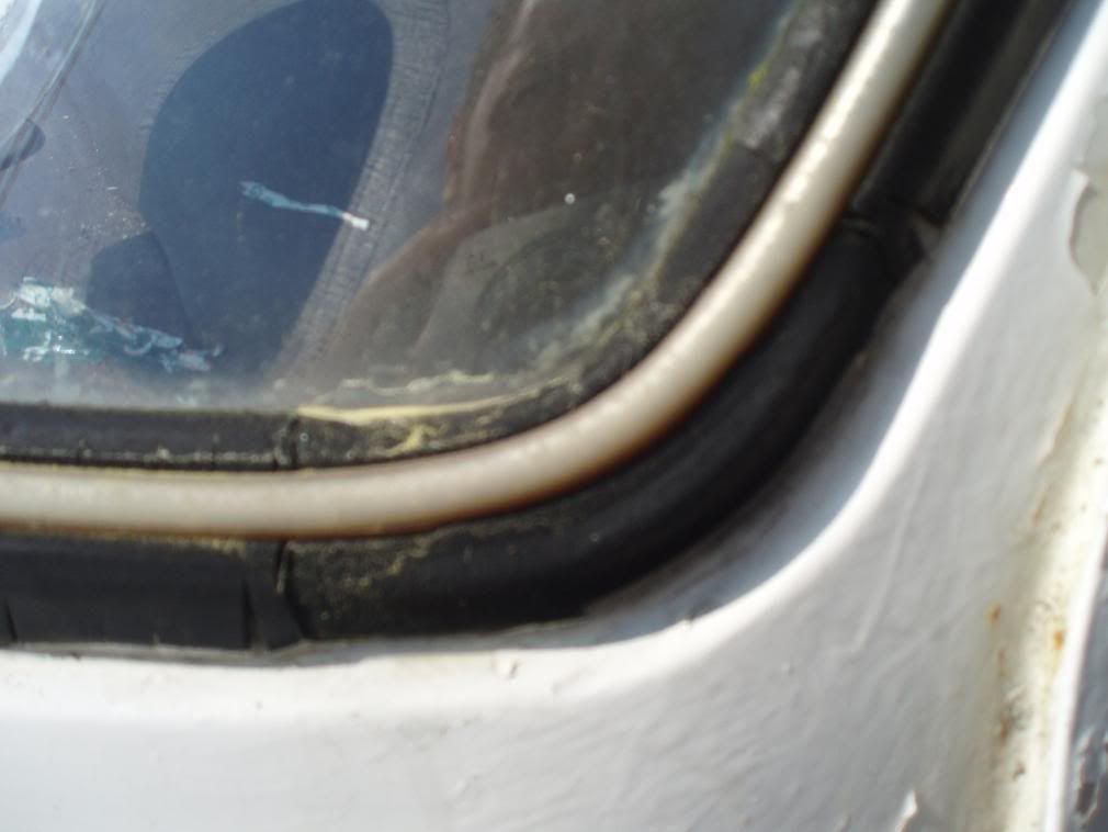

Knackered screen rubber seal.

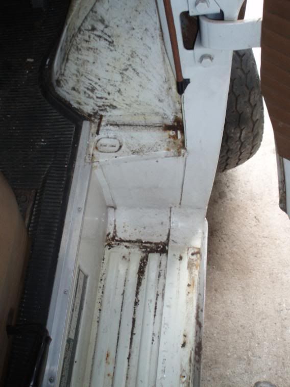

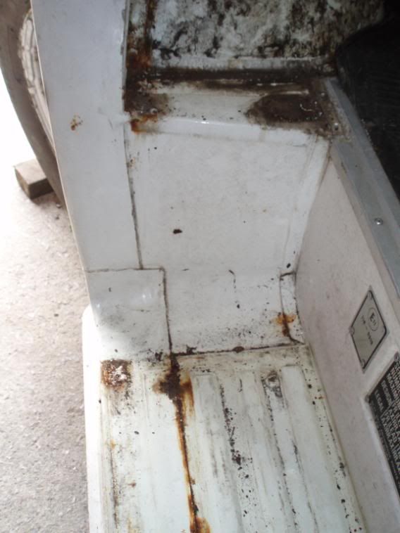

Think the steps have avoided the rust and appear solid... we'll see ! !

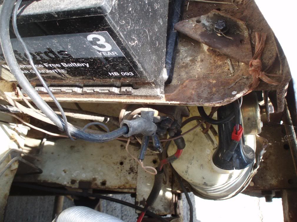

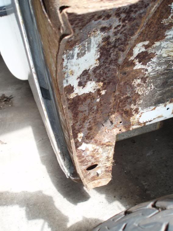

Inner Wing
Battery tray.
Other wing.

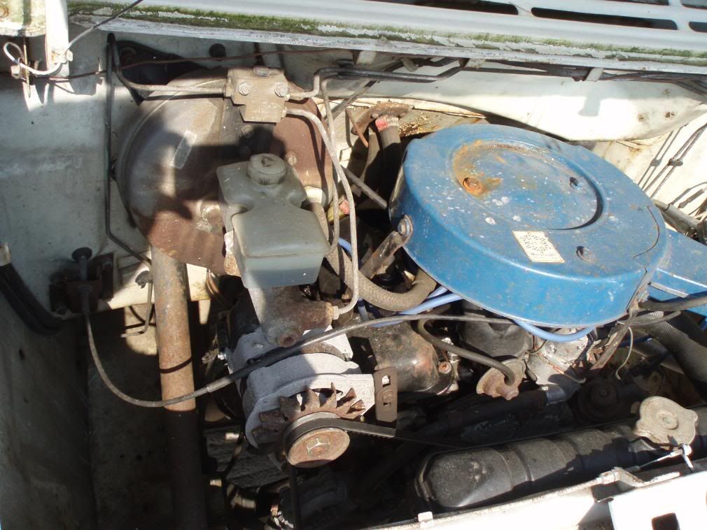

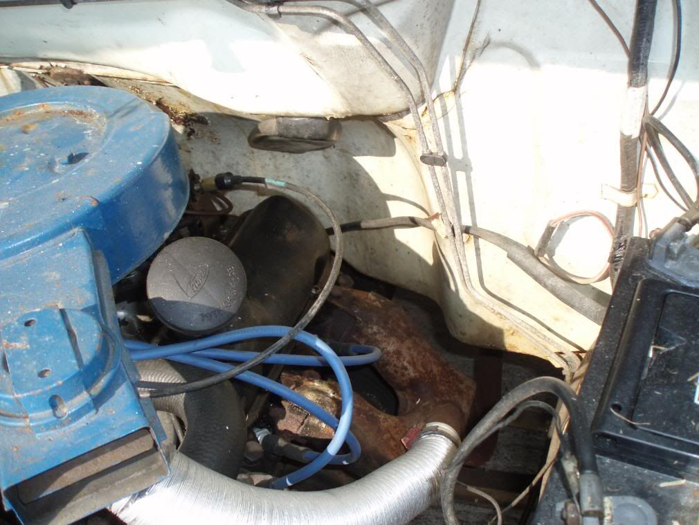

The mighty V4. With 22k under it's belt, I think it'll be worth converting to unleaded, strip down, re-paint and generally tarting up the engine bay.

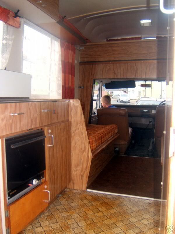

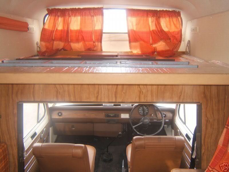

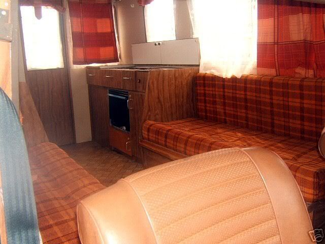

A few 'before' pictrues of the interior.
Can't really see in the pics but the two cab seats are in perfect condition, along with the rubber floor mat, but I am going to change the curtains, camper bed/seat covers and floor covering...
The small child isn't mine ! ! These were piccies taken by the previous owner !
Also - should there have been a table between the two sofa seats when it was new?

I know its a bit expensive, but I would seriously look at getting the cab and bay, bead or shot blasted, youve got surface rust everywhere :shock: at least your know what your looking at, then a nice coat of 2k. Nothing worst than doing all that work and rust breaking through

I know its a bit expensive, but I would seriously look at getting the cab and bay, bead or shot blasted, youve got surface rust everywhere at least your know what your looking at, then a nice coat of 2k. Nothing worst than doing all that work and rust breaking through
Yeah - tell me about it!
I've got new wings, bonnet and front panel to be fitted, so that'll sort most of the rust out.
I will get the inner wings, engine bay, doors and roof blasted back to the metal as well. I've a feeling it's going to be a 'budget buster' of a project but if I'm getting it done I may as well get it done properly.

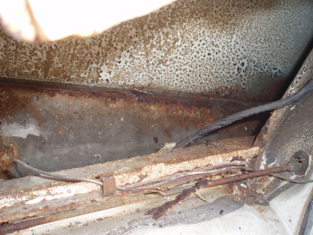

Postby MK1Chris » Sat Jun 21, 2008 6:19 pm

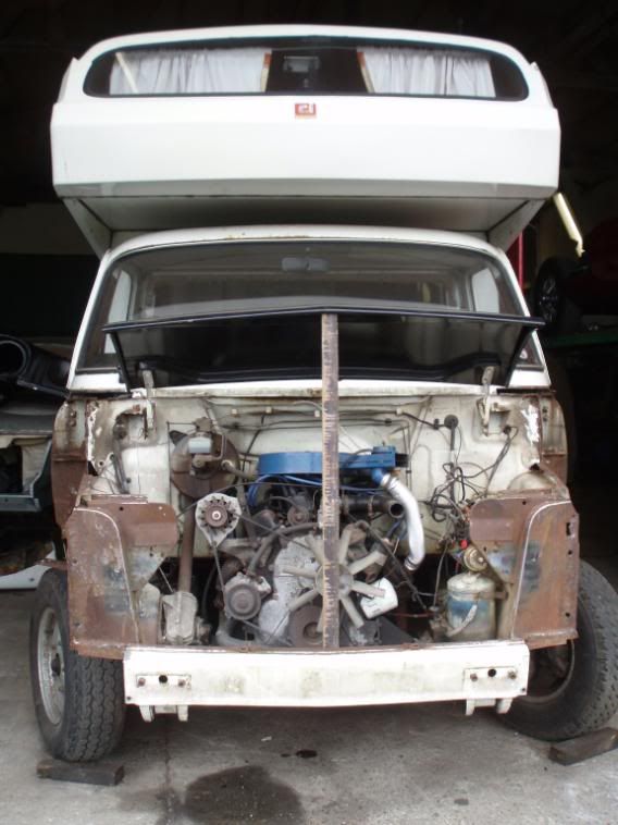

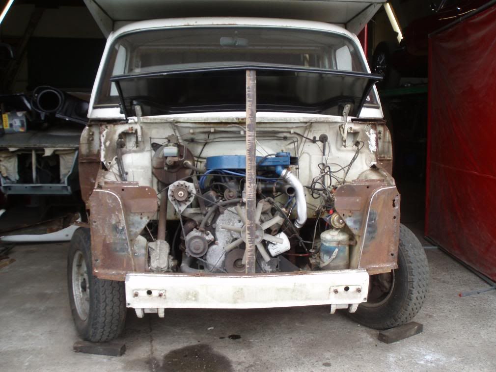

Right - time for an update...

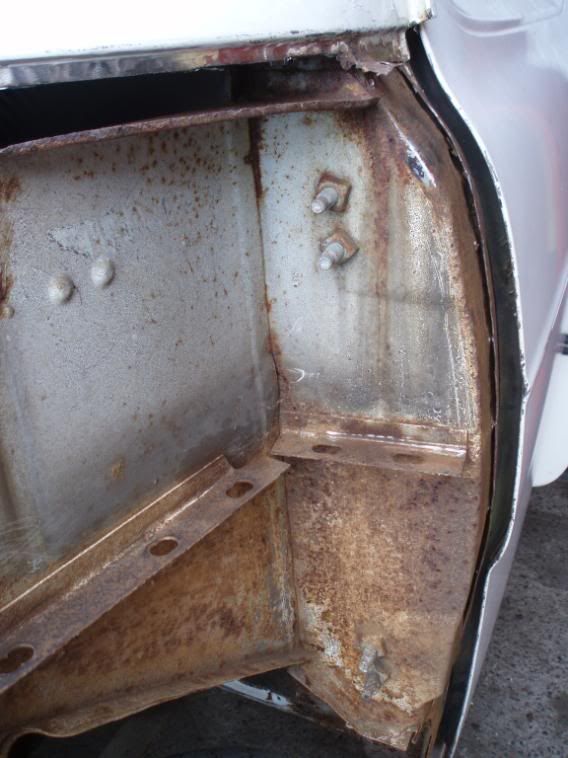

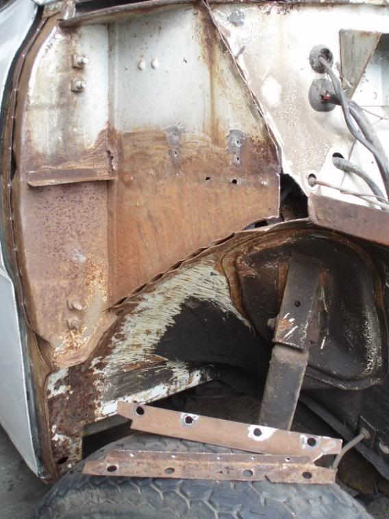

Wings and front panel are off so now we can see what it's really like underneath... and it's not too bad considering :shock:
Next step is engine and gearbox removal and clear out the engine bay ready for shot-blasting.
Front view:
Front with new bonnet:

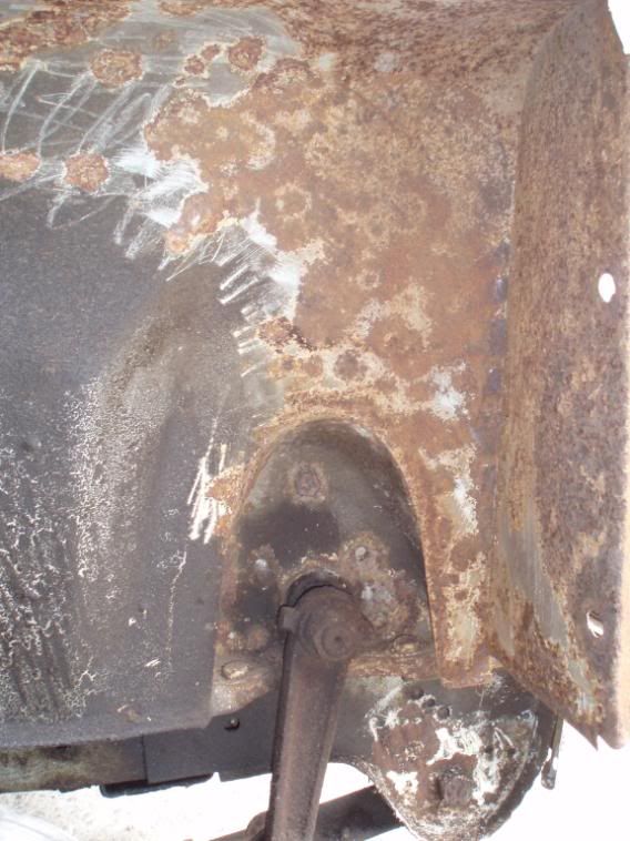

Driver-Side Inner Wing:

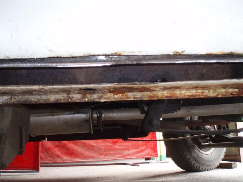

Drive-Side Sill:
Passenger-Side Inner Wing:
Passenger-Side Step and Wheelarch with mat and soundproofing removed (pretty clean):
Same on the driver-side:
There's still a long way to go and I'm pretty commited at this stage. When it gets like this, you can't just stop as you've basically just got a scap van !
Going to tart up the engine while it's out with a proper steam clean / degrease and then paint up the block. Anybody know what colours the V4 would have been painted in? I don't want black. Was thinking a similar blue to the air filter housing.
After taking off the wheel trims, I've realised that I have got 3 wheels which look like later (Mk2 wheels?) and one original MK1 wheel ! I'll have to drop the spare down to see what that is like as well :?
When the news wings are on, what does everybody recommend in the way of rust-proofing the the areas that get attacked with spray, mud and salt? Would you apply some sort of coating over the fresh paint, or just leave it painted and spend some time and effort in cleaning up under the wheelarches regularly?

Re: MK1 CI Camper Project
Postby rover » Sat Jun 21, 2008 7:50 pm
Ive seen much worse than that :D Are you blasting everything before welding and plates? or just the engine bay?
Dinitrol appears to be the best for rust proofing after painting.
Rover.

Postby MK1Chris » Sun Jun 22, 2008 11:32 am
Going to attack the whole cab - engine bay, inner wings, cab roof after taking the screen out (if we can get in the small gap) doors and step.
The rear is fine as it's made of ...aluminium?
I'll start on the chassais when I manage to get some axle stands up to the job!
