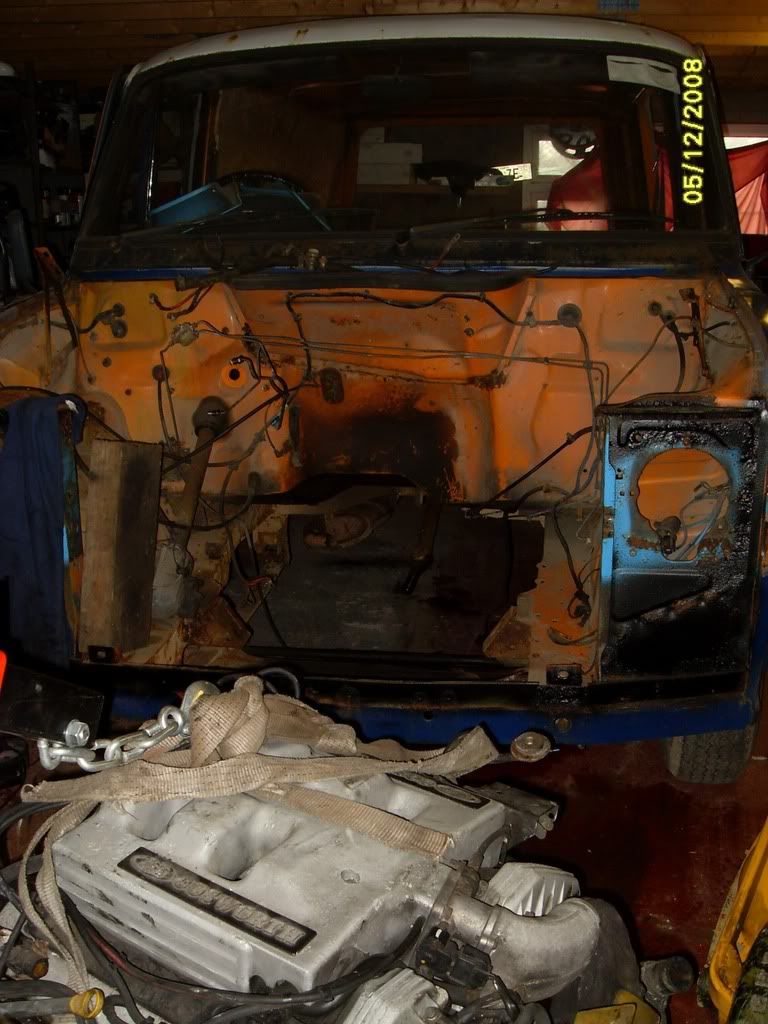

2.9 24v cosworth Transit Mk2 progress
Cosworth mk2 crew cab with IFS

Postby 24v » Fri Dec 05, 2008 6:21 pm
No have not done mounts yet.Any suggestions?
I was going to use the Granada rubber mounts and make brackets on the chassis to suit.(pictures at last)
Also I am going to make s/s manifolds.

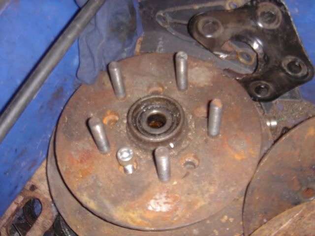

I was looking at the hub adaptors as i want 5x112 but my hub splits and has an extra row of bolts to hold the outer flange on. Will this make it difficult to make adaptors or can I redrill this flange to suit my pcd?

24v wrote:I was looking at the hub adaptors as i want 5x112 but my hub splits and has an extra row of bolts to hold the outer flange on. Will this make it difficult to make adaptors or can I redrill this flange to suit my pcd?
with mk1/2 it's easy just unbolt the hub split it from the disk take out all the bearings and take it to a machine shop ask for 5 holes at 1/2" dia 112mm pcd and counterbored 20mm dia 5 mm deep from the back
then have the 5 holes that hold the disk on counter bored aswell replace the disk retaining bolts with 5 M10x30 allen cap head bolts
you'll need to but 5 new studs (each side) - get them from rally design about £1.50 each
it should look like the pic i'm about to post - except ive welded up the old holes - you dont need to do that if you dont want :D

pic of a mk1/2 hub redrilled 112x5
oh forgot you'll also need a boss adapter that fits over the centre boss and enlarges it to the centre bore of whatever wheel you have (112's are all different) :D
