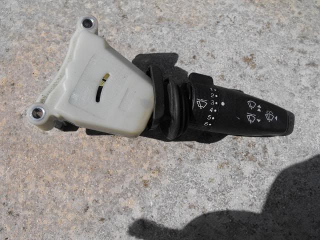

Got hold of a mk2 Mondeo wiper stalk some time ago, mainly for when I acquire some glazed rear doors, this has the little wheel with 1 to 6 on it, to vary the wipe interval timing. However, the wiring on the Mondeo is different, these use a module rather than the old type red delay relay.

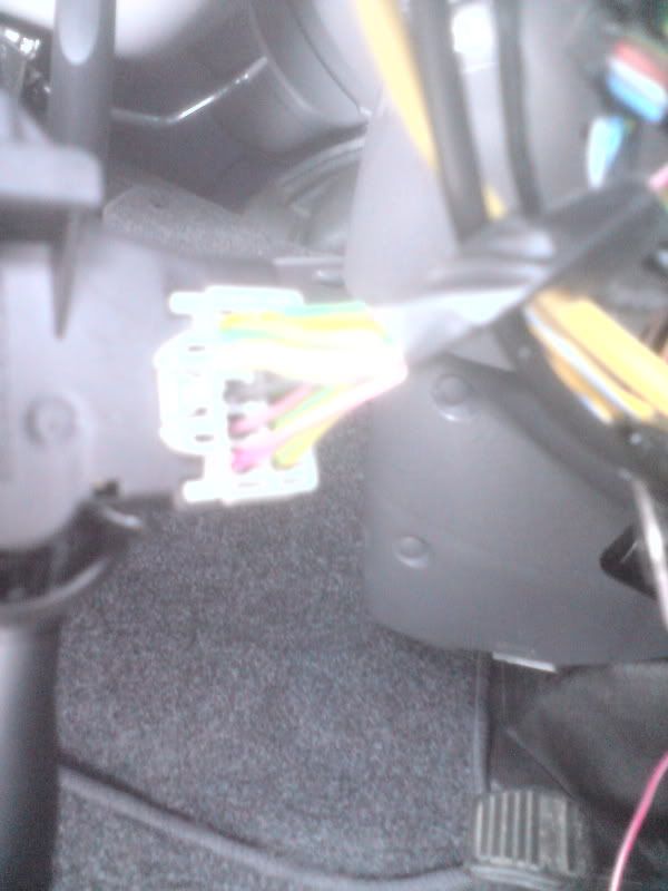

This is the first addition (bodge?) to the wiring of my mk6 so far. It only needs one wire, running from the only spare pin (no.1) on the wiper stalk to the fusebox (CJB).
Stalk multiplug with new wire in place...

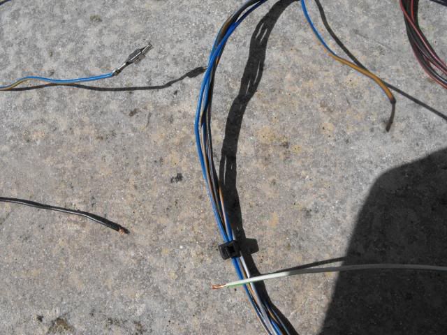

I stripped an old piece of FWD engine comp. loom down to get a good length of red/white wire of the correct gauge, with a suitable pin connector to fit the stalk multiplug. Routed it roughly for the time, will need taping into the main loom at some point to disguise the fact it's a bodge-up, but this will require the dash out. :( Next I crimped a spade terminal to the other end, and inserted this into the spare (empty) connection in the CJB for the delay relay. The standard Transit relay is the 4 pin type, which needs changing for the 5 pin type, from, i.e a Mk2 / 3 Granada.

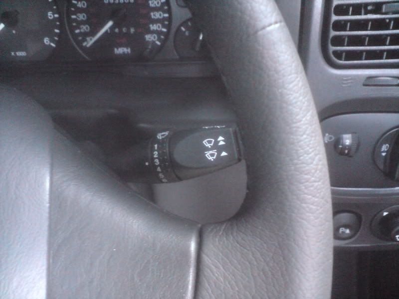

New stalk fitted 8)
Delay can now be altered to any of the six settings on the stalk, ranging from approx. 3.5 seconds on position 1, 6 seconds on position 2, up to 24 seconds on no.6.
I think setting 1 should be giving a shorter delay than 3.5 seconds, as this seems pretty close to the standard interval of around 5 or 6 seconds, but without modifying the relay (if it's possible) there's not a lot that can be done about that, except to play about with a Mondeo wiper control module.

Postby madmark » Mon Apr 06, 2009 11:11 am
:shock: are you just showing off a leather steering wheel there? :shock: :shock: :shock: :shock: :lol: :lol: :lol: :lol:

ake wrote:Stripping old looms to get the right colour of wire - Superb - a man after my own heart :lol:
Not sure it should be red... :oops: looking at the wiring standard colour codes, I think the main colour ought to be orange, with white tracer, but didn't have one that colour, and it's not readily detectable as a bodge. On the Mondeo, this wire is white... :?
madmark wrote::shock: are you just showing off a leather steering wheel there? :shock: :shock: :shock: :shock: :lol: :lol: :lol: :lol:
Ohhhh yes! 8) 8) 8) 8) 8) 8) 8) 8) 8) 8) 8) 8) 8) 8) 8) 8) 8) 8) 8) 8) 8)

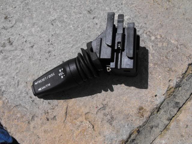

Does the radio control stalk have its own wiring loom, i.e separate from the main wiring? The 7000 (and I think 6000 also) has the socket for this between the two black plugs on the back.
Have you got any spare.... :P

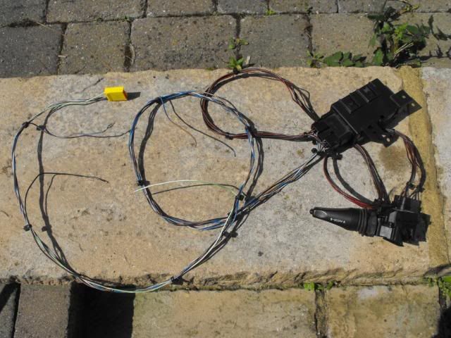

Postby Terry » Sat May 02, 2009 12:03 pm
Hi 100T280
I don't know what a Mondeo wiper stalk looks like ,here is a Scorpio one.
Yes the radio remote does have its own little loom & box,
I have a 6006e in the van & there is provision for the yellow plug from the remote.
When I removed it I had two wires I had to cut & two I don't know where they go
The blue with orange tracer & black went off to the radio,(left side in pic) the other blue with orange tracer & white with green tracer went off behind a monster loom behind the speedo.
When you ask do I have another, I guess you mean radio remote ? Yes, but with no wiring at all.
(I have an 'almost' complete '97 Scorpio estate as my spares supply for my 98 Scorpio Estate)

Postby 100 T280 » Sat May 02, 2009 2:18 pm
Terry wrote:Image
Stalk looks very similar, but mounting is totally different.
