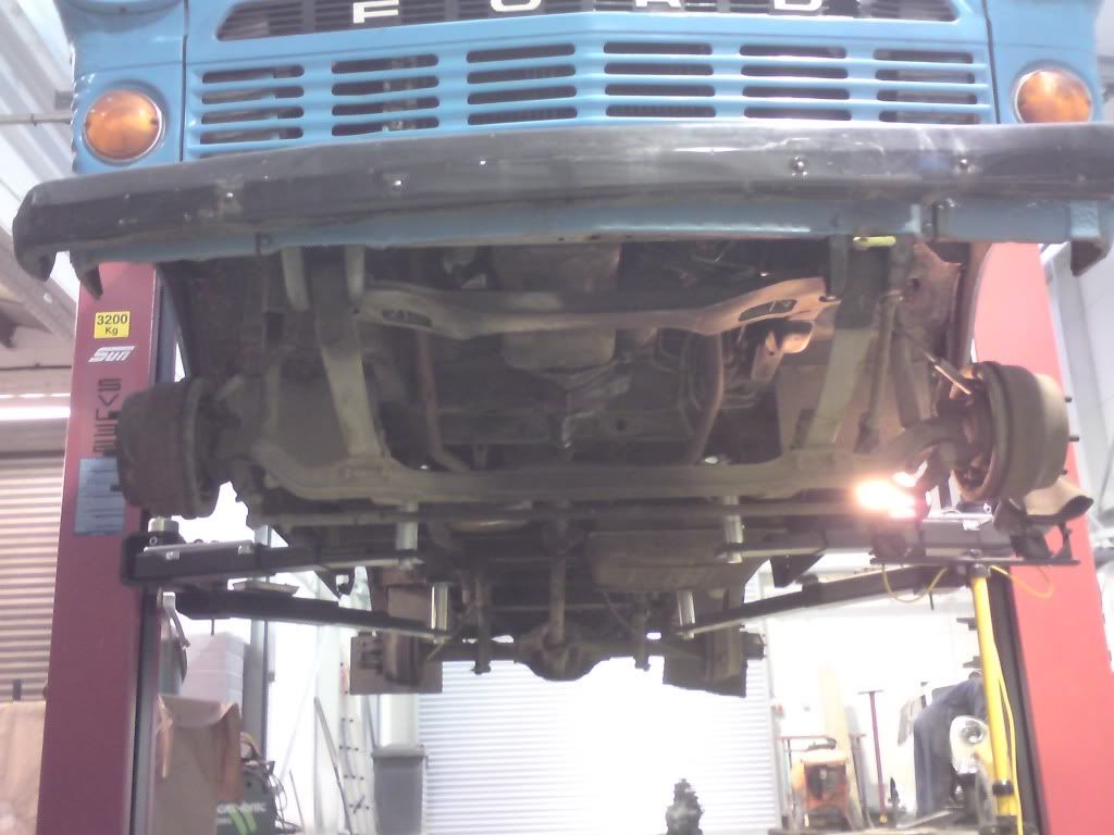

Postby Vandalism » Fri Apr 01, 2011 2:05 pm
madmark wrote:as wether it will fit or not is a good question ,the good think about the german vans is they dont normaly have the gearbox mount with the bolt hole they use a x member ,and also the front engine mounts go to the chassis instead of the cradle that holds the mounts!
so what have you both got?
if you mean what mounts have i got im not sure, can you tell from this pic?
Posts: 5012
Re: thinking of changing engine and box on my ex german fire
Postby madmark » Fri Apr 01, 2011 2:23 pm
the engine has a cradle that hold its up with the engine mounts to it :wink:
i cant see from the pick if it has a x member or a big bolt type gearbox mount!
myself if your engine is a good runner i would keep it ,the cost of going to essex is alot ,you can get your gearbox done cheap as it wont be much wrong with it :wink:
fit the 4.63 axle and you will be ok
if you take the rad fan off keep the belt fairly slack and fit electric fan then your engine should last ! :wink: :wink:
i found for some reason the german engine ran at 62mph with the 4.63 but the essex out of overdrive revs bad at 55mph :roll: :roll:
so fitting a 4.63 will give you a nice 55mph thats all you need :wink: :wink:
