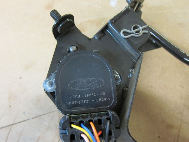

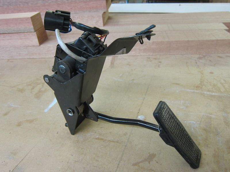

Postby joinerman » Tue Apr 21, 2015 6:53 pm
Here you go Modman
If any good to you message me.

Postby MinorMatt » Tue Apr 21, 2015 7:48 pm
Thats the late mk5 type and should be whats fitted to modmans transit
