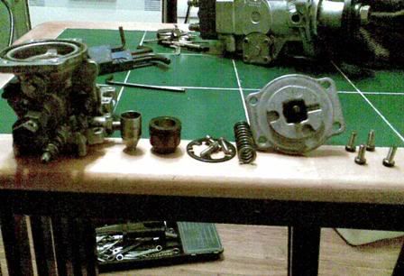

Yep like Frag says torque piston sticking in the sleeve is the favourite for a bosch pump.
The piston is second, the sleeve third from left.

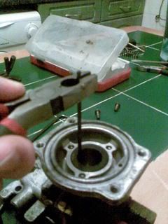

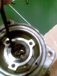

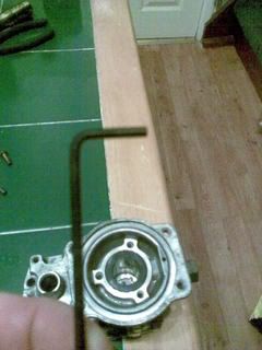

Postby alanwh » Tue Feb 24, 2009 8:31 pm
Excellent mate, thanks for letting us know. :D
Did you polish up the piston and bore or replace ?
Just dug out some pics to help. know its a little late now, but may help anyone reading this at a later stage :D
Right size Allen key :!:
pop it into the bore, shank perpendicular :!:
A tug and its out :D
