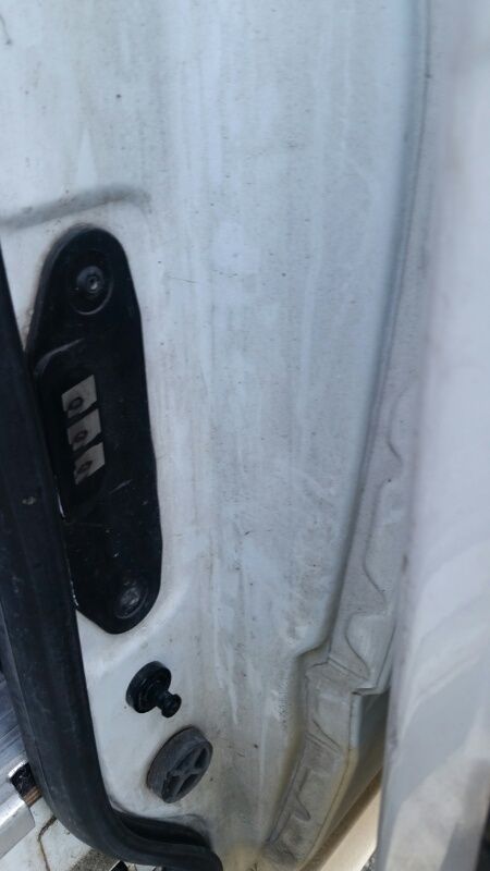

Postby MikeHamling » Sat Apr 02, 2016 1:29 pm
loot wrote:Quick test, find pin 6 and pin 8 and bridge them then try locking the doors, the rest should stay locked.
Pins should be numbered on 1 of the connectors
Frustratingly only numbered on one of the connectors behind light but no pin 8. The black connector in the door has no numbers

Postby MikeHamling » Sat Apr 02, 2016 1:57 pm
Ignore my idiocy of the last post. They are numbered, I just did a "man look" as my wife called it. When I did a "woman look" I found the numbers, bridged 6 & 8 and all the other doors stay locked as you say
