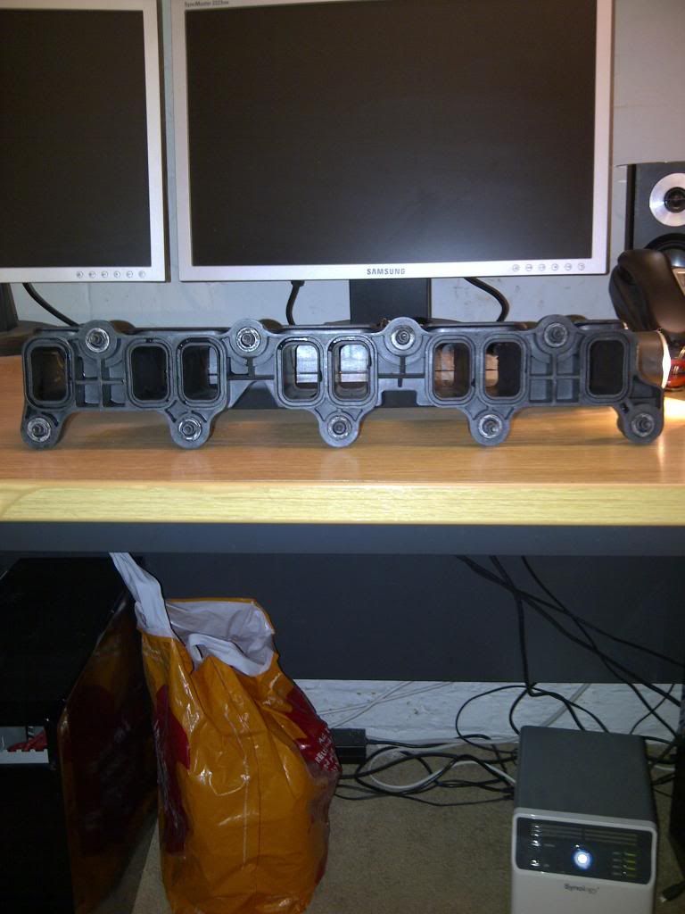

Anyhows, i thought I would post up some picks of my EGR clean up, there free to use so if Admin wants to bung them in with the other and Better EGR thread/howto then thats cool 8).

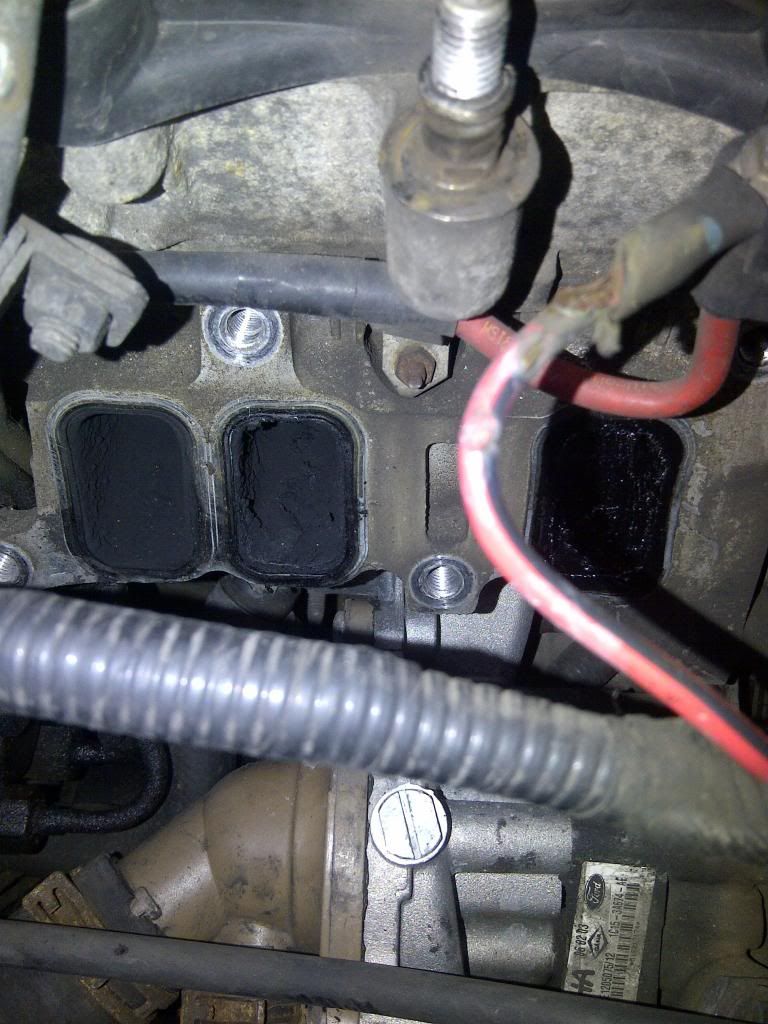

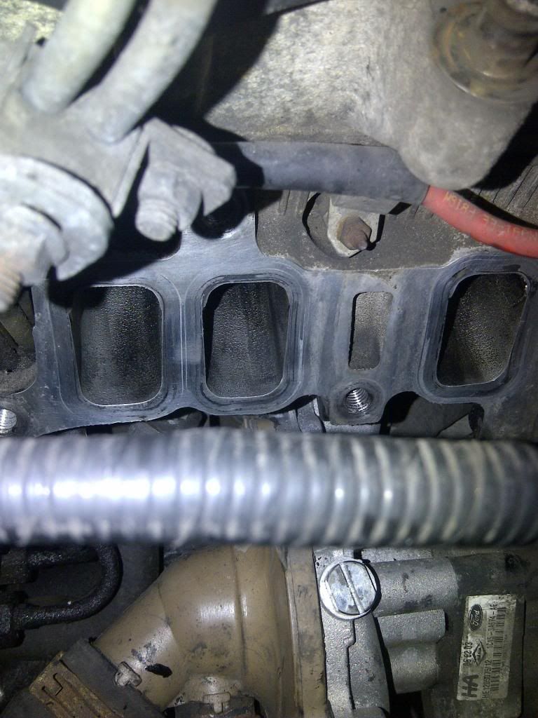

I did notice I had and oiley inlet on the head on No 4, but also noticed a bit of oil resting in the EGR to Main inlet on the manifold pipe. Dunno if this is leaky oil from turbo or leaking valve seal on No 4 or thats just how the stuff hits the fan, with a twisty turny air flow in the mainfold.

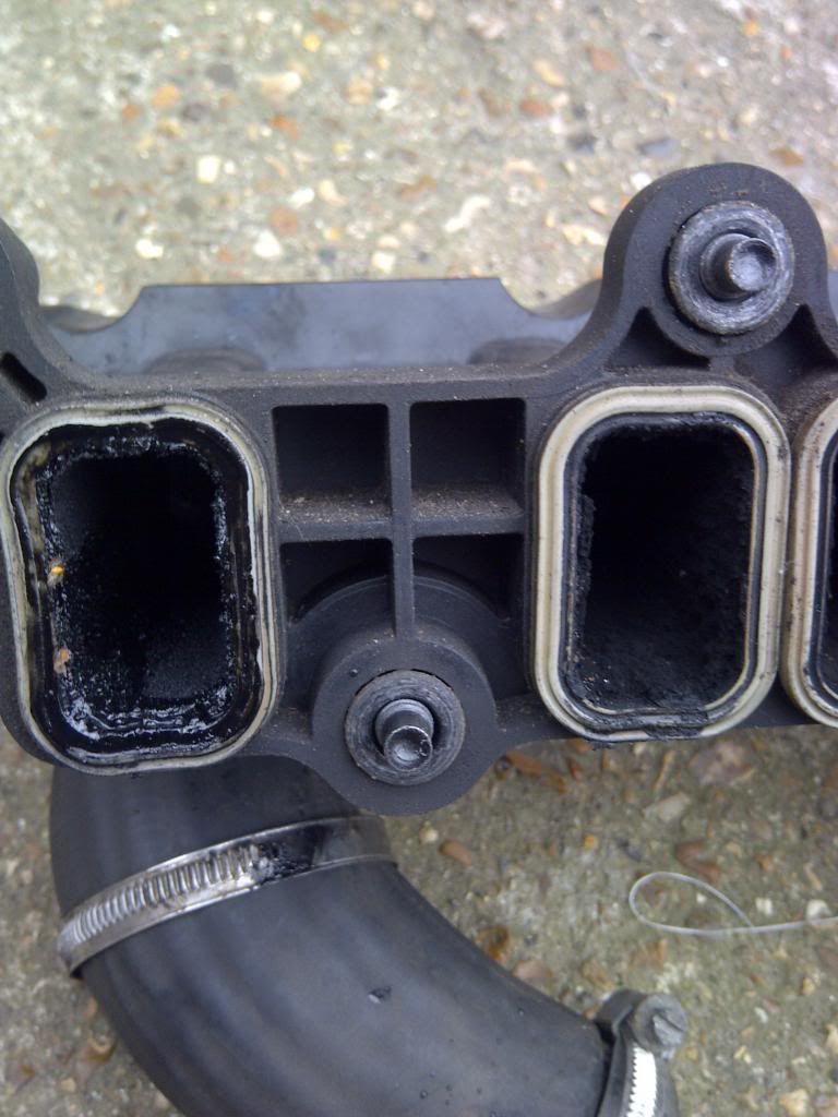

Before and afters.
INLET ON HEAD......................
BEFORE
AFTER

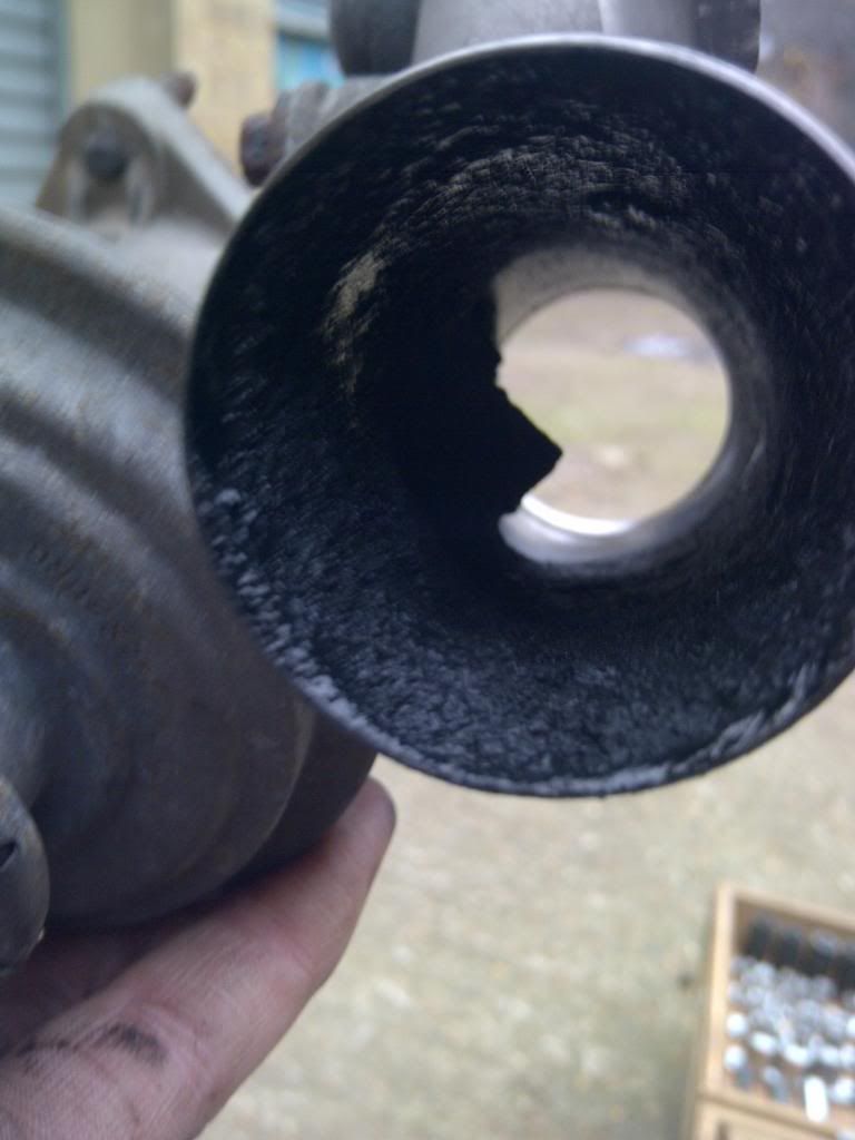

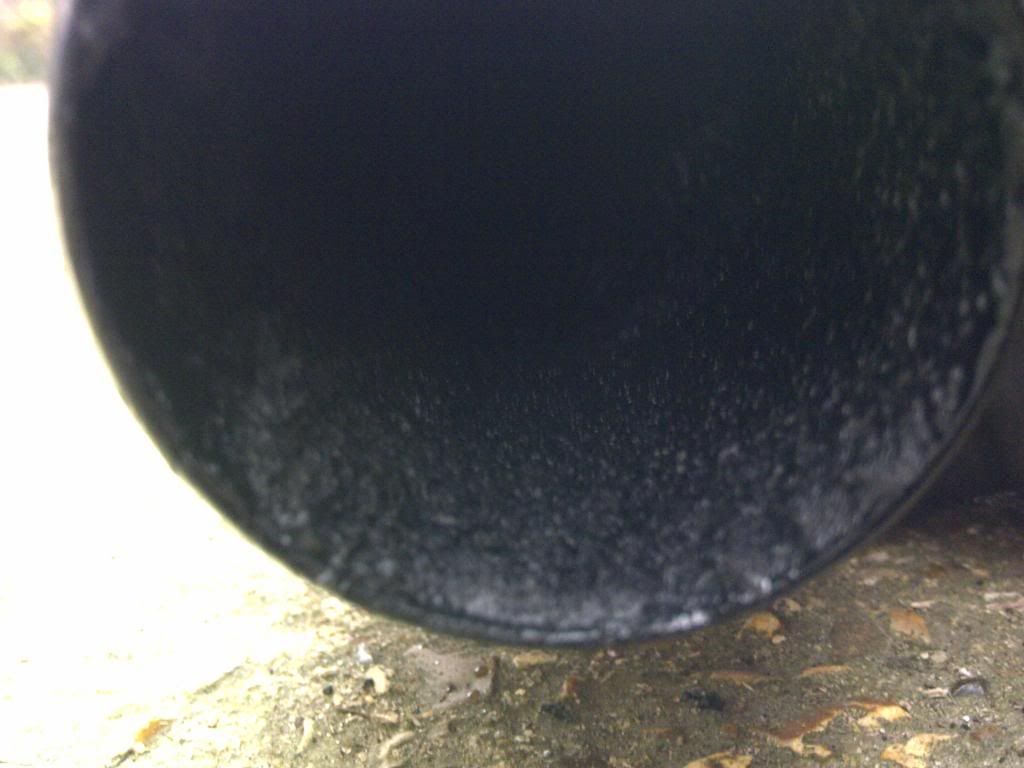

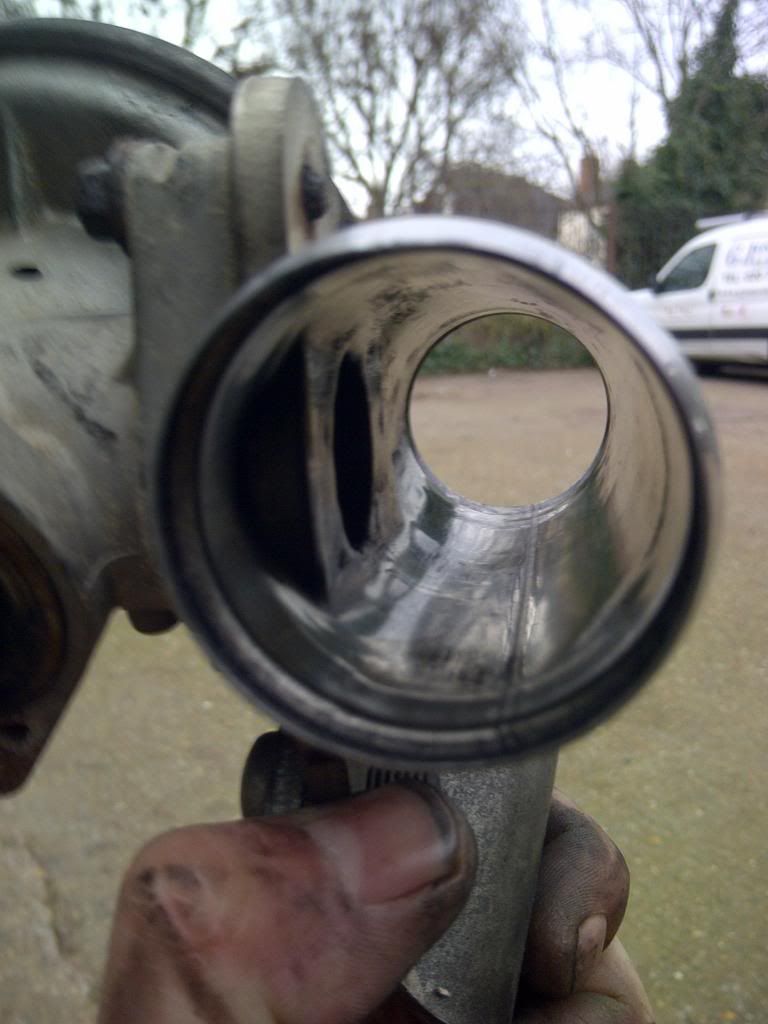

INLET SIDE OF MANIFOLD..................
BEFORE
AFTER ( YELLOW SPECS ARE SAND FROM JET WASHING IN THE CAR PARK, GOOD OLD RINSE DONE AFTER!!!)

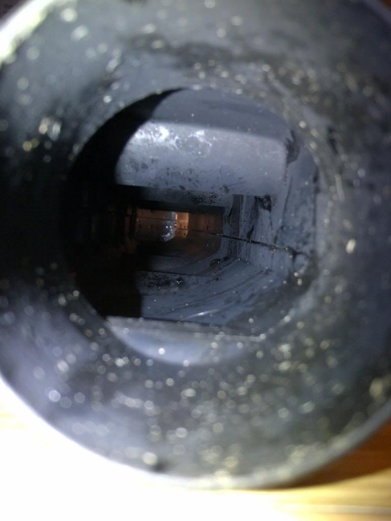

INLET MANIFOLD ..........................
BEFORE
WHEN SHE WAS OUT

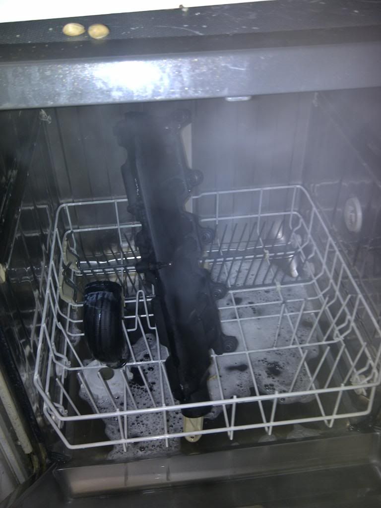

AFTER AT The OFFICE BEFORE (BASIC BOG BRUSH CLEAN WITH WHITE SPIRIT, 4-5 DISH WASHS, JET WASH)
EGR ...............
BEFORE
AFTER
All the sillicone gaskets went in the dish washer and sprung back like new, so re used them. theres not a the tiniest hiss or bubble after i soaped it up, the manifold that is, not the horse scarer.

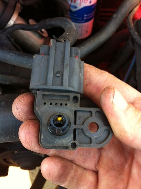

Postby blue estate » Sat Dec 08, 2012 1:09 pm
This is my MAP sensor 5 months 22k after the egr delete,as you can see it's a little oily but that's it :D no crap on it and no fault codes :D

[quote="blue estate"]This is my MAP sensor 5 months 22k after the egr delete,as you can see it's a little oily but that's it :D no crap on it and no fault codes :D
your a MK7 Blue estate, what type of blank you got? I thought MK7 had to have a hole in the blank off so the computer didn't get confuseed?? my mk6 75ps dura hasn't got a MAP sensor on what I took off for cleaning, maybe thats the reason for funny mk7 blanks probs.
