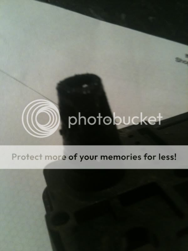

Postby squirkane2010 » Sat Jan 21, 2012 2:28 pm
Just thought i'd post these pictures as a indication as to what a map sensor can look like after only 27000 miles!
Van starting hunting yesterday and was down on power so thought i would strip out the sensor and have a look!
The van is only a 60 plate too!
So it may be worth checking yours!
And it was only serviced 7000 miles ago!!!

Postby squirkane2010 » Sun Jan 22, 2012 6:08 pm
Yes it did van now sitting at a steady 800 rpm
Will make it a quarterly check

Postby herman0786 » Sun Jan 29, 2012 5:16 pm
Is there anything special needed to clean map sensor?,what kind of dirt is on it ?and do you have to be a mechanic to do this, cheers
herman0786
Posts: 11
Joined: Sun Nov 27, 2011 11:45 pm
Location: co. tyrone N. Ireland
Re: MK7 Map Sensor!
Postby fedup2 » Sun Jan 29, 2012 5:30 pm
herman0786 wrote:Is there anything special needed to clean map sensor?,what kind of dirt is on it ?and do you have to be a mechanic to do this, cheers
petrol,oily crud,no its one torx screw.

Postby boltondigger » Sun Jan 29, 2012 5:31 pm
Cleaned mine with a paint brush n petrol.
Was spotless when done didnt make any difference to hunting though,
Had a rusty old 58 plate 85 ps swb.180 thou .most reliable bus ive ever had

Postby Mike » Sun Jan 29, 2012 5:32 pm
Mike Spence wrote:15k miles 140 fwd :o
T25 torx

Postby nigel green » Sun Jan 29, 2012 6:37 pm
If you require a new map sensor, from fords the complete housing that the map sensor sits in is cheaper by over £10, (includes map sensor) than the sensor on is own, and you get free screw too!!!!

Postby psv-hgv-flt » Sun Jan 29, 2012 8:41 pm
clean all mine with thinners and paint brush. that looks like it is down too bad EGR desine.

Postby squirkane2010 » Sun Jan 29, 2012 10:12 pm
Have cleaned the other 2 vans this week
And found a toothbrush and a toothpick seem to
Work best (just don't use them to clean your teeth afterwards!
