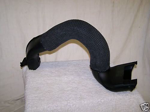

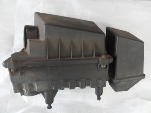

hi all, im going to do the airbox mod on my van
ive searched and theres so many posts its a bit misleading
am i right with the following
1999- 2004 airbox
coupled with this "snorkel"
my main question is
does the snorkel come on all focus models? or just the 170?
hope someone can clear this up then i can get done the scrapyard
cheers

The st170 one will be a different shape hole in the box and has a wider opening on the snorkel. If you find an st170 then get the whole thing as the snorkel from the st will not fit the airbox from a different model focus.

As long as it's from a 1998 R reg to 2005 05 reg mk1/1.5 focus (1.8/2.0l pet 1.8 diesel either) it will be the same
