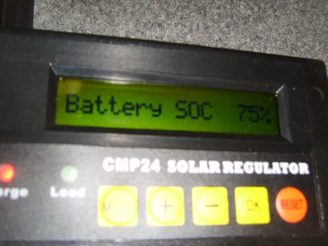

Postby solarman » Mon May 02, 2011 12:21 pm

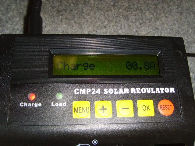

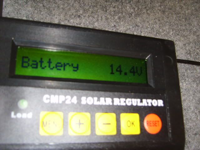

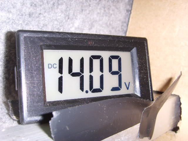

Was up early this morning to measure the panels charging output,sun was out but still cloudy..these readings were taken abot 7.30
while the sun was still at low angle and just clearing house roofs,so i expected a low reading.

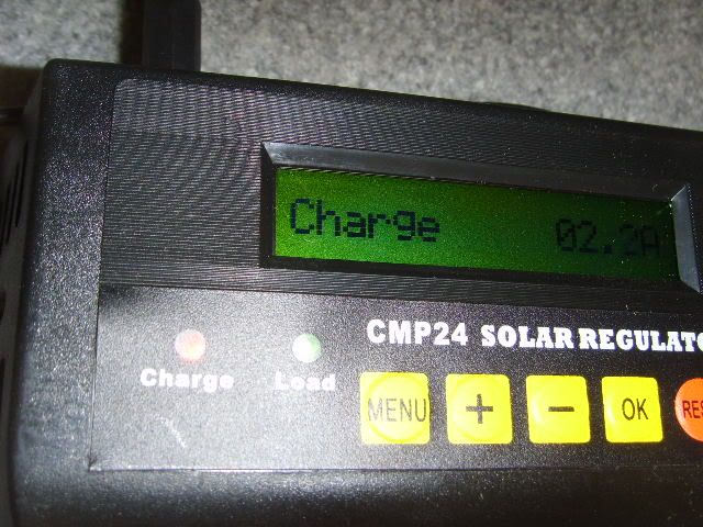

A couple of hours later sun higher but still cloudy on and off and these are the readings now....

Postby dachre » Mon May 02, 2011 7:56 pm
That works great. Very useful bit of kit to have.
And it fits on your van roof perfect too. :D

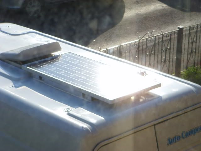

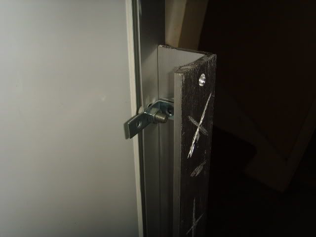

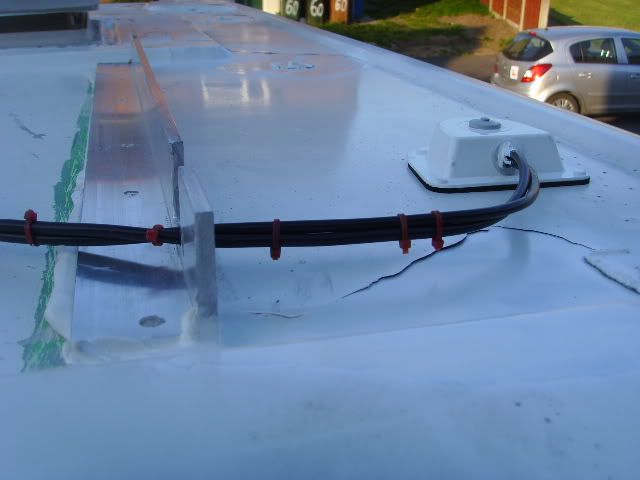

Postby Graham-sEY » Sat Oct 22, 2011 11:05 am

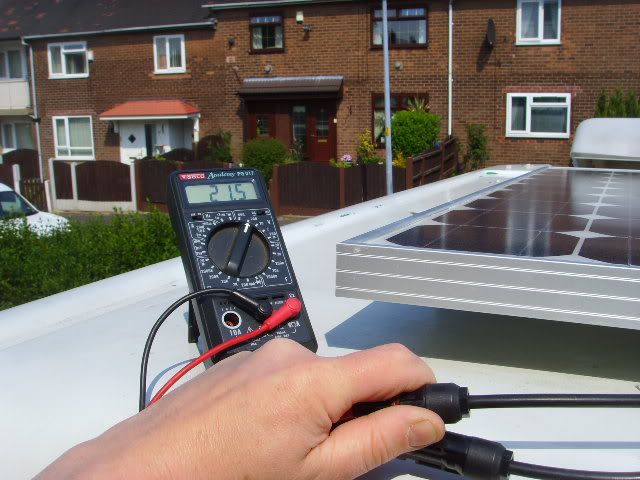

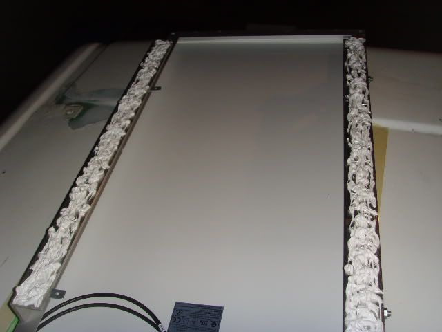

solarman wrote:Well after a break and a few more camper trips to Wales,i finally managed to fit the solar panel to the roof,it was a fiddly job
and at times it was windy up there,but it had to be done while the weather was dry!I used Tigerseal on the brackets and haven't screwed or bolted it down yet(still an option for later as i haave predrilled some screw holes in advance)Cleaned the roof where it was to be in contact with the brackets and scratched both surfaces to give a key for the sealant and put plenty on,Had to mofify the bracket with some square cutouts where the mounts are bolted for finger access behind the bolt and nuts as i wouldn't have any way of getting to them after once it was mounted.Drilled through roof for cable access and put a cable gland for weatherproofing and securing the cable against movement and finally connected it all up,Tested with a multimeter before final fixing,but now sun has gone down so will have to check charging tommorrow daytime.
Here's some pics for you....
Have been on the motorway with it today driving up to 60mph and so far it's solid,will take some pics of solar charger
showing charging readings tommorrow,
Solarman.

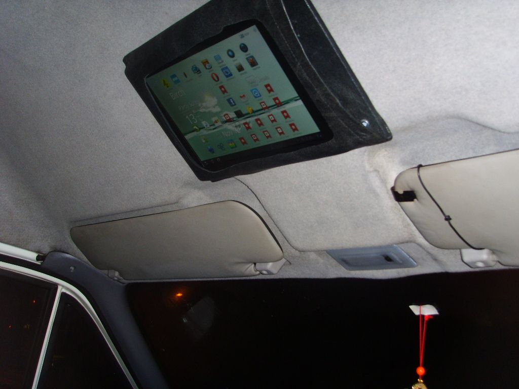

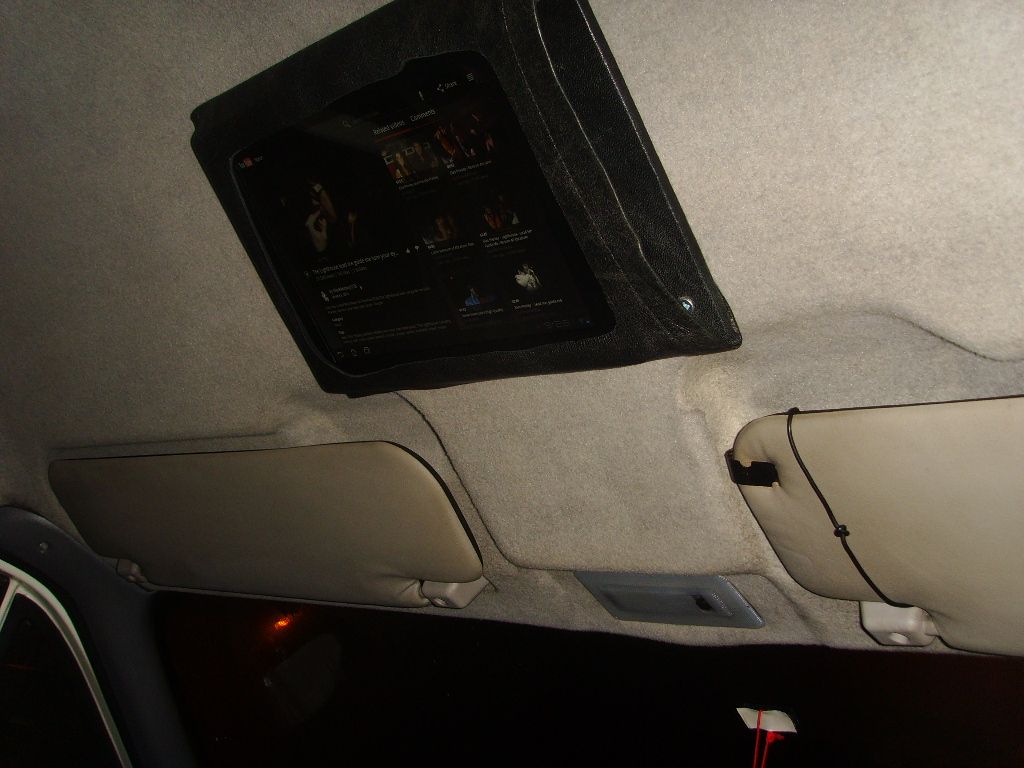

Postby solarman » Tue Nov 29, 2011 7:34 pm
another addition to my campervan is a tablet holder home made from some left over laminate flooring and some pieces cut from my old leather jacket and mounted to the headliner for ease of access,perfect for the google directions and internet and music bluetoothed to my headphones,very happy with it,
Solarman.Here,s some pics;

Re: 1st Campervan
Postby montym100 » Sat Dec 03, 2011 1:03 pm
Very cool 8) but think they`ll be some neck ache there :lol:

Re: 1st Campervan
Postby solarman » Wed Feb 01, 2012 10:22 pm
montym100 wrote:Very cool 8) but think they`ll be some neck ache there :lol:
Yes i do get a stiff neck but since it is more of a holder instead of it loose in van and i usually have bluetooth headphones on so not looking up all the time.I may put another one in at visor level or lower down near heater controls for when i,m parked up and need to watch something but that will need a good place to put it.
