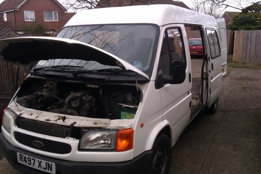

Meet my newley acquired 1997 LWB Semi High top, 2.5d
Good points-
Engine runs well
Its got side WIndows
Drives well
Doors, sills and archs seem to have been treated at some point, and seem ok.
Bad points- (Why is it, no matter how hard i look, these things only appear visable to me after ive handed over money?)
Slight water drip from timing belt cover
Floor has parted company with rear wheel archs
Lock are VERY dodgy i.e lock, but don't unlock

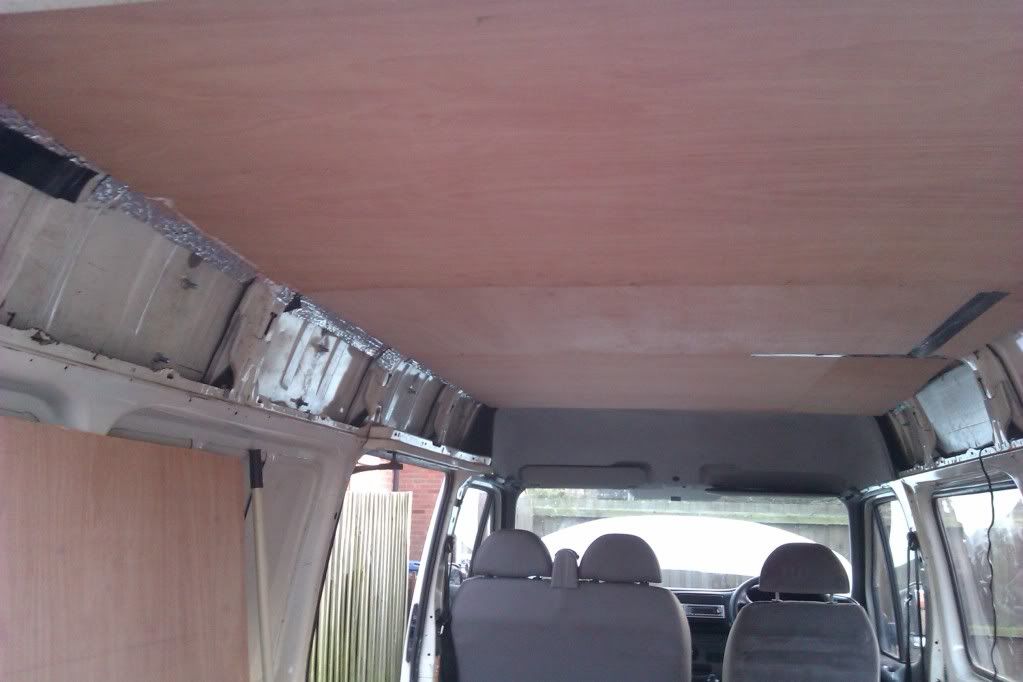

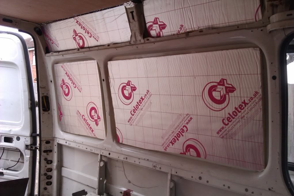

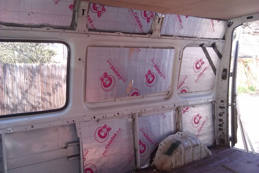

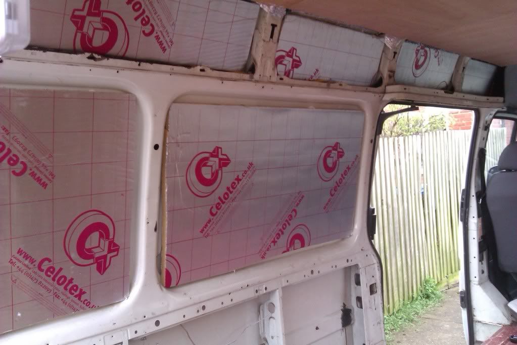

Screechowl - Its getting there slowly. Now the roof is insulated and boarded, i am starting to enjoy it. (working above your head and against gravity can be infuriating!)
Ake - Good idea, although i have two keys and neither work..

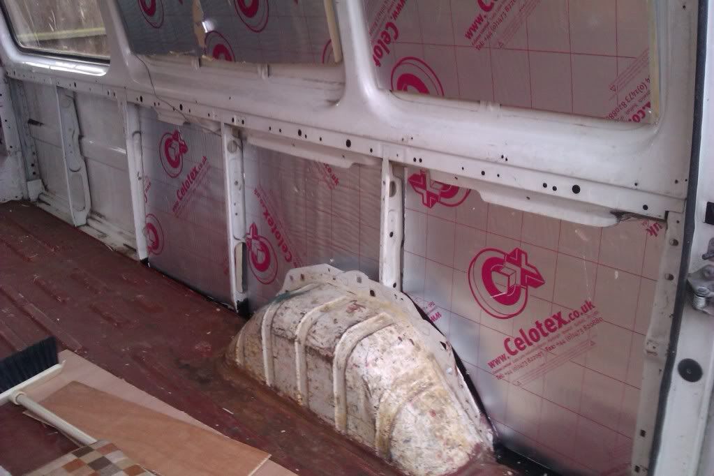

Here are a few update pics. The roof is insulated with foiled bubble wrap from Homebase and the walls with 25mm Celotex. I used Sikaflex to stick the boards up. (duck tape in the pictures is temporary)
I really recommend Celotex, at least in terms of working with it. Easy to cut and very satisfying to wedge into cavities in the wall. Lets hope it insulates well..
Since these photos i have boarded up the drivers side wall, now just waiting on getting my floor welded up.

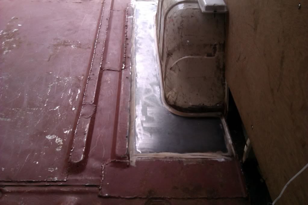

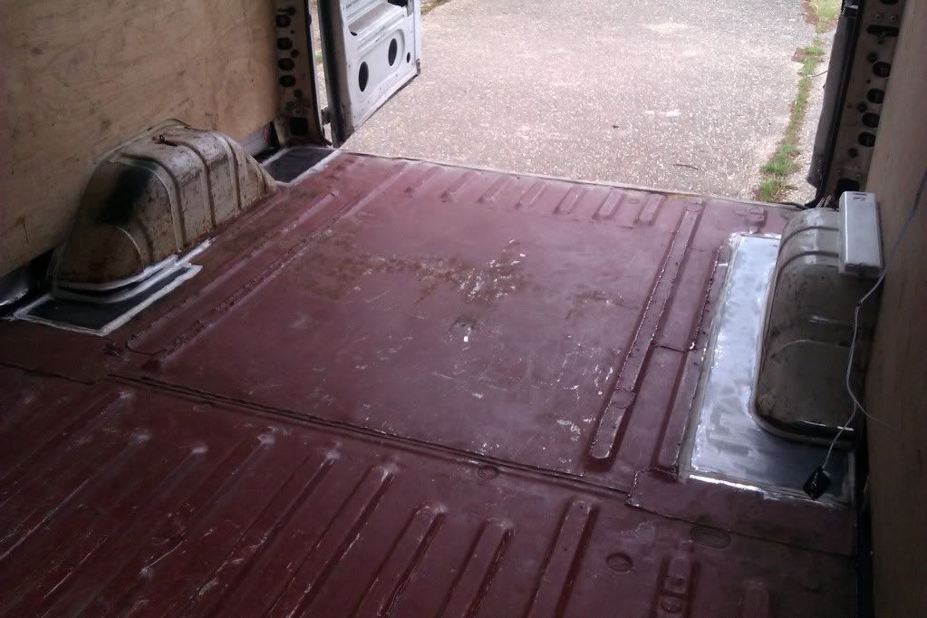

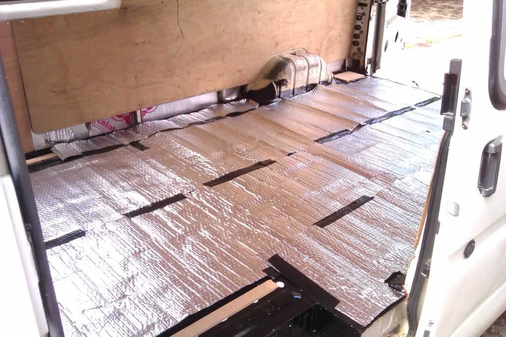

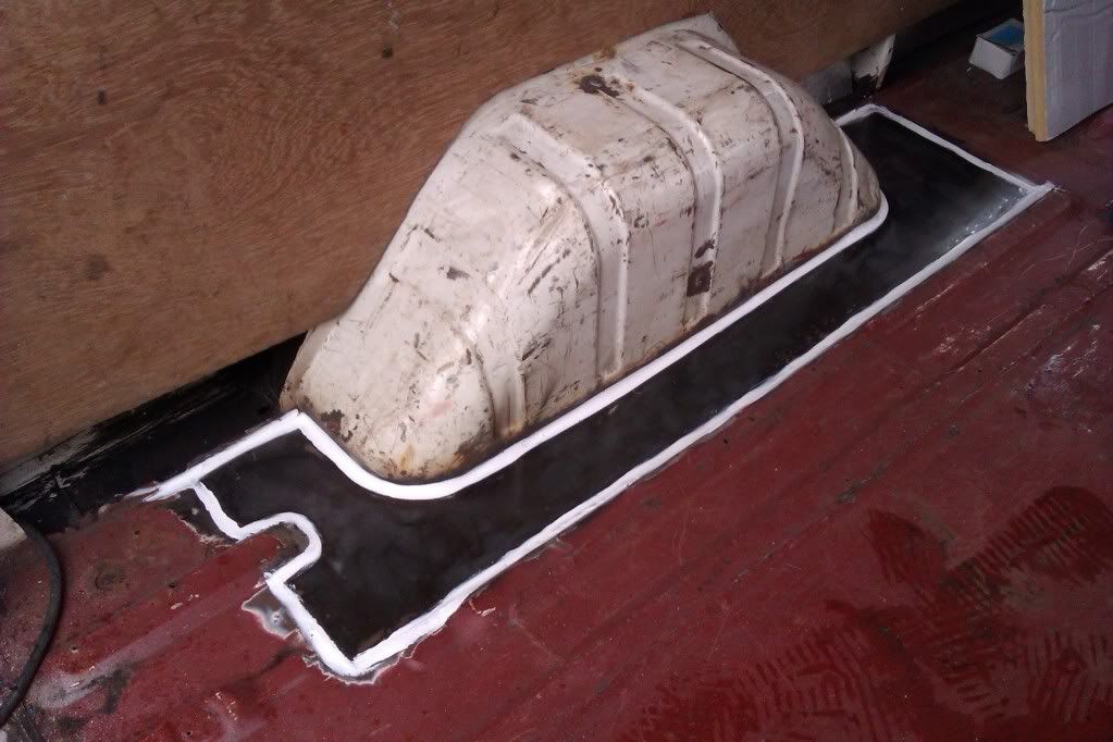

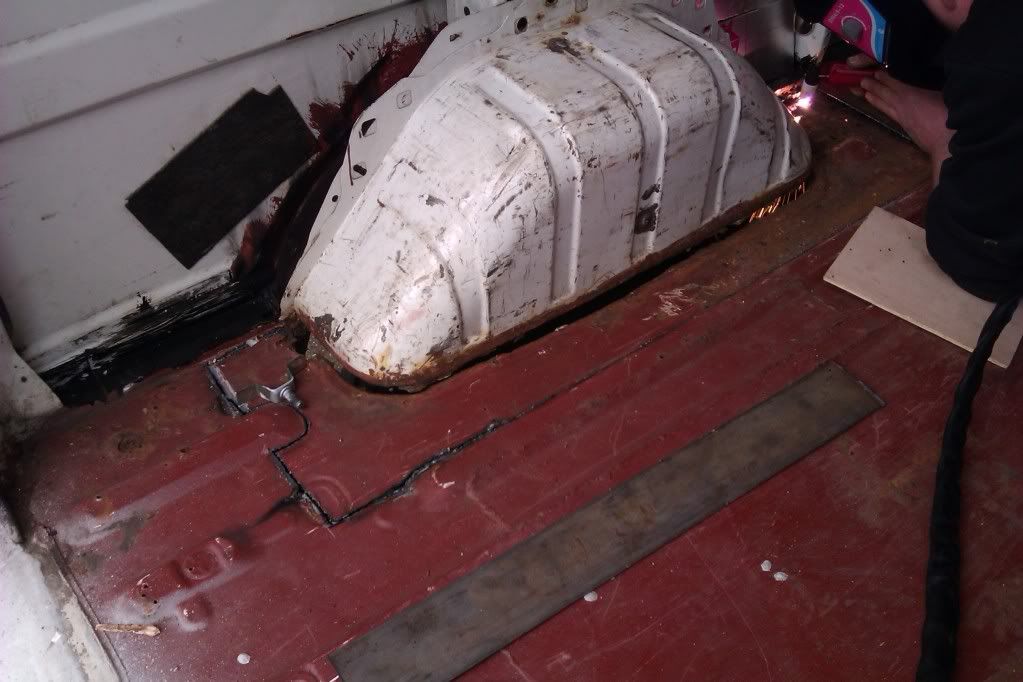

Floor plasma cut and welded up

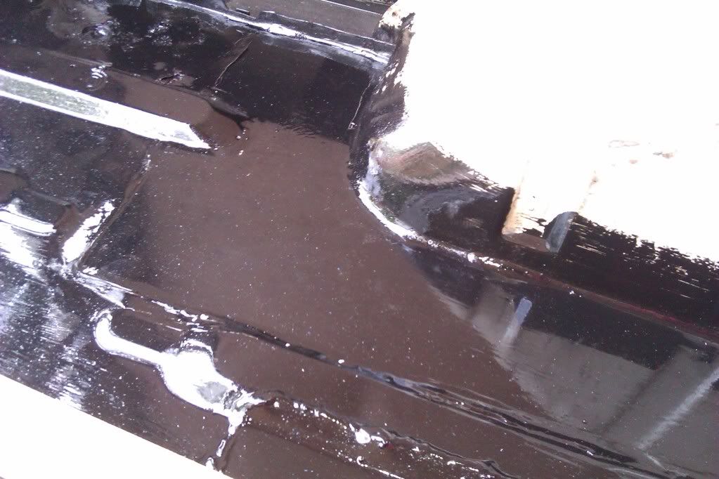

Painted with Aldi black metal paint (really good stuff)
Homebase foil insulation laid down
Ply in and my first unit frame knocked up. Huzzah!
