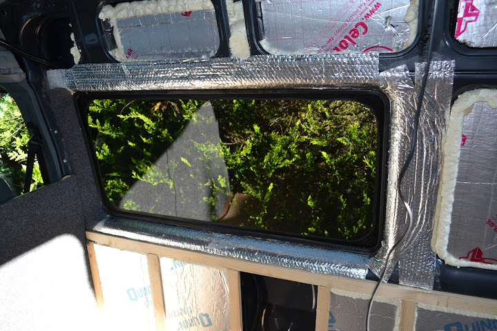

So I removed all the old ply, filled in the millions of holes in the floor - discovered that the previous owner had screwed through the fuel tank - DOH!
Had to drop the tank and put another screw in to plug the hole.
Then re-layed new ply using 2x1 battens, 25mm cellotex type insulation board and 12mm ply.
Then I took a trip to Autoglaze in Gloucester to get bonded privacy windows fitted. I also fitted the 240v external power point.
Got cracking inside on the insulation. 2x1 battens stuck on with sikaflex. Combination of cellotex boards, 100mm lower down and 50mm elsewhere. I've filled the gaps with B2 fire grade expanding foam. Also bubble foil insulation in where I don't have space for insulation boards and tricky areas. Electric cables were pushed through conduit, should I need to add any other cables.
I've also had a Fiamma ZIP awning fitted, I have a Heki midi waiting to fit. Some of the wall panels have been made, just need to carpet them and fit them.

Decided to fit the roof window myself... gulp!

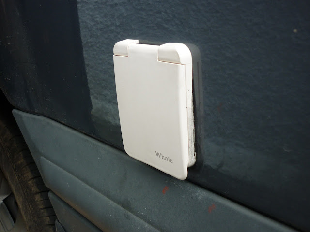

Fitted a whale water point on the recommendation of those on here

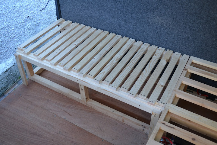

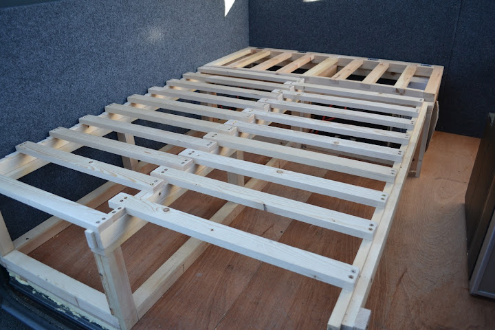

I had a local fabricator weld a steel box section frame to support a bed above the rear garage.
Starting to take shape and see the space available.
Bed base finished, although I will re-do one section when I return from Europe. I had to rush it a bit and it isn't quite what I want.

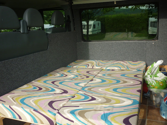

My wife made the foam covers. Also made a nicer leg section for the bed and a carpet section to hide the inside.

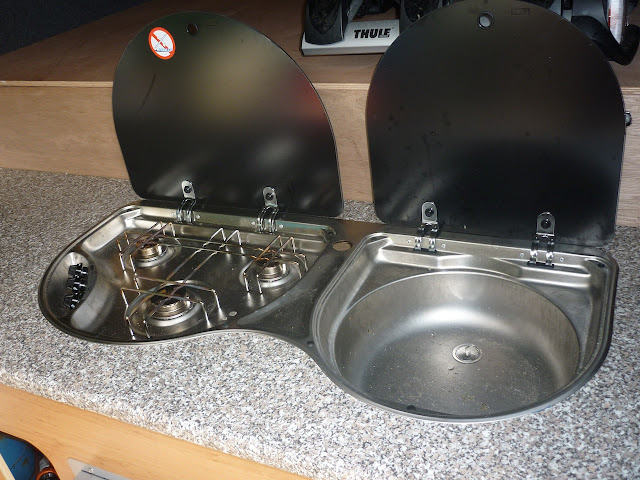

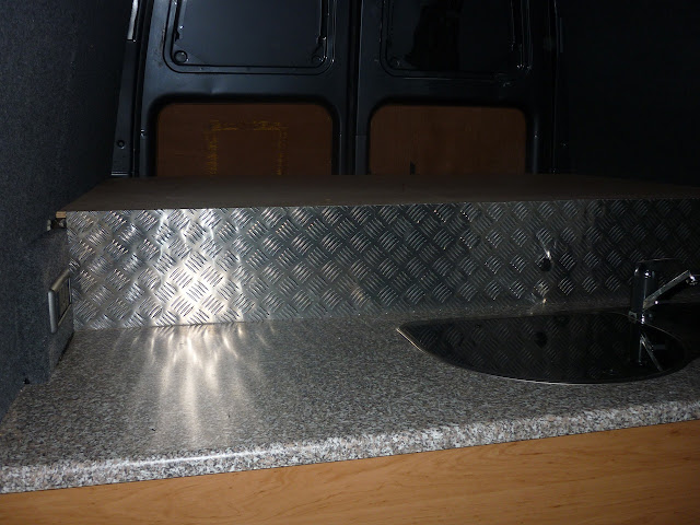

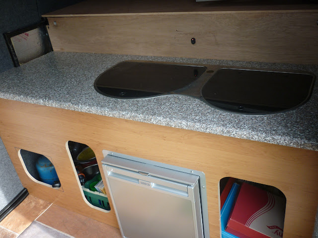

Part of the kitchen fitted
Smev 8123. Not an easy hob to fit!

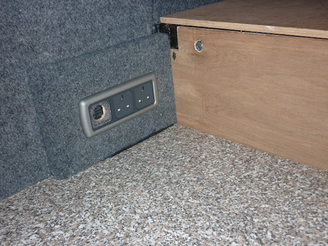

Some electrics
More electrics and tidied up a few sections
Treadplate splash back
Fitted a whale water point.

Part of the kitchen fitted. Using Vohringer ply and the fridge is a Waeco CR65.

Some electrics

Lovely job, with the bed at that angle, how long is it? (the bed ;))
2.2 Duratorq-TDCi (110PS)
Surfunitone
Posts: 250
Joined: Tue Apr 03, 2012 5:51 am
Re: Mk7 conversion
Postby mtbmatt » Mon Jul 02, 2012 8:44 pm
Bang on 180cm.
