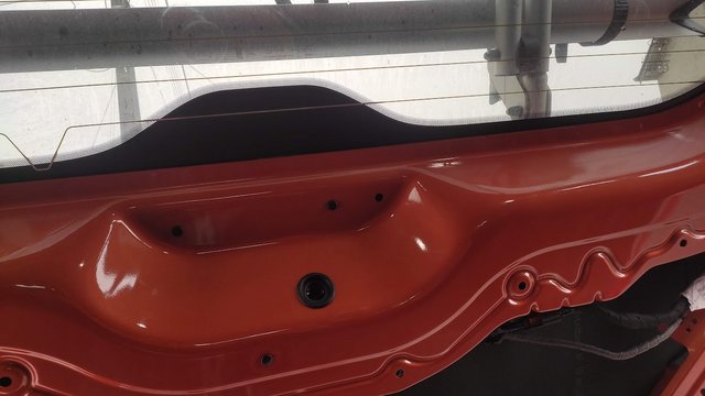

Postby zmendoza » Tue Apr 11, 2023 10:45 am
Hello !
Thank you for your knowledge ! Way more difficult to find answers ford Ford than for my old VW T4 ! :)
Here is the trick for this stupid inside tailgate button !

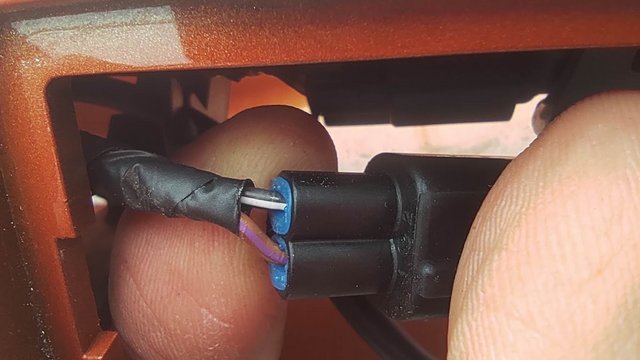

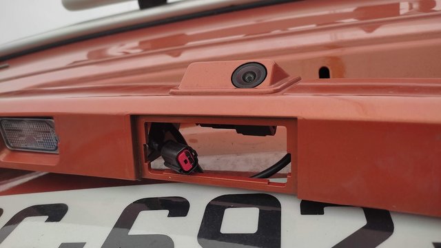

I remove the panel with the outdoor button. 4 screws to remove from the inside.

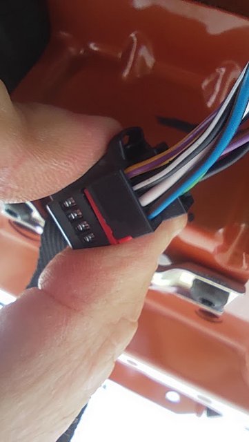

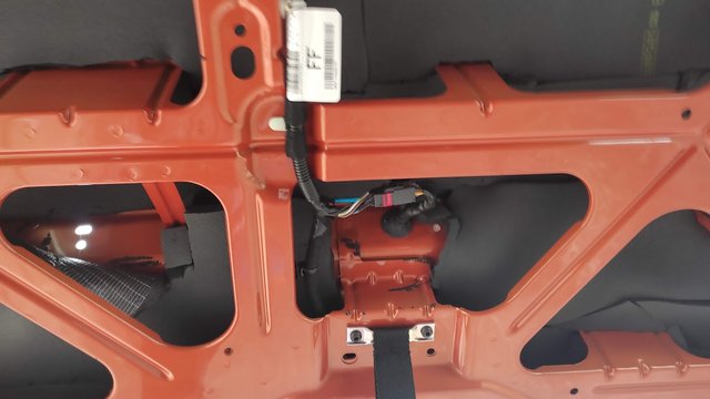

So the wires are : purple&brown and black&white ! Simple !
Back inside! The connector where to get those wires :
But ... Not so simple ! There is 2 purple&brown and 2 black&white !...
I had to try and try again ...
The good ones are those :
And now it works perfectly !

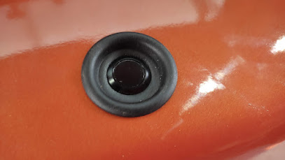

Button installed in a plastic cover in the middle of the panel. No drilling on the metal !
But why isn't it installed by default? Mystery...
