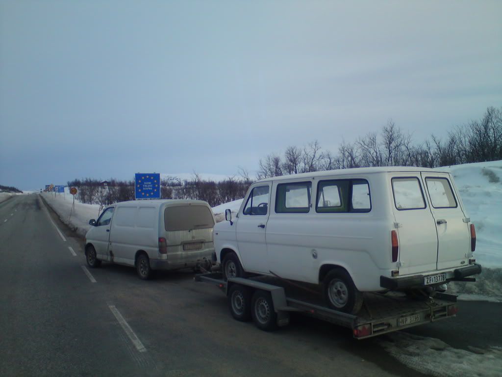

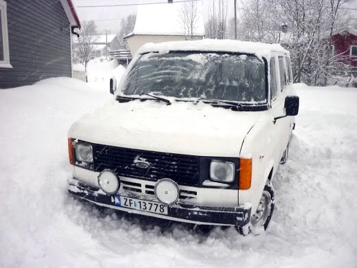

I saw a 1980 diesel transit for sale in the paper. I had been looking for a MK2 diesel for a few years, the only problem was that this car was 2000km away. The only photo in the ad was this:
But I would not miss the opportunity so I called the guy, said I bought it without seeing it and asked for his account and transfered money. The transit was mine :D
2 months later I went to the north of Norway to pick it up.
Shortest way back was trough Finland and Sweden. the trip up and down took me 6 days.

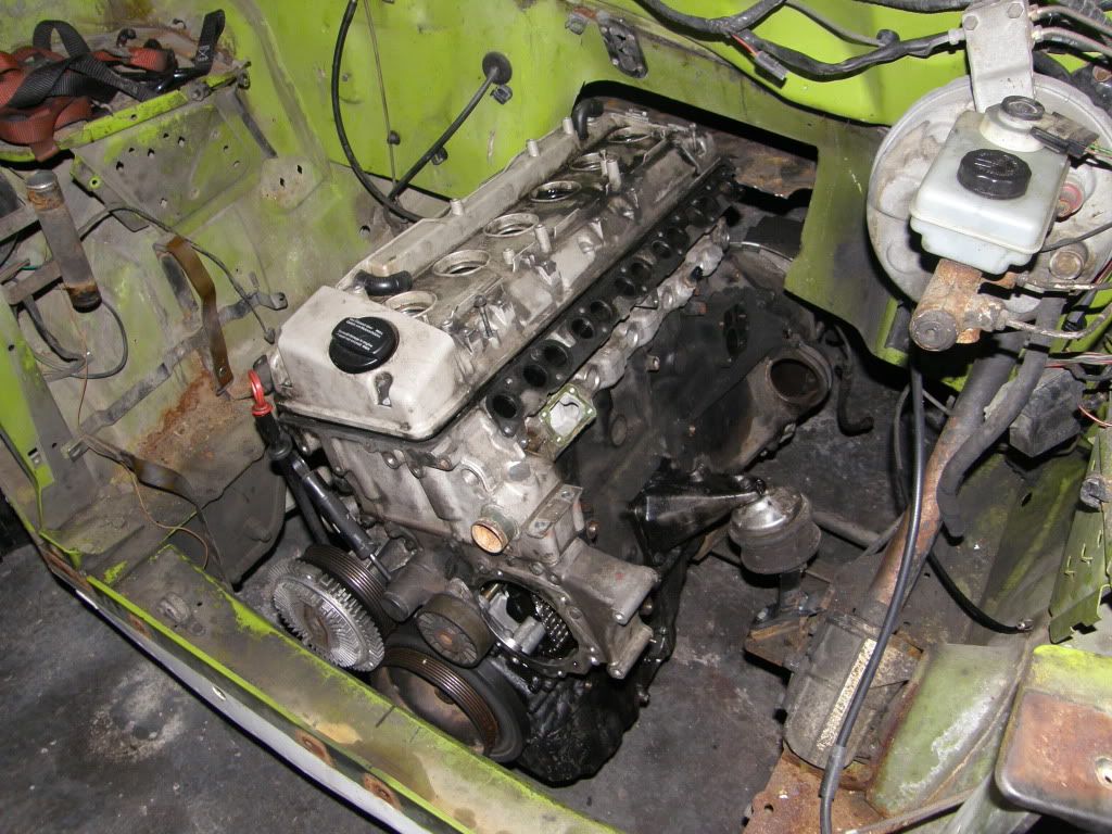

As you all know, the original diesel is not very fast so it had to go. My favorite engine is the Mercedes OM606 3L 6syl 24valve turbo 177hp diesel from w210 1997-2000 so I thought that the coolest van and the best engine would be a perfect match :) So I started the project
With a little cutting, the engine fit perfectly.

The Transit looks great. Not much rust because of the salt/snow ?

The engine I am using is a Mercedes OM606. the engine are an update from the OM603 from 1985-1994 with a 24 valve head and an electronically controlled mechanical pump. The engine are by many considered the best diesel engine mercedes have made. I don't like the computer controlled pump(I like diesel engines that can run without electricity) but fortunately the older mechanical pump fit. But the problem with those pumps are that they can only deliver fuel for ca 175hp so I have mounted larger elements in the pump. Now it can deliver fuel enough for ca 450hp :D But to burn that much fuel you need air, lots of air, so this summer I am going to put on a supercharger.
It should take the engine to ca 250hp (with intercooler) later I have a plan to also fit a large turbo. That should bring the engine to 400+hp
I am putting on a 6 speed from a 2001 220cdi mercedes. It fits the engine but the axle is shorter so I had to shorten the housing
here is the new transmission mound, it is my first alu weld but it became quite strong(I can jump on it) so I hope it will hold.
I am working on the engine mounts now.

Yes the car has unusually little rust(we have a lot of that in Norway) I was very happy when I saw that since I bought it without seeing it :)
