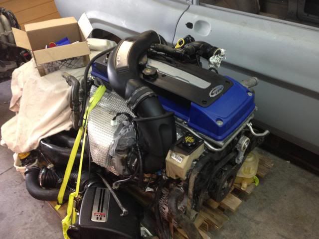

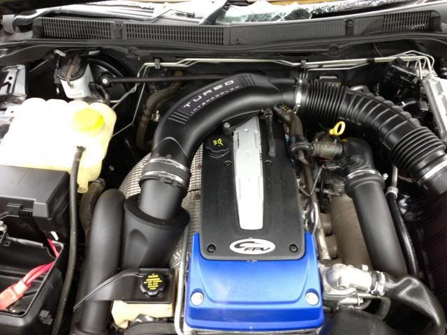

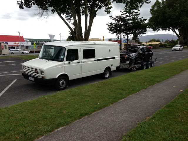

After searching for a couple of years I have finally found the transmission I was after - a ZF 6 speed automatic. I drove down to Rotorua today to pick it up. A , a minor problem being that it still has a car attached to it
It also has an engine with a very pretty blue cam cover, I think I like this one better than the black one of the Territory engine. For those not familiar with these cars, this was a "special" built by FPV (Ford Performance Vehicles) and featured a 310KW (417hp) engine with 560Nm of torque:)

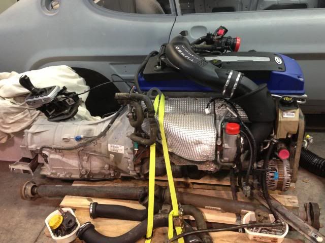

Spent some time yesterday removing the engine & trans. Turns out it was fairly straightforward. After unbolting the exhaust, the gearbox nearly dropped to the ground- the gearbox mount was very much broken! Removed exhaust, driveshaft, rad, intercooler and disconnected a few hoses. Hooked a strop around the engine and plucked it out with a forklift. Turns out both engine mounts were very broken, so didn't even need to disconnect those! Anyway, here it is, fortunately nothing broken apart from the mounts

Postby Vandalism » Mon Jan 20, 2014 1:04 pm
is that a capri mk1 in the last pic? any more pics as i have one :)

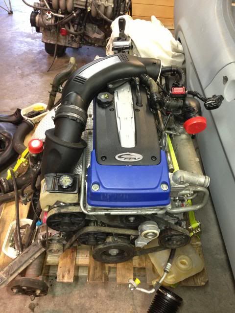

Time has been scarce lately, but finally spent a few hours on the old bus this weekend. I put the engine in position, supported by blocks of wood, and after moving it many many times I finally have it in a position I am happy with. I have had to swap the sump pan for one from an earlier model Falcon (BA) which has the bowl at the front, as mine came with a rear bowl sump pan. But this did not present any real problems, my block even has the front dipstick position in the block with a bung fitted :) I did a check against my Mk2 (which is fitted with a Pinto 2.0) and the crankshaft centreline is 130mm LOWER on the 6 cylinder installation than the Mk2/Pinto :shock: The front axle and steering drag link will clear the sump pan on full bump compression, and the trans is fairly tight underneath, but overall it should work okay. A few pics as always. I have drawn up the trans mounts, and will get those laser cut next week, and also begin work on an engine crossmember, to which I will attach the engine mounts.
