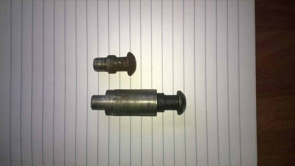

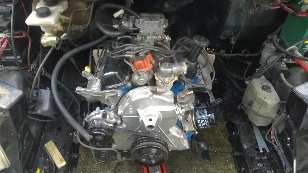

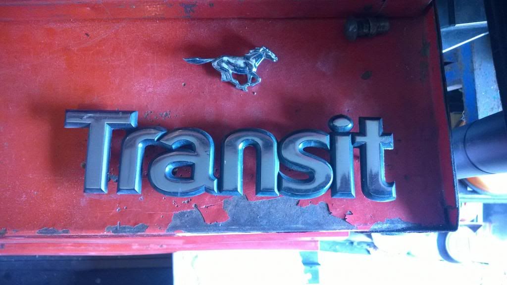

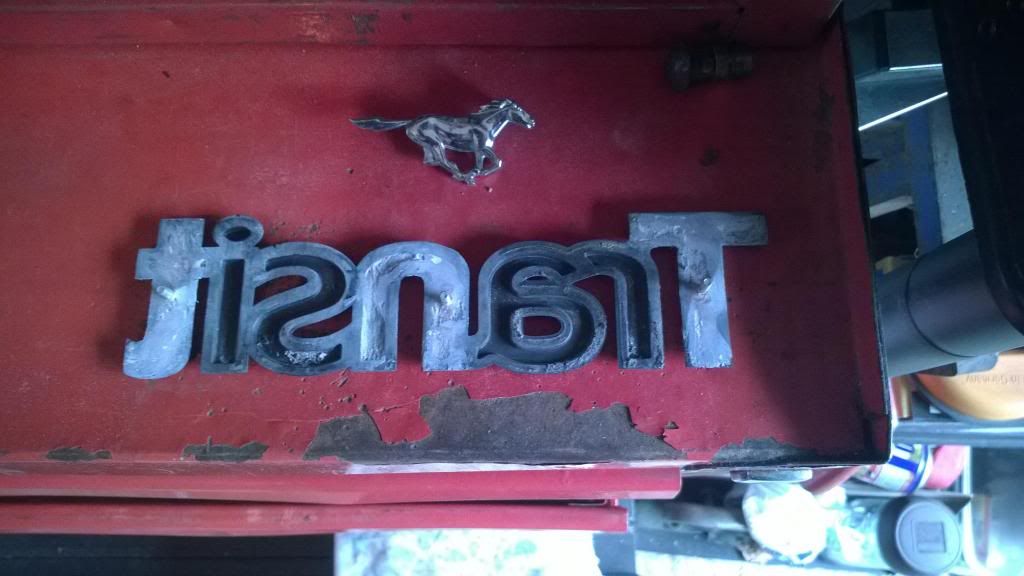

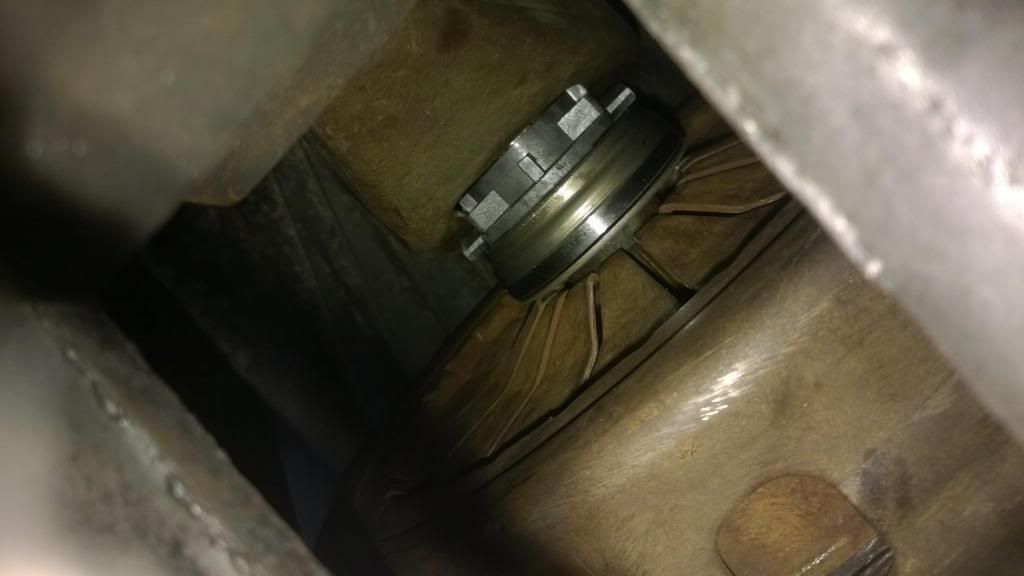

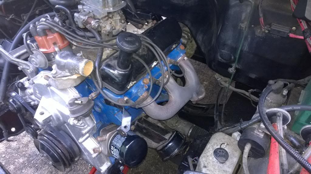

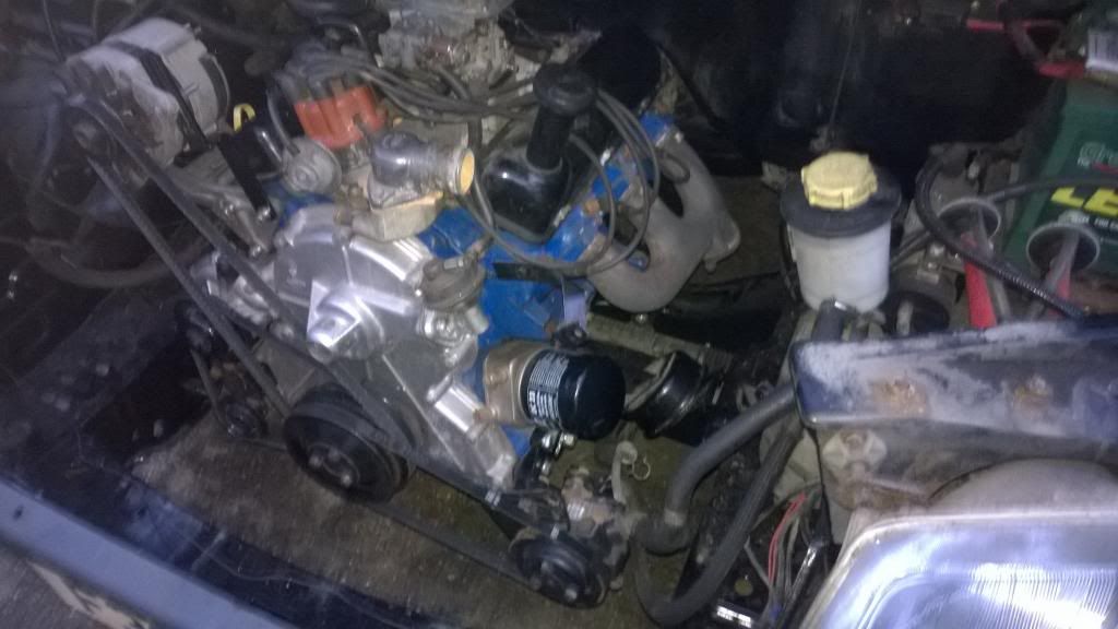

Postby Leeday » Fri Mar 28, 2014 8:20 pm

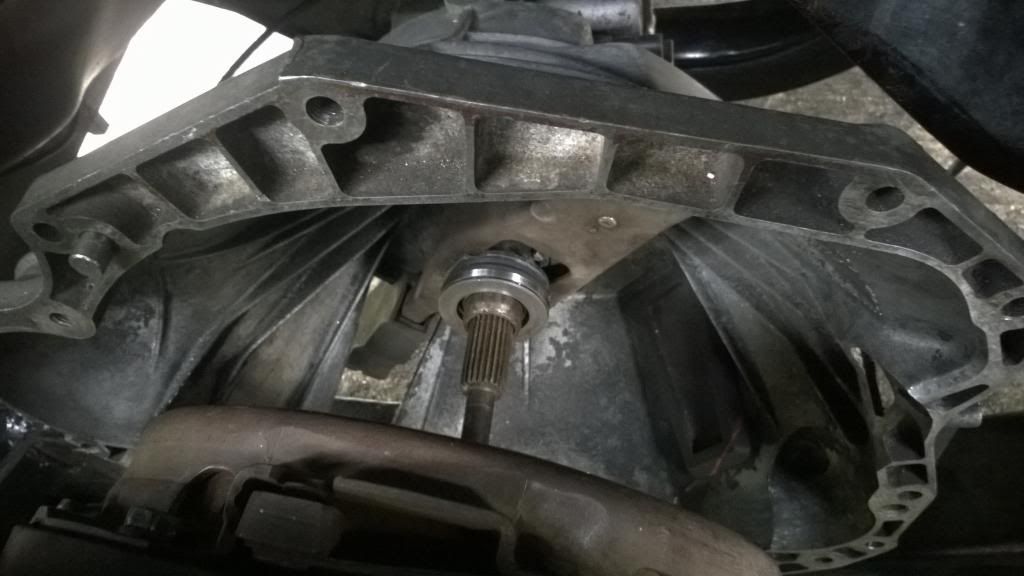

Woke up with some enthusiasm today :D so whilst waiting for the postman thought I would play with the mk5 TRANSIT badge I got from mr scrapman (minus its sticky back). Fibre-glassed 3 bolts into the back of badge, sanded it and will apply it with 3 nuts and some clear sticky stuff:
Tidied up the garage a bit, then at 2pm I saw a familiar site coming my way:
And he had a small parcel for me :D from Tim:
Ran outside and installed the new bearing:

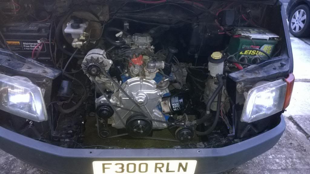

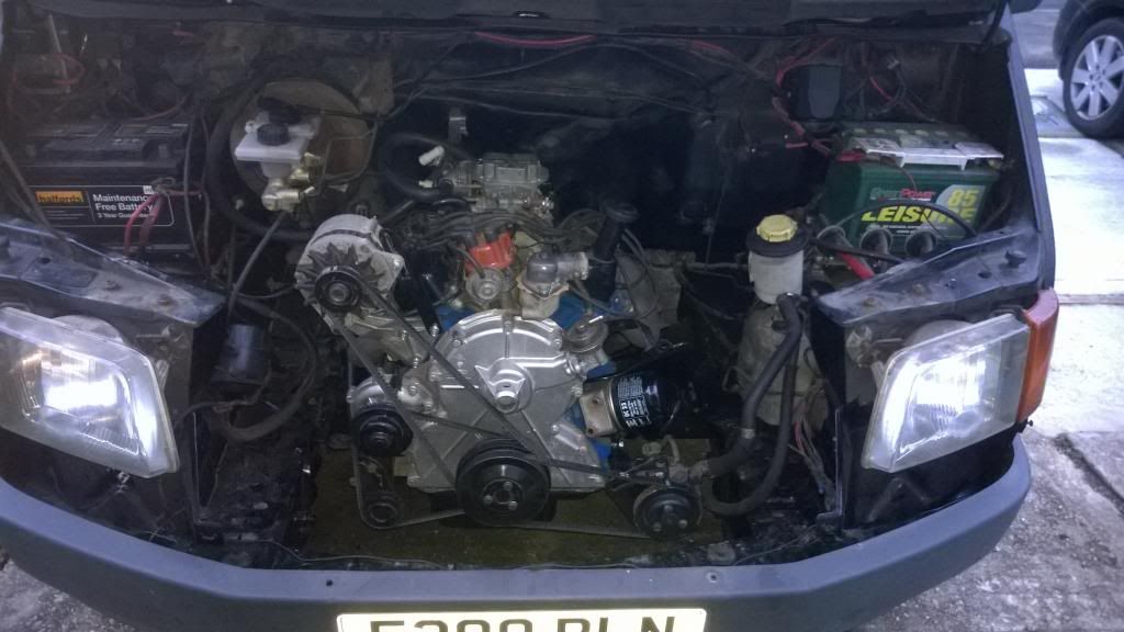

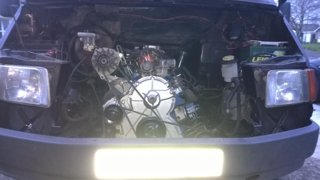

Then wrestled with the trolley jack and got the engine connected to the gearbox and sat on its engine mounts:
At last :D engine is in :D
With the extension pin Tim supplied, clutch release bearing is now sat just behind the clutch cover fingers in its fully back position:

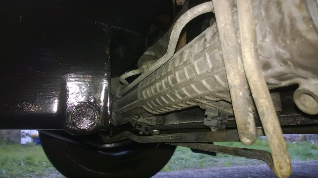

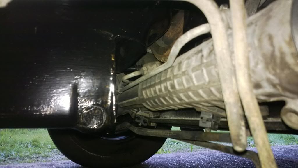

The sump modifications I done have worked well, with plenty of clearance around the steering rack:
Fitted throttle cable, clutch cable, alternator and power steering pump and pipes:
