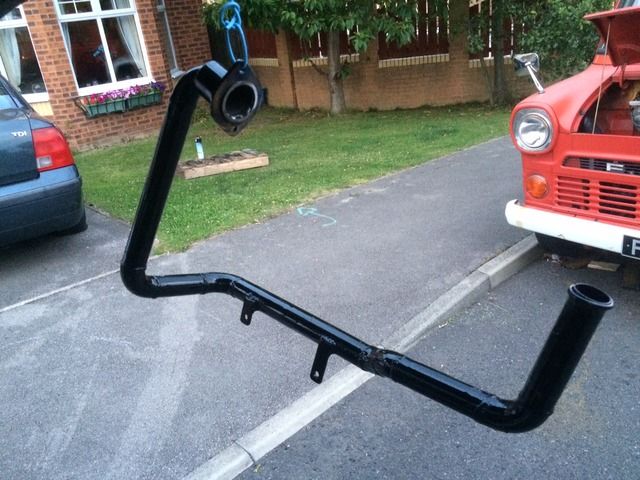

well didnt manage ford fair :( Transitmania 7 next :? :roll: :lol:
anyway made this tonight - it's to transfer the water feed under the engine to the bottom hose on the rad
