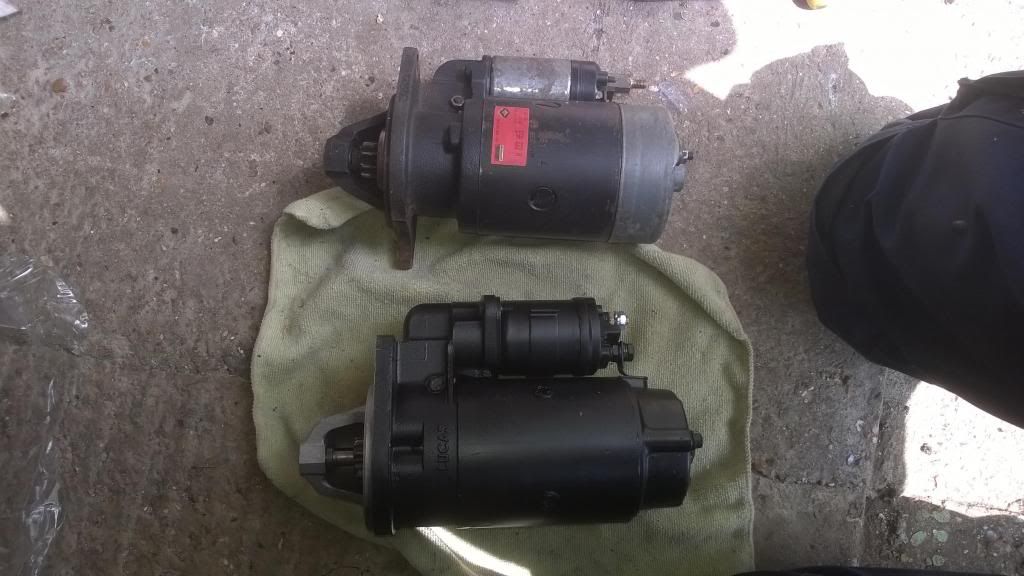

Van has been running well until Monday when the noisy starter motor failed completely, so as usual no one on the island could supply one so found a refurbished one from a company near where I used to live in Daventry, purchased and sent via 24 hour courier :D
old one top of picture, new one below.. fitted new one and all is well again ... and quitter starting :D

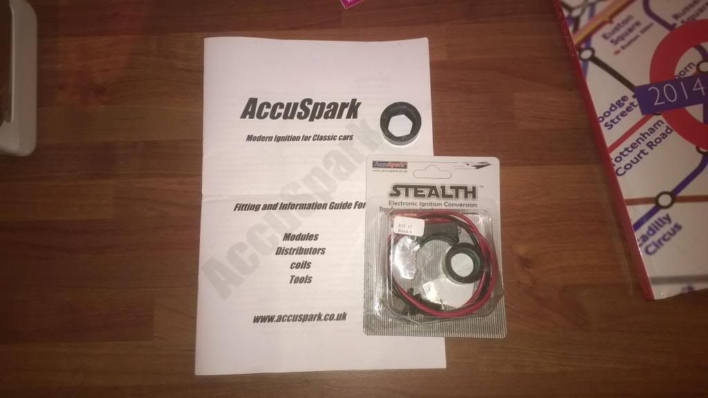

Today fitted the new electronic kit I purchased:
Condensor out, points out, new bits in .... turned the key ... no start :lol: slackened off distributor, turned it about a few times and van started, connected my strobe light, set timing to 10 degrees BTDC, van running sweet again, played with idling screws on carb, got tickover down to 900 rpm and engine ticks over with next to no vibration :D revs smoothly :D

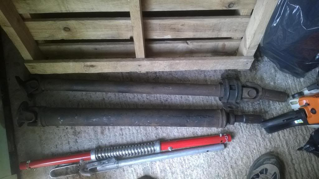

Next job is to fit the correct prop-shaft which has the centre bearing in the correct place to bolt to the van`s original centre mount cradle :D BIG thanks to MinorMatt for supplying this correct prop-shaft for free and for meeting me on my way home from Northants:

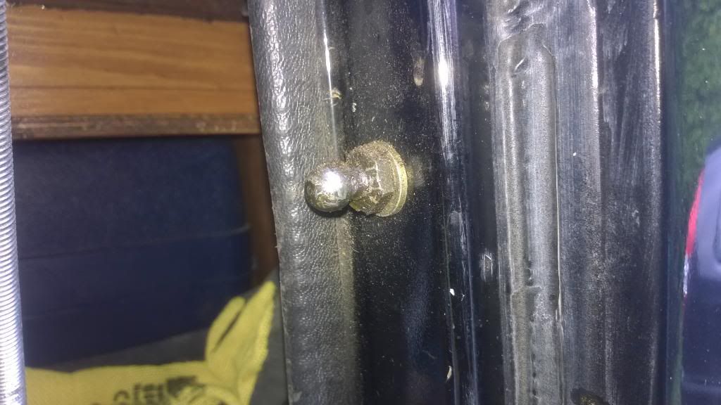

Had the rear tailgate strut top mounting pin / ball shear off, so tailgate is suddenly heavy, so big thanks to hitman for supplying me with 2 replacements for free and posting them to me:

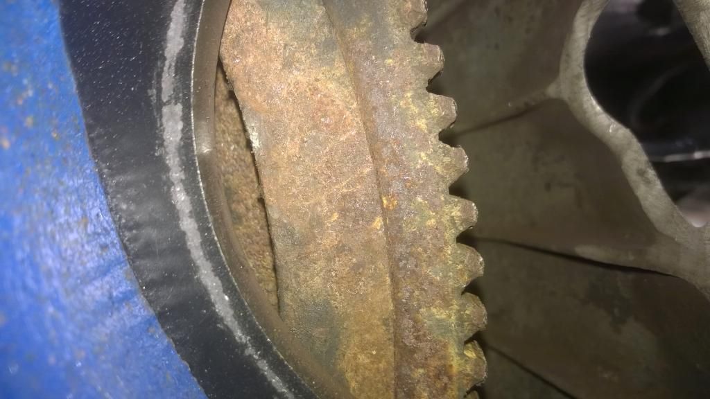

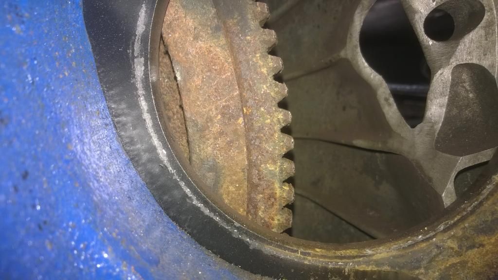

My new starter motor has started to get noisy during starting over the past few days :shock:
Today the van would not start, starter motor is just spinning but engine is not turning over :shock: :shock:

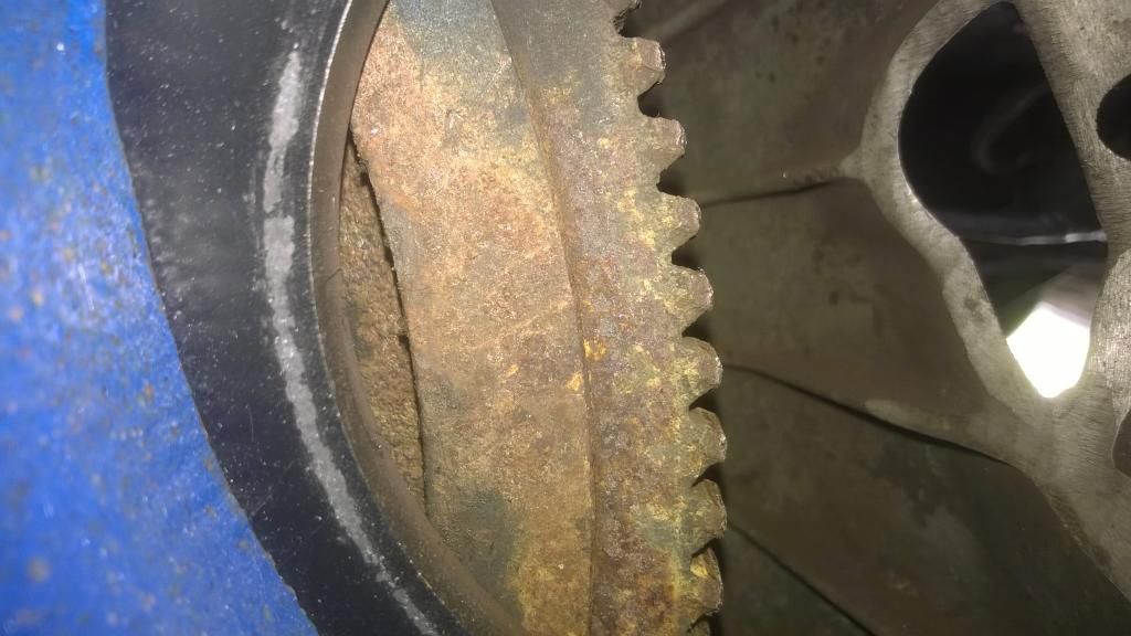

So, out with my spanners and removed the starter motor, took some measurements to check engagement of starter motor cog and ring gear, the cog moves out and fully engages with the ring gear in its forward and back movement, so measured starter cog to edge of mounting hole and ring gear to mounting hole and the starter cog is missing the ring gear.... looked closer at the flywheel ring gear and noticed it is badly worn :evil:
So it looks like gearbox out, clutch off, flywheel off, purchase a new lightened flywheel ( New Genuine Lightweight Flywheel/Ringear Ford Essex V6 Free UK delivery (conditions apply) Price: £139.99 ) .. fit new flywheel, re-fit clutch, re-fit gearbox, re-fit new starter and hopefully up and running again.
Awaiting total price with courier charge to the Isle of Wight and can then order it, await its arrival then start the removal / re-fit process.

Postby conrod » Sat May 17, 2014 11:58 pm
EDIT: I don't think the ring gear is your problem. A bit of rust, but not badly worn, the teeth are all still there.Looks like maybe the tops knocked off, but should still work.
I reckon the starter is not in the correct position.
Get one of the original thin steel sandwich plates for an Essex V6 and overlay over your gearbox adaptor:
Looking at your pics again, I don't think the starter pinion is meshing full depth, rather it is running on the very top of the teeth and has knocked them off.

Postby Leeday » Sun May 18, 2014 1:10 am
Hey Conrad,
Thanks for the input, didn`t even give it a thought the hole in the adaptor plate maybe out of place, does make sense as where the starter motor cog teeth end is exactly at the point where the heads of the ring gear are, so as you say its not engaging into the full depth of the ring gear, this would probably account for the noisy starting of the engine as well. this also poses another problem in the fact its a 10mm adaptor plate that has been laser cut and is impossible to get to or work on with the engine / gearbox in situ, so may have to remove gearbox and somehow modify the adaptor plate.

Postby conrod » Sun May 18, 2014 4:33 am
If the starter is in the wrong position, it would have been very noisy from day one, sort of a loud growling noise as you crank it over. If that is the case, the only way to remedy is to remove the adaptor plate, grind the inside edge of the opening, and reposition the holes for the bolts (or slot the starter end bracket holes) to allow the starter to move closer in mesh. Needs a bit more of a closer look IMO before you go throwing any money at it :)

Postby dieselhead123 » Sun May 18, 2014 7:23 am
Hello Lee, is the tooth damage all the way around the ring gear? The ring gear teeth do appear to be 'missing' the tops of the teeth :shock:
I will pop out the the workshop later and take a pic of another flywheel and post it up so the teeth shape can be compared but the teeth on yours do seem to be damaged.

Postby Leeday » Sun May 18, 2014 9:31 am
conrod wrote:If the starter is in the wrong position, it would have been very noisy from day one, sort of a loud growling noise as you crank it over. If that is the case, the only way to remedy is to remove the adaptor plate, grind the inside edge of the opening, and reposition the holes for the bolts (or slot the starter end bracket holes) to allow the starter to move closer in mesh. Needs a bit more of a closer look IMO before you go throwing any money at it :)
Conrad
Hi,

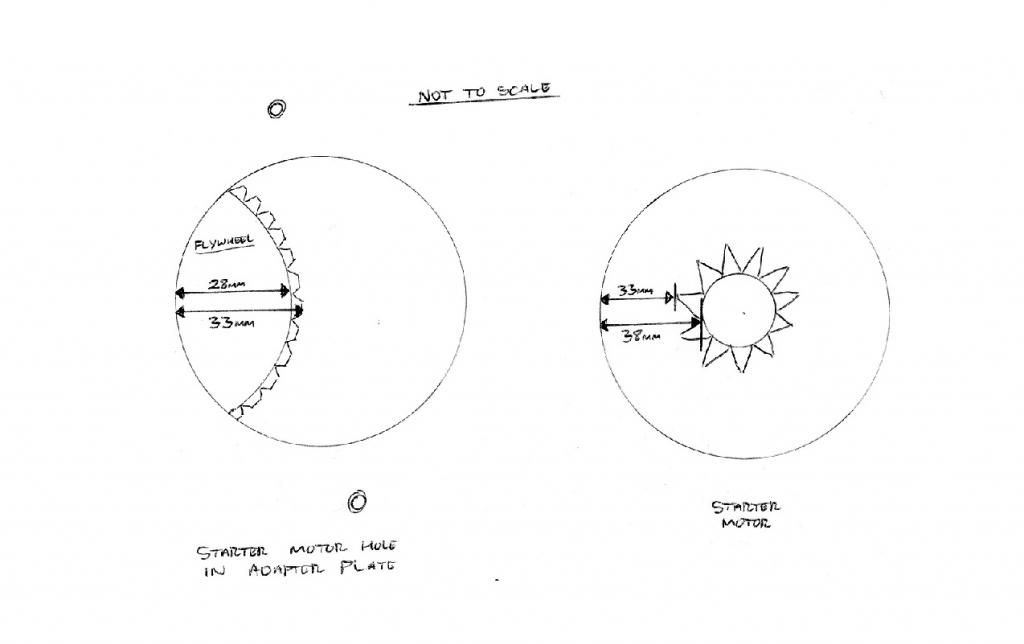

Starter motor has definitely been noisy from day one and killed the one that came with it, bought a new one for £130 and now that one has damaged teeth on the cog.
Took measurements of everything and can be seen in drawing below, starter has never meshed fully (depth wise) with the ring gear:

Postby Leeday » Sun May 18, 2014 10:05 am
dieselhead123 wrote:Hello Lee, is the tooth damage all the way around the ring gear? The ring gear teeth do appear to be 'missing' the tops of the teeth :shock:
Hi Tim,
Can you also measure diameter across flywheel (edge to edge) and across ring gear (tooth edge to tooth edge).
I am now guessing one of two things, if you measured for the starter motor hole to be cut to allow for the starter motor cog to fully engage with the ring gear then my flywheel is smaller in diameter than the one you used as a template (by approx. 20mm) or the hole in this template is in wrong place.
I will have to remove gearbox whatever happens so I can measure my flywheel. I know that the ring gear was not this badly damaged when I installed the engine so this has happened since installation.
