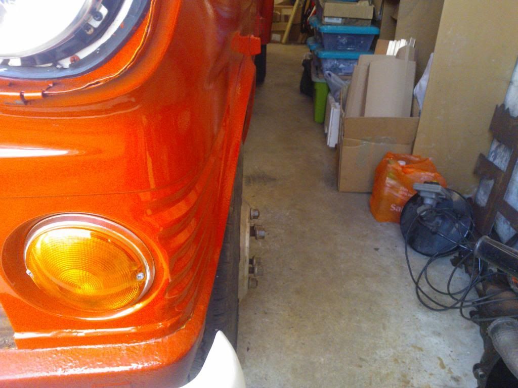

Postby RP123 » Wed May 15, 2013 10:29 pm
Some pictures with the wheels on.

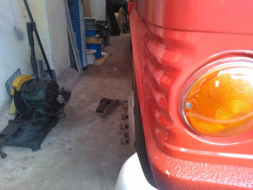

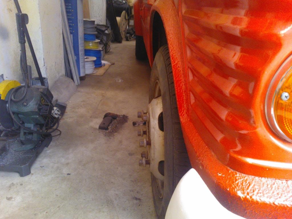

Postby RP123 » Wed May 15, 2013 10:30 pm
Couple more

Postby Luke » Wed May 15, 2013 11:10 pm
perfect width then 8)
