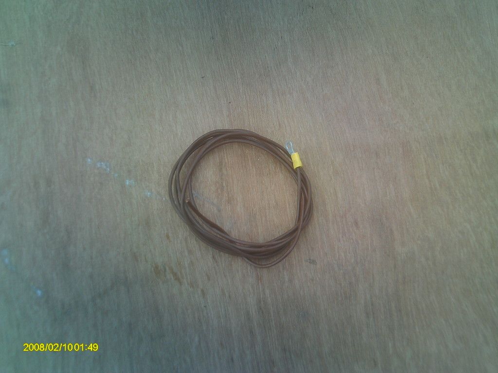

My wiring loom, I have actually betrayed my principle of getting everything as simple as possible here, you can rig the "engine management system" to work with no wiring at all, if you fit a mechanical stop lever, not a good idea with the VW engine, as you could steal it by bump starting it. Not a problem with the Duratorq though, thief tries to bump start it, timing chain jumps, pistons hit valves and smash the cam carrier. :lol: Ford think of everyting :mrgreen:
