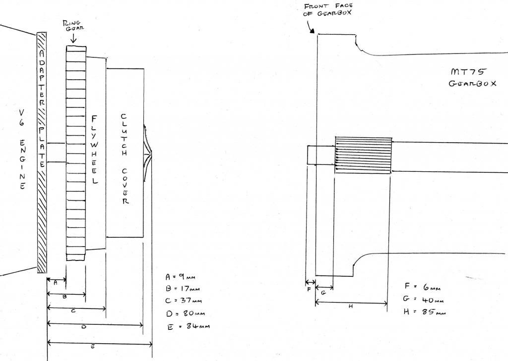

Going to do loads of measurements off of the old original gearbox tomorrow as have all the original bits and bobs and gearbox and clutch etc, as long as starter lines up ok with ring gear and input shaft locates with clutch then I will be modifying the release arm so as to move the bearing forward.

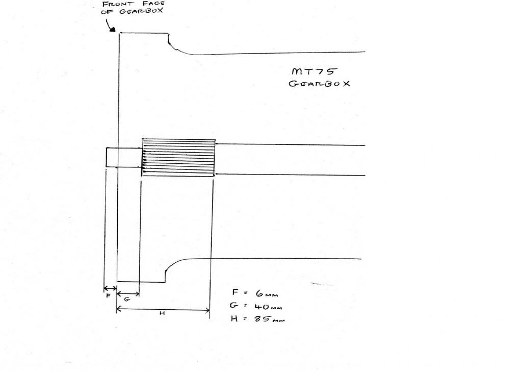

Well have took some measurements:
Seems the splines on gearbox connect with the clutch pressure plate ok, I think the end of the gearbox shaft doesn`t quite reach the spigot bearing in the back of the engine though, starter motor engages with ring gear ok, so looks like I need to modify the clutch release arm so as to move the release bearing further forward.

Postby Leeday » Tue Mar 25, 2014 10:48 am
On further examination it seems the clutch pressure plate splines start 30mm in from clutch cover fingers, which means the splines on the gearbox input shaft are only sliding into the pressure plate by 14mm, being as the splines on the input shaft are 45mm long, 14mm of contact is not enough, so I am therefore assuming the flywheel I have from the SVO Transit is different / thinner than the car derived flywheel. So maybe I now need a car variant flywheel :(

Postby Leeday » Tue Mar 25, 2014 11:02 am
Seems my flywheel is approx. 30mm thick from front face to rear face: is the car variant 60mm thick from front face to rear face? anyone know :?:

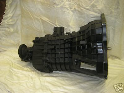

Have noticed a Transit MT75 gearbox for sale on E-Bay and the input shaft protrudes out of the front face of the gearbox more than the 6mm mine does (not sure whether it would be 36mm, but might be:
http://www.ebay.co.uk/itm/Ford-Transit- ... 417e0d76c6
