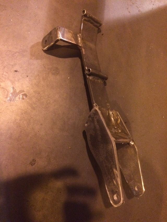

the other issue is i need to drop the alternator for the rad to fit - i made up a bracket but it was too much messing about trying to measure it up and get it accurate enough, so ive took the full bracket off the engine that holds the tensioner,alt and pas pump - i'll take it to the garage and weld it together in place - that should work better :D

finished (apart from painting it) the alternator bracket :D
done

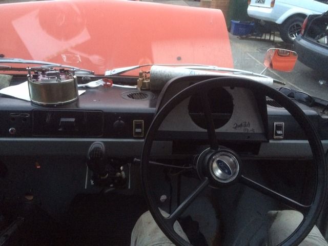

but...... with the box in i could position the gearstick and connect it up - works great 8) 8) only issue is, as i thought the heater box won't fit, no real way round it so i'll have to make up a new heater box or adapt somthing :? :idea:
picture of the gearstick - i really like the dash stick it gives loads of leg room for the middle passenger and its easly accessible without leaning :D this is in the final position, i need to make a bracket for the bottom part but it works as it is also i need to make a surround for it but that can be done once its on the road
not the best picture it was getting dark :roll:

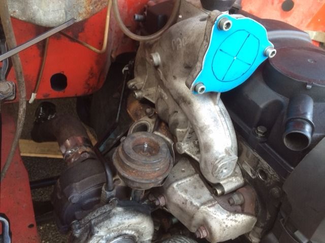

thanks Bri - i've got the measurements i'm just not sure which way to do it, im going to get the rad in and all the pipes see how much room i've got - if i could go up and down on the left side of the engine (as you look at it) then it would be better than going all the way round it - as now the inlet and turbo are on the same side - only issue is space it's quite cramped in there as it is :lol:
you can see in this pic
this is all ive done today (been working on the zetec fiesta mk1) - made up the 1st part of the exhaust from the turbo down - i'm just using the passat system as its not in bad nick - should be ok for a few years then i'll have a stainless system made up - also saves me shelling out for one now :D
you can also see the start of the new intake - i'm bypassing the egr so the pipework from the intercooler will go straight to the blue bit :mrgreen:
