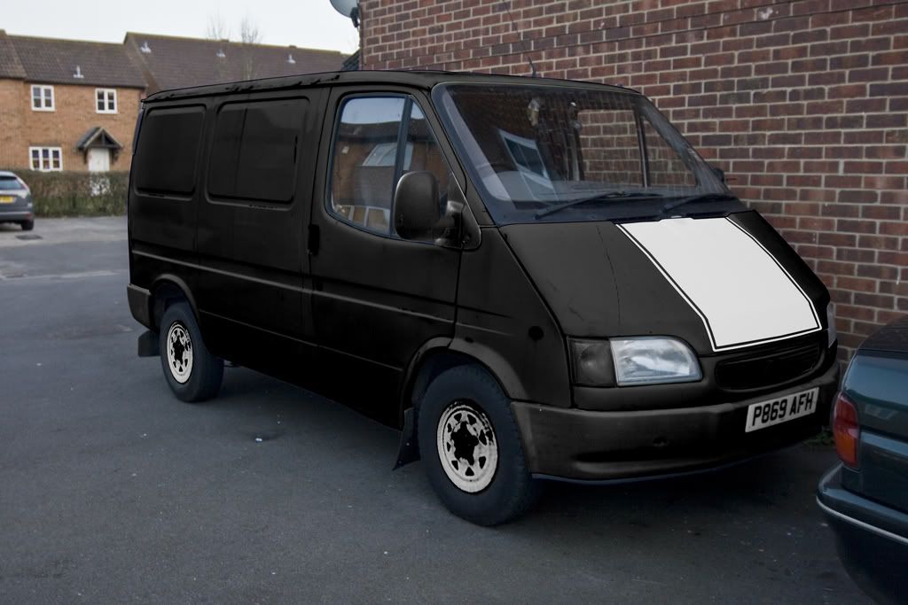

I'm working on some paint options at the moment on my computer. Just trying to figure out what colour scheme to go for. Here's one option: Metallic Brownish kind of colour with go faster stripes and alloys (or Wellers).
