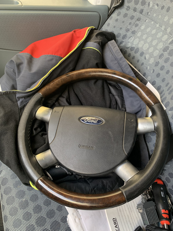

Now I have just bought mk3 Mondeo steering wheel which is my dream for putting it the Transit.
Mechanic said that Mondeo steering wheel have two connectors for airbag and Transit only has one! Is there any way for installing that?
Thanks!
