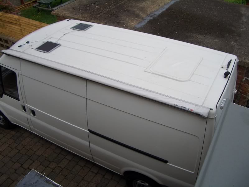

Postby Terry » Fri Aug 18, 2006 9:44 pm
I finally got round to fixing the solar panels on the roof,
then I ran the cables down through a plastic bung in the centre of the roof, then into the reinforcing rib above the overhead shelf, down the nearside 'B' pillar then under the floor (via the fuel filler cavity) to the leisure battery resited under the floor by the sliding door.
I now keep a trolley jack behind the drivers seat, having changed a wheel using the Ford jack ! :shock:
Eventually I will put up a photo of the awning open :lol:

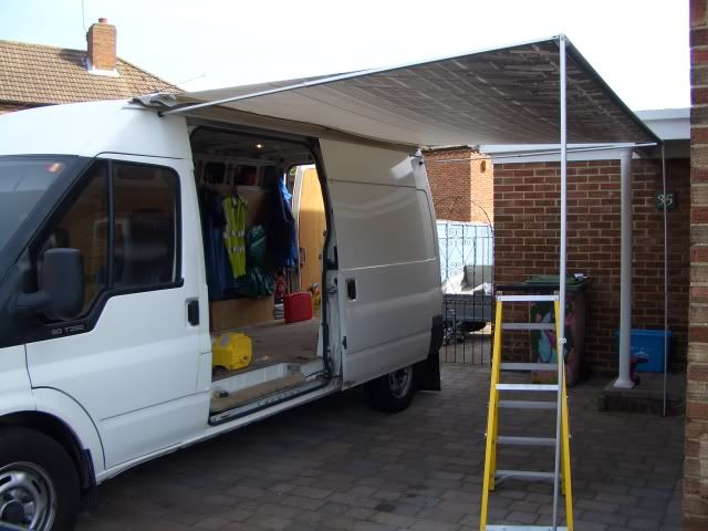

Postby Terry » Sat Sep 09, 2006 11:30 am
Here are the promised awning photos
Needless to say looking from the front, the legs are height adjustable & you do need a ladder to get up to undo it ! (well I do :) )
Looking forward excuse the porch pillar.

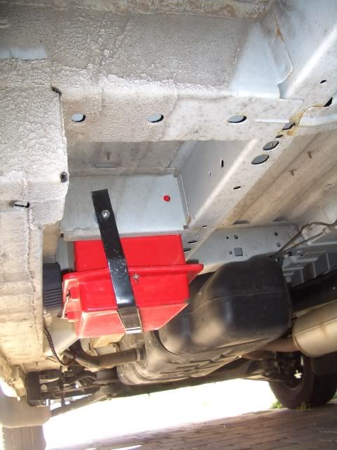

And heres one of the leisure battery under the floor nearside by the sliding door step.
Image.
I have found another slim leisure battery and will move that one & fix it to the trailer to power the winch (fingers crossed)
