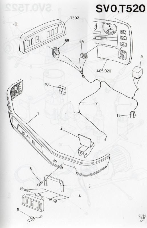

I am trying to fit fogs to my mk3 van. They were fitted originally so got the bumper cutouts etc. Struggling with wiring. Don't suppose you have a VSO wiring diagram with colour codes amongst your archive have you?

Postby metalworker0 » Tue Apr 15, 2025 9:27 pm
Those diagrams, are so clear with lots of details and explain in an instant what you want to know, far better than fords latest offerings.. why cant they do it like that anymore!
all the best.mark

Postby ColinJack » Tue Apr 15, 2025 10:00 pm
metalworker0 wrote:Those diagrams, are so clear with lots of details and explain in an instant what you want to know, far better than fords latest offerings.. why cant they do it like that anymore!
all the best.mark
They are indeed but the previous owner of our van removed the spots and I want to pick up the wires to reconnect them. I need some SVO colour codes for the spots. Where is the relay (9) and the fuse (10) - got the switch on the dash .. found a couple of loose wires under the bonnet (bk/y and br) and (bk and br) .. but no power on them.

Postby MinorMatt » Wed Apr 16, 2025 9:42 am
all the best.mark
The fogs had a standalone harness, the relay was under the bonnet - but I can't remember where

Postby ColinJack » Wed Apr 16, 2025 9:48 am
Thanks Matt - I will have scratch around.
