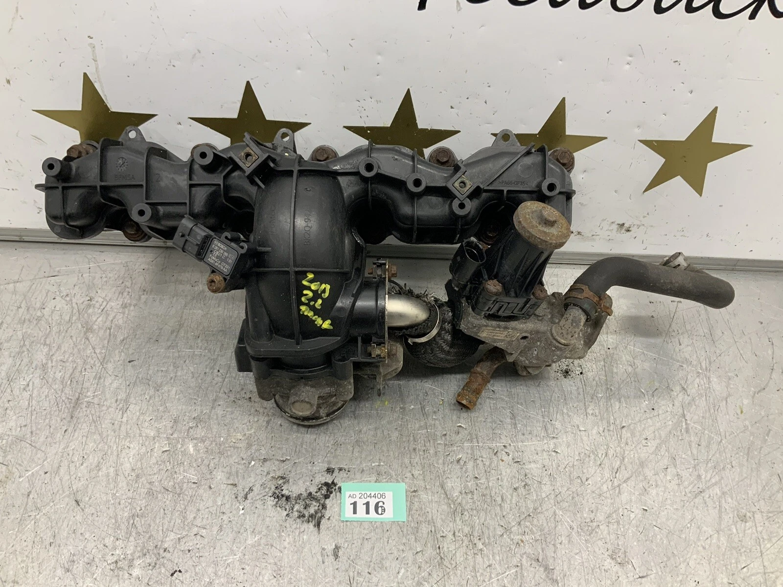

Postby metalworker0 » Thu Sep 11, 2025 10:59 pm
i was assuming you were calling a code reader a computer ..laptop is all you need with forscan from the link above .. plus a cable. perhaps you already have forscan .. i dont know
The egr valve (exhaust gas recirculation valve) is this thing sticking up to the right in the picture
looked for pic of manifold and egr so you'd know what you are seeing .
You never mention euro 4 or 5, so me guessing here
https://i.ebayimg.com/images/g/0WIAAOSw ... l1600.webp
and you'd better know what an EGR does and how it works before you attempt to take apart and clean it or replace.
