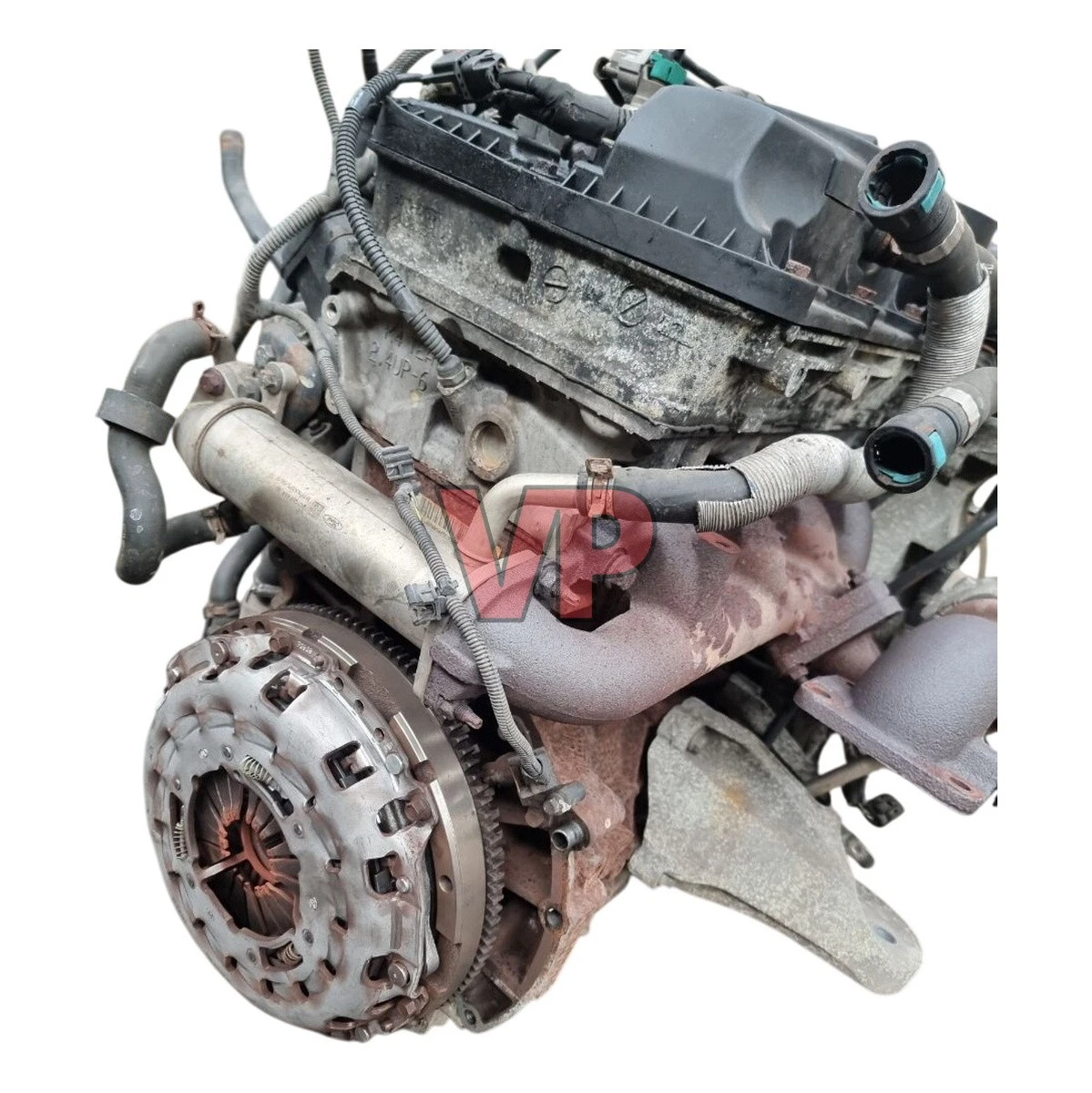

Postby metalworker0 » Tue Sep 23, 2025 4:11 pm
you can see the core plug, right in the centre of the picture here , also couple of hoses that could be the leak
https://i.ebayimg.com/images/g/1I0AAeSw ... l1600.webp
all the best.mark

Postby knobby1 » Tue Sep 23, 2025 8:25 pm
metalworker0 wrote:you can see the core plug, right in the centre of the picture here , also couple of hoses that could be the leak
all the best.mark
Perfect pic of the core plug in the head..! Could also be the EGR cooler leaking...not unheard of.
