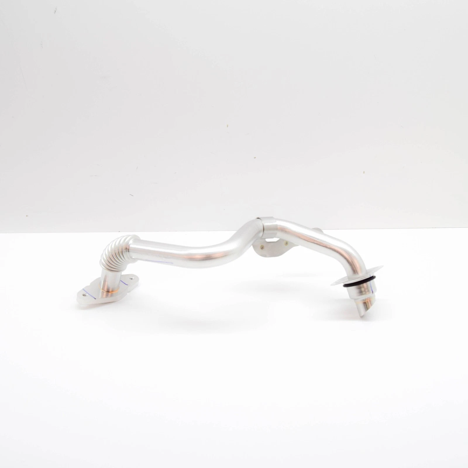

unless you are talking about the "GAS re-circulation tubes .. it has have an o-ring
https://i.ebayimg.com/images/g/~FIAAeSw ... l1600.webp
which isn't given a part number on the diagram
so then you buy the tube with it on or improvise ... heat proof something or other , sorry only thing i could find:
