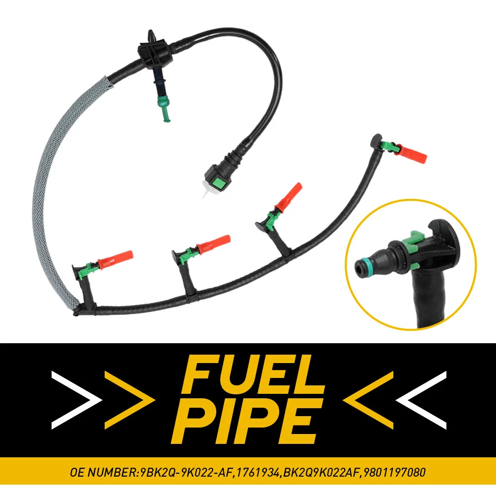

Postby metalworker0 » Tue May 06, 2025 6:49 pm
Do you mean those green coloured fittings and with the rubber pipes?
BTW ..the place where i get the part numbers from has wrongly part numbered the part ...as when i put the number into ebay ..it comes up with injector metal seals that are not the right parts in the parts diagrams
so above is as close an answer that i can give.
all the best.mark
metalworker0
Posts: 6079
Location: Prestatyn
Re: Fuel leak fix
Postby ranso73 » Tue May 06, 2025 6:52 pm
That’s them, it seems that the one with the zip tie fails to maintain the secure seal from the pipe to the injector. TBH, I would rather buy the part to replace the main component at fault.
ranso73
Posts: 11
Joined: Mon Aug 19, 2024 12:26 pm
Re: Fuel leak fix
Postby metalworker0 » Tue May 06, 2025 6:59 pm
You can see in this picture "circled" the problem o-ring.
https://i.ebayimg.com/images/g/oj8AAOSw ... l1600.webp
You can also see you have a choice ..buy just the o-rings or the whole lot.
Cant give you a part number for the o-rings through -- because as explained above .
You are reliant on someone else here, confirming that the link i gave for the o-rings is correct (note its a mk7 ) same engine.
all the best.mark
