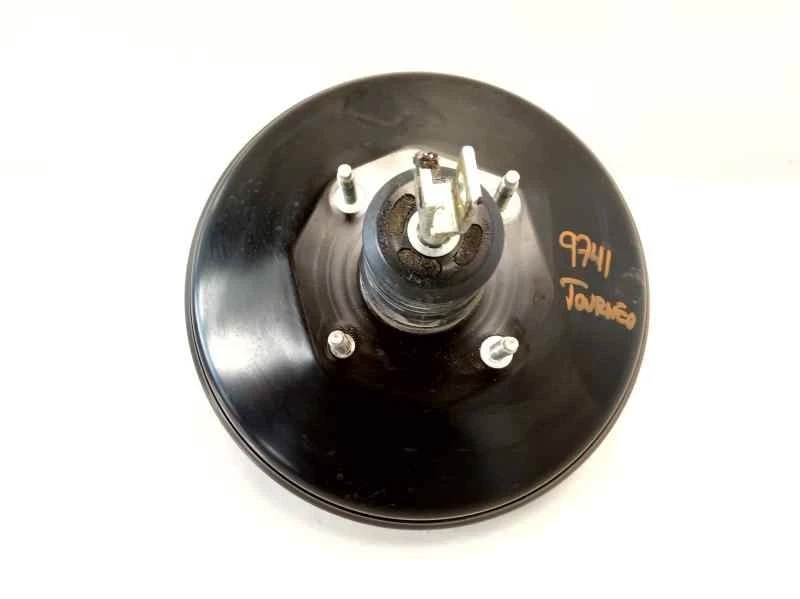

I pulled the rubber bellows off the booster under the dash to see whether the little air filter was blocked on the atmospheric side of the diaphragm. (I realised that, if it was restricting airflow, it could be failing to expel the air again and helping to hold the brakes on for a while after application.)
The filter itself wasn't blocked, as such, but the small foam sponge disc had completely disintegrated! On removing the thousands of tiny bits of sponge, I noticed two things:
1) It no longer wheezed like an asthmatic docker on 80/day when pressing the pedal and
2) the brakes no longer overheated! Hooray!
I was able to throw some basic supplies in and drive, making it to the event for which I'd had tickets all year, just in time. I made several stops along the way to check the situation and there were no further instances of overheating all week.
It just goes to show that the most unlikely and bizarre things can sometimes be the solution!

Postby metalworker0 » Wed Sep 03, 2025 5:51 pm
That's great , i would never have thought about that in a million years -- i will now.
There have been some posters here that have had similar problems, and no ones put this as a solution, in the future that one more suspect to list should they have problems .
you mean this thing at the top of the bellows
https://i.ebayimg.com/images/g/Q14AAeSw ... l1600.webp
whole bellows listed on catcar.info .. wonder if sponge comes with it
if 1994 ----6754691 FORD - not on ebay or anywhere else
91 - 94 - 6754691 also same that's as far back as i can go on catcat.info
another impossible to find item
but later transit servos mk6 and 7 have very similar looking bellows and breather
all the best.mark
metalworker0
Posts: 5969
Location: Prestatyn
Re: Mk3 - weird overheating brake problem
Postby eeedelli » Wed Sep 03, 2025 7:17 pm
Yes - that's it. You can just make out the sponge foam around the rod.
