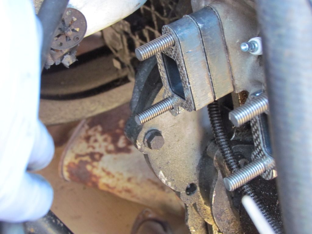

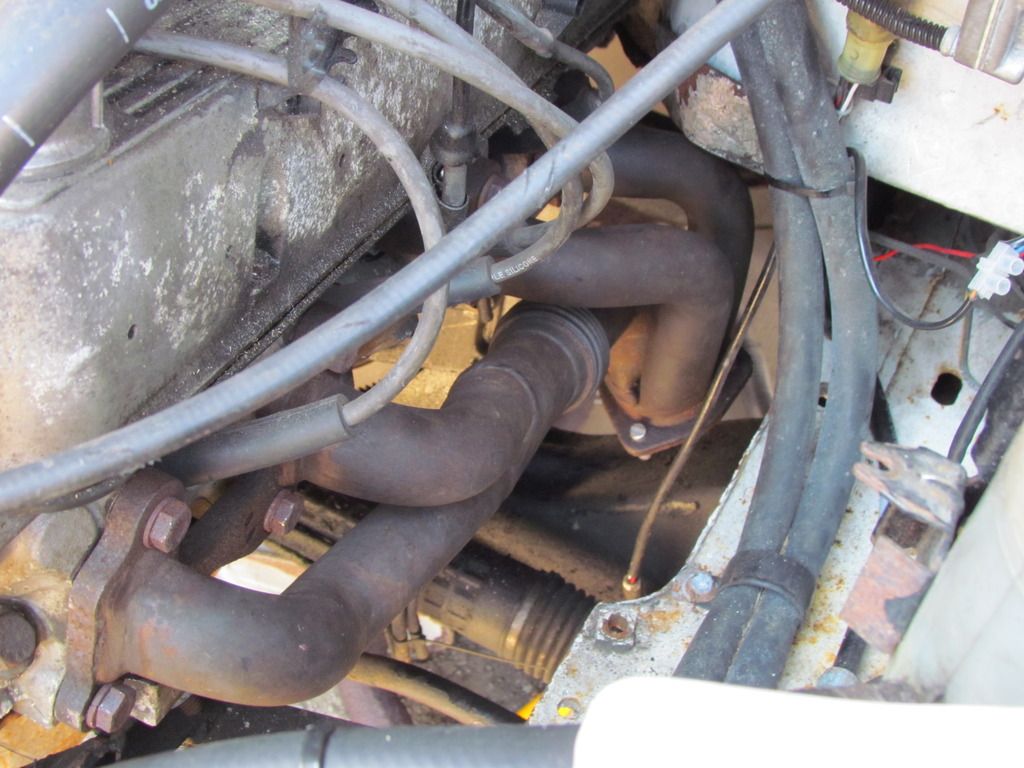

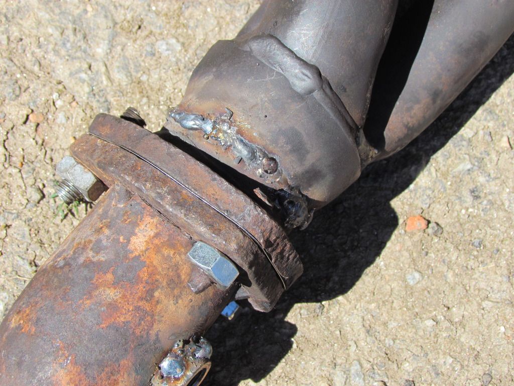

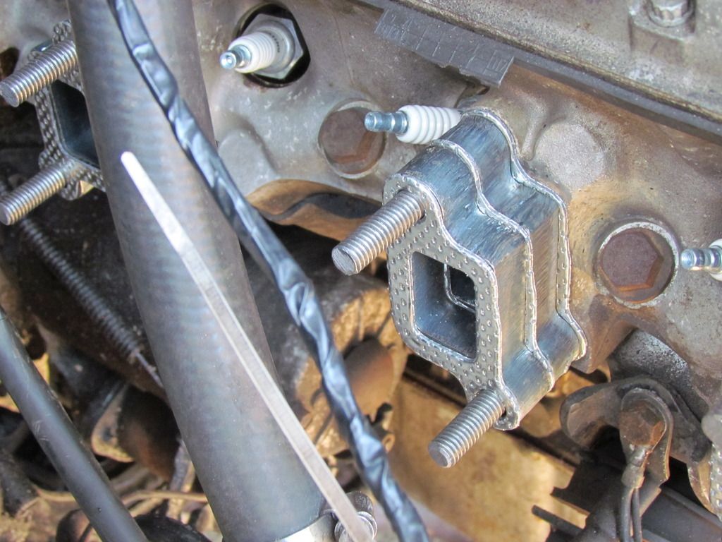

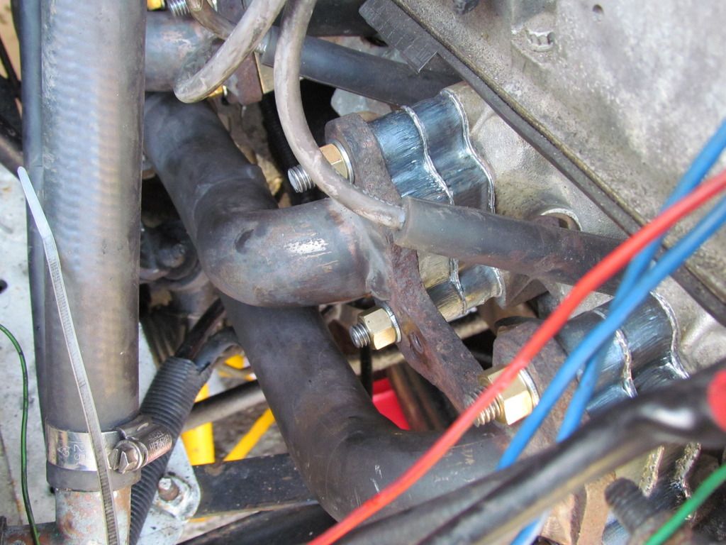

Long time since any updates. The gas system seems to crack the old P6 manifolds, well 3 out of 4 seems a poor ratio. So I have fitted Range Rover P38 tubular manifolds. The passenger side is great fits straight on and has no fouling anywhere. The drivers' side has a few issues... 1. it is longer in its down pipe so this needs to be cut ane rewelded to match the passenger side pipe and 2 it needs spacing out from the head so as to clear the old starter bulge on the bellhousing and adaptor plate. This was done ingeniously by getting some slabs of 15mm steel laser cut in the profile of an exhaust flange. I got 12 cut but only needed 8. Obviously a gasket goes in every gap and long studs were cut instead of bolts.

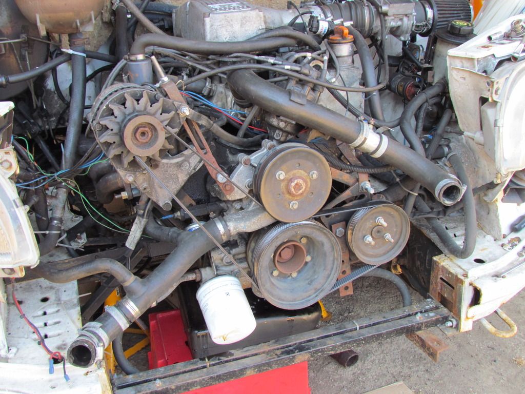

The last pic shows the route of the belt, original Transit steering pump with a Discovery pulley, straight swap. Serpentine engine you will notice has a reverse-spin waterpump!

Good news about the P38 headers, they always looked a good option, (relatively cheap pre-used and an efficient design), your ingenious way of clearing the gearbox is sound and deserves credit!
So a single 30mm spacer, one on each port would suffice to clear the gearbox?

Yes a 30 mm spacer per outlet will do the trick, not sure how the laser boys would be able to cope with 30 mm of steel !... mind you, your water cutting boys may be able to help.... speaking of which, managed to jetwash my thumb the other day, not a good idea, just like a cutter, but healing now.
The down pipes were then blended back into 38mm pipes pointing backward but at least this time along side the gearbox rather than under the crossmember. This should keep the pipes out of the weather and hopefully less hot/cold fatigue. The L P G convertion is fantastic though, starts on gas too, very recommended.
