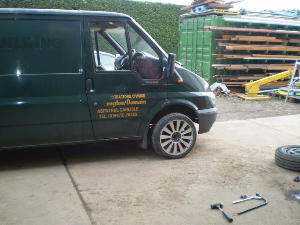

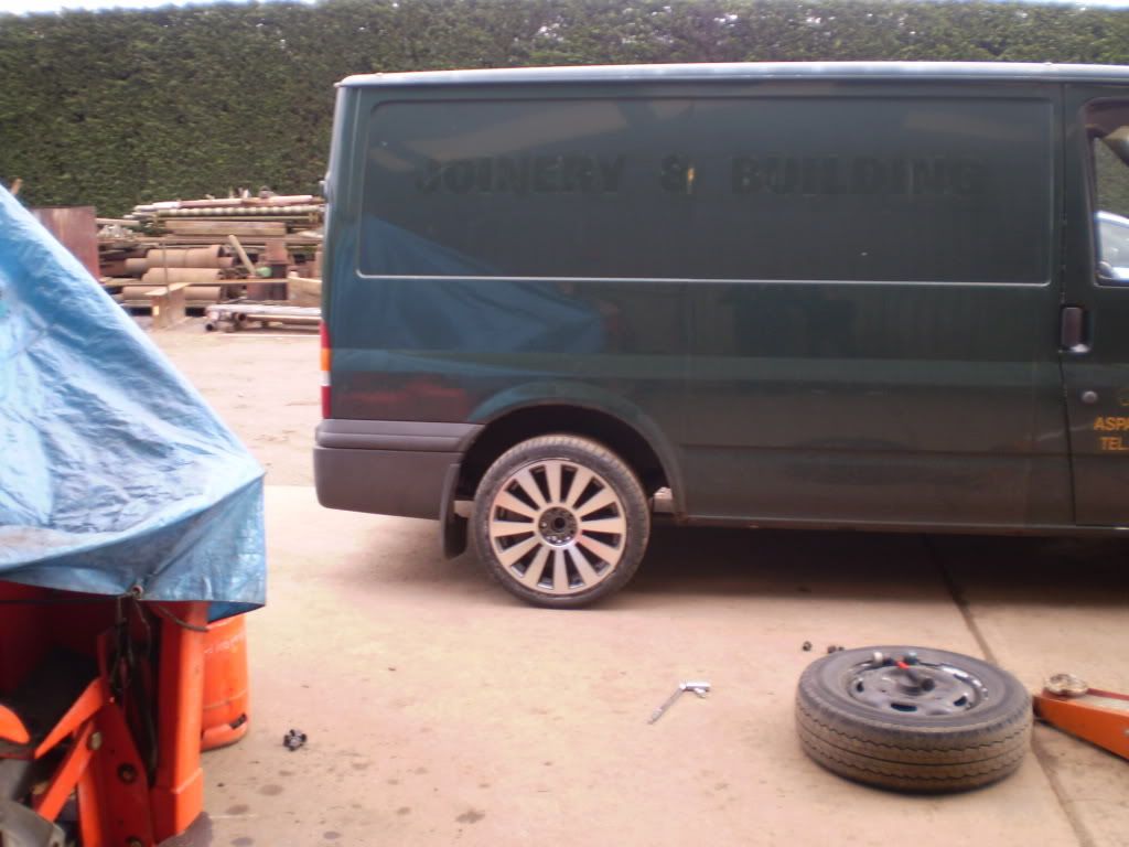

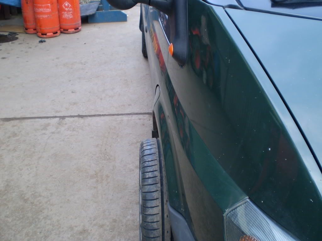

Postby foxy transit » Fri Feb 20, 2009 3:09 pm

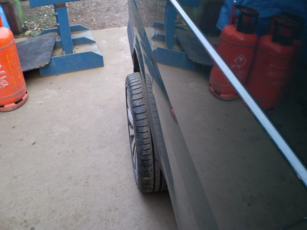

hi guys i need some help got wheels on no problem but they stick 50mm past the arches :x there the r8 vw alloy with a 35mm offset and the adapter plate thickness is 30mm any help would be good. :oops:

Postby foxy transit » Fri Feb 20, 2009 7:31 pm
hi luke i live in carlisle cumbria. they both stick out i will take some pics tomorrow and post but it looks stupid my mate the engineer said make some fancy arches but not for me was wanting them looking factory. the adapter plates he made were maybe to thick but as he says dont want to compromise taking loads of them and they not being safe. we have looked into redrilling the backs look easy but have been told the fronts cant be done so unless anyone knows different please tell me :) also i can change wheels to 45 offset which will bring them in 10mm but they will still stick out 45mm so dont know what to do :?

Postby foxy transit » Fri Feb 20, 2009 8:00 pm
yes luke its 50mm each wheel so yes your right the different offset will make it 40mm still sticking past the arch. i will post pics tomorrow off the adapter plate and one wheel on just to show you. my mate was going to make a new hub rather than redrill for front but there is 10 holes on hub that cant be blocked and stopping the 112 pcd i need :evil: i going to concentrate on getting it all painted and looking mint but will defo post some pics over the weekend so you can see how sh*t it looks now ha ha

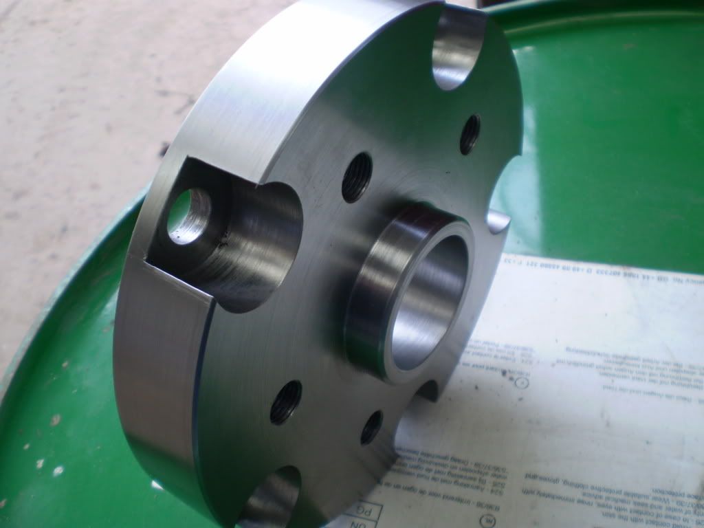

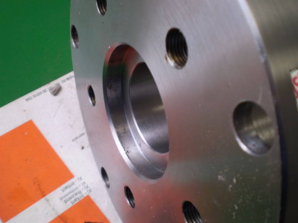

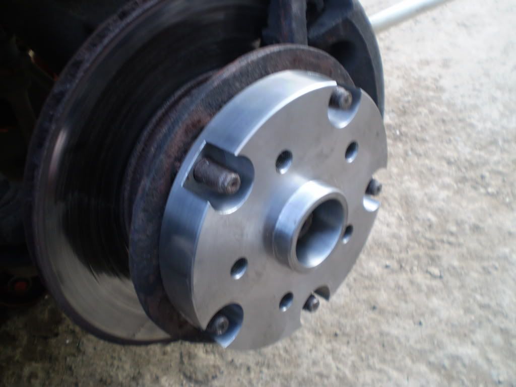

Postby foxy transit » Thu Feb 26, 2009 1:04 pm
thats the pics guys was not sure how to load them on here so just put a link :oops:

Postby pollag » Thu Feb 26, 2009 1:56 pm
Now we know it can be done . Good job!

Postby foxy transit » Thu Feb 26, 2009 5:54 pm
well thats the wheels on van. since i seen they stick out i got fed up and sold wheels just going to paint my steel wheels black against black bodywork i think to fit vw wheels to a mk6 you need to put wide arches on or buy a lot bigger offset. but anyone wanting adapter plates made for any transit just give me a shout thanks and will keep you updated with the rest of the van and more pics soon :D
