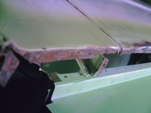

This week all i have done is , i welded the panel i fabricated to the imitation panel ( i spot welded them together,overlap them )
and gave it a lick of paint from the inner side where i can't reach after welding it in place.

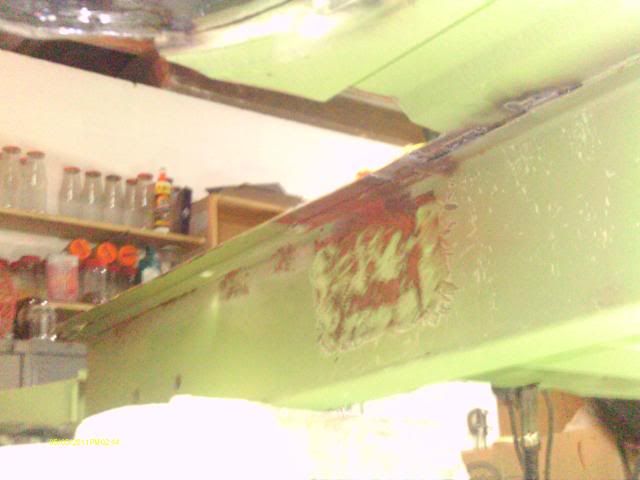

Today i bought a litter of RUST REMOVER and applied it to here, on the edge of this panel,
It works magic,as i applied it by brush, the liquid eliminates all the brown rust and a shinny metal stip appeared. after wiped it with a wet cloth ( as dirrections ) i painted it to protect it.

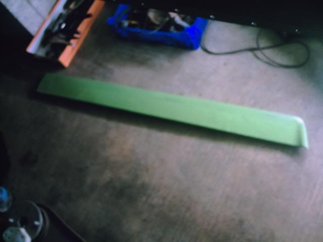

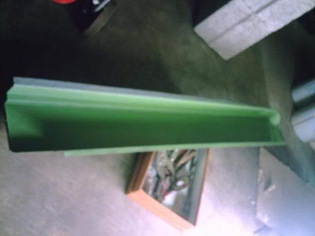

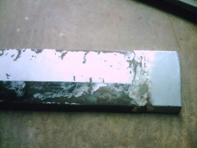

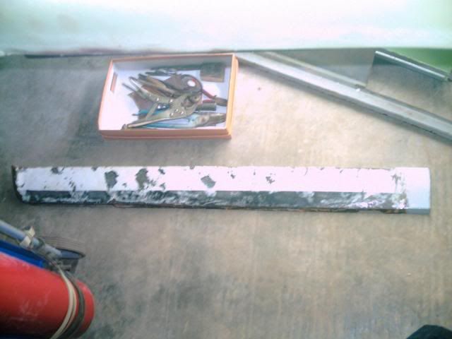

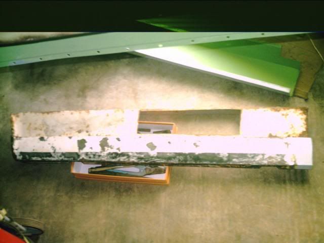

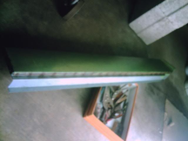

A new lower panel i could not find here, so a trip to my friend Karmnu found myself a second hand one. It had some rust patches and the very end was very bad, so after i sepperated the lower part from the upper part i cut away the rusty 3inches and welded a new fresh metal.
Then i sanded of the offending rusty parts and cleaned it with rust remover,then i brush painted it temporary.

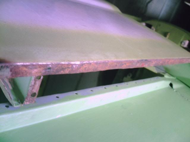

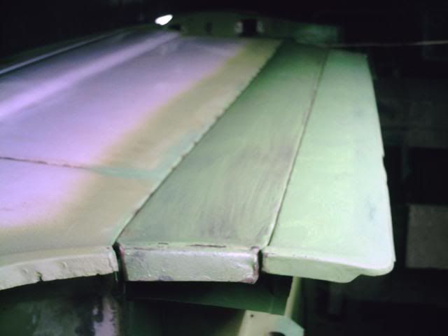

Postby malta transit » Fri Oct 15, 2010 10:42 pm

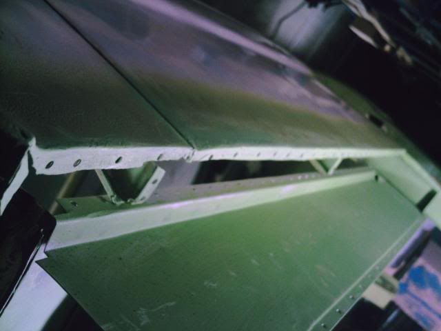

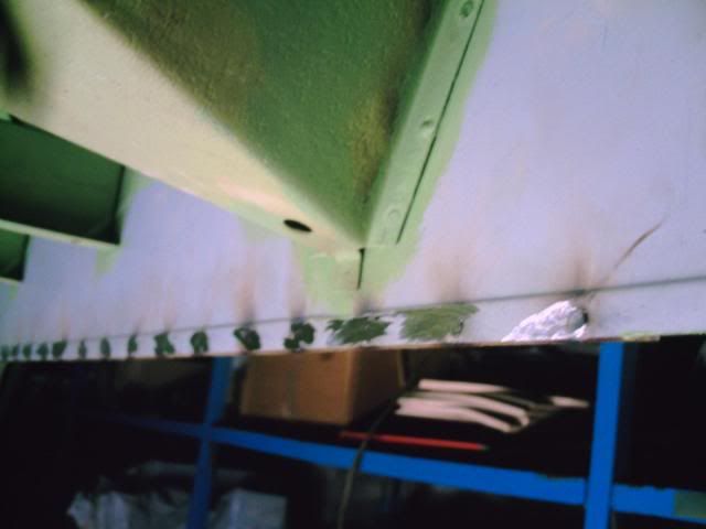

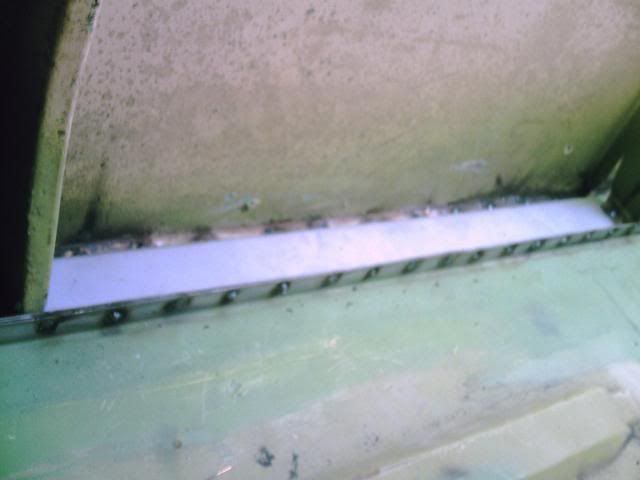

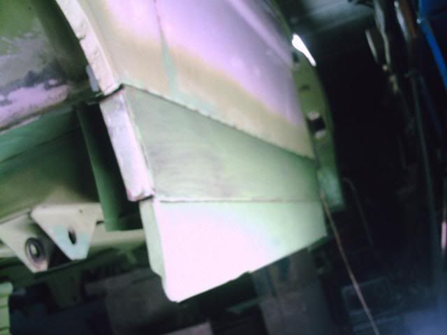

These two weeks since my last post were a nightmare. As i have never done the outer parts were they are visible. The middle imitation panel was not perfect,the edge were it meets the wheel arch don't match. And the panel is slightly concave. But i have done my best.

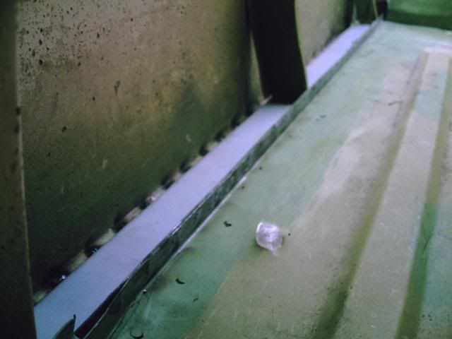

First i have spot welded the middle panel at the top edge from the inside,through the holes i had punched with my joddler. I was advised always start from the middle,then outwards so you don't have bump warps.Then i welded the edges of the middle panel with that against of the floor panel.
Then i linished flat the spot welds against the floor only as the ones in the cannal i could not get to them. Then i also painted them not to rust.
When the middle top panel was done and strong, i spot weled the lower edge to the new flat panel i had made.
Then i linished the spot welds with a grinder.

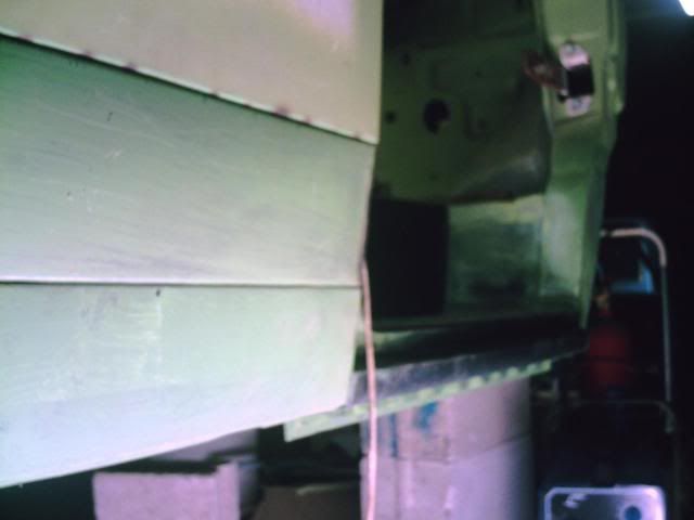

This is how it looked from the outside.

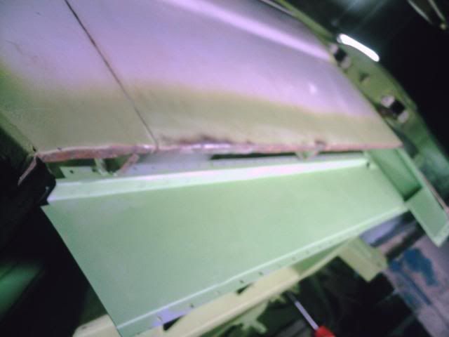

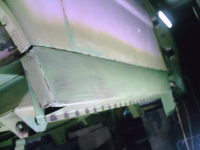

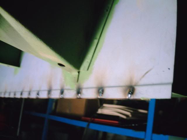

Then i tacked welded through the holes i had made the last lower panel from beneath.
This is how it looks from the outside.
Lastly i linished the welds and painted the welds.

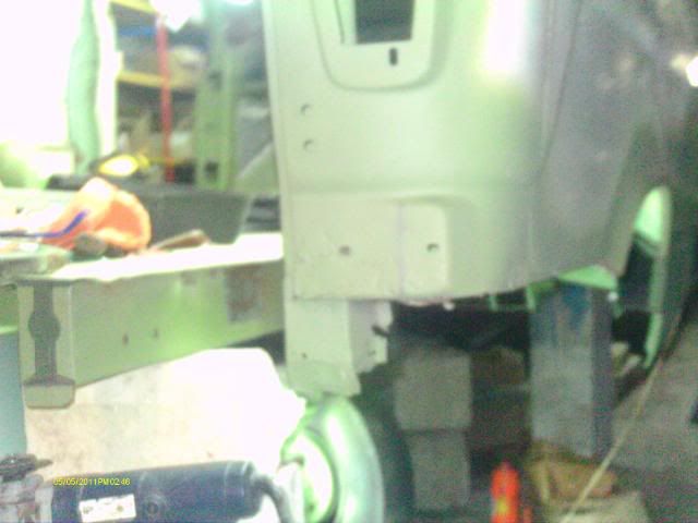

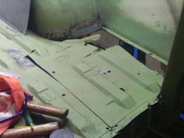

Postby malta transit » Thu May 05, 2011 2:25 pm
Its been 8 months since i v done something on my van, but at least i got my muse back.

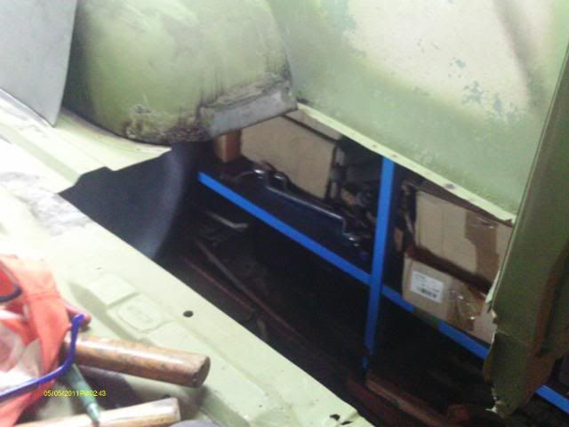

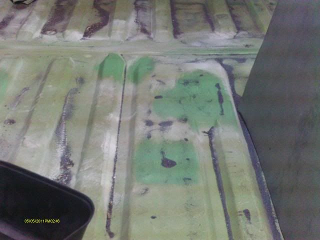

I started by welding up the small drilled holes on the loading floor which were useless for me.

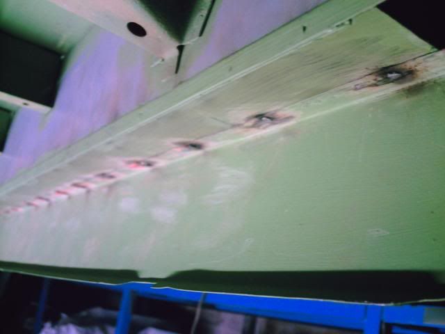

Then after thinking how am i going to cut the small rusty holes, i decided to cut a big section :shock: so i cut big.

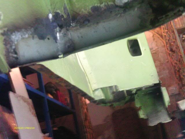

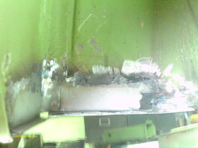

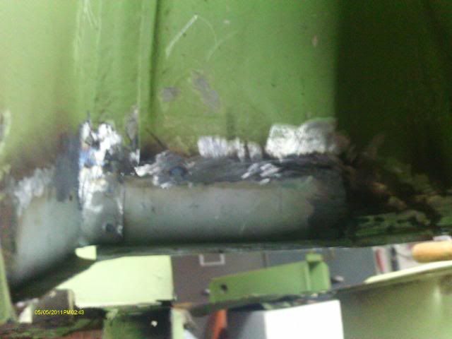

Then i had a bit of work to remove the out rigger to make a good copy for both sides,

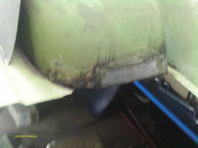

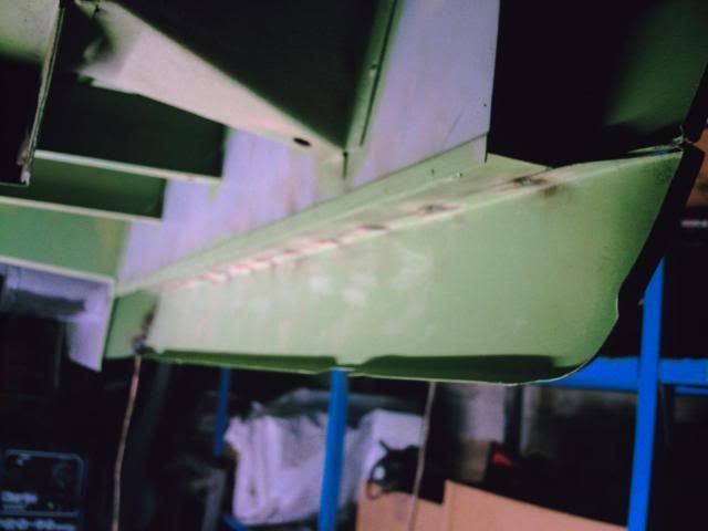

As i had the back corner removed , i patched up the bottom part of the rear wheel arch.

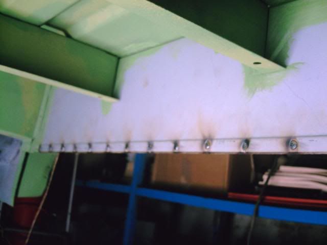

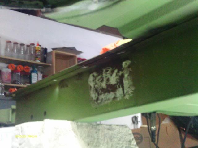

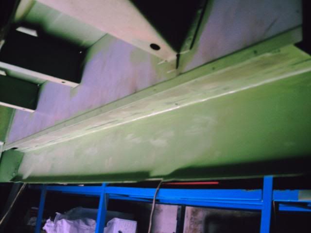

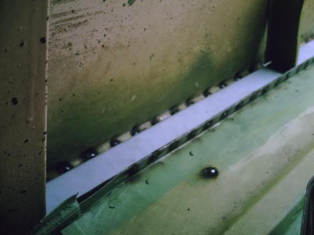

From inside :
From beneath :

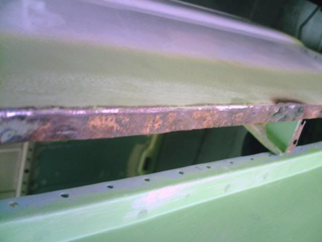

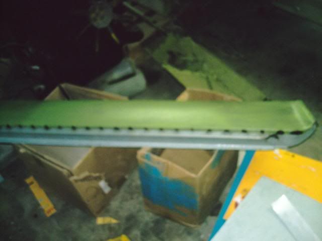

Then i cut off the rear botom panel and cleaned of the remaing metal;

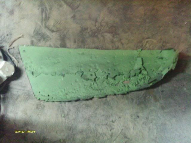

This is how it looks at the moment,
After i will fill up and smoth the wheel arches with filler ,were i v welded i will cut up these two rectangular molds and weld them on the new metal.
