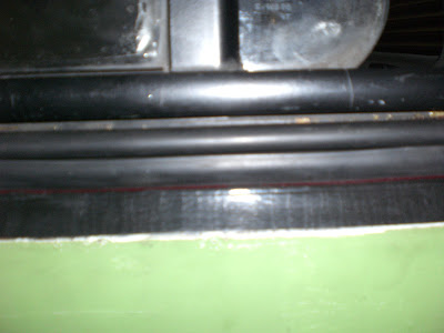

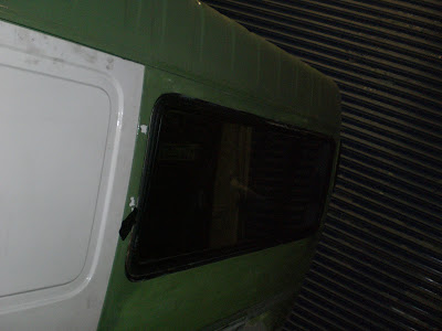

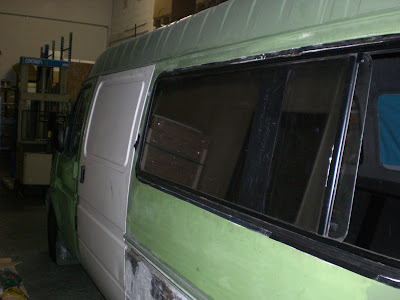

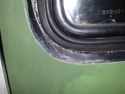

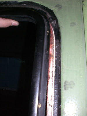

Postby Nadjenka » Thu Aug 13, 2009 9:16 pm
For believers and non believers - here is second serious attempt to get the windows in. :roll: I have enlarged the hole for about 2mm at places where it seemed too small and used my new magic wand to get the window in. I'm liking it already 8)
Now it still is a bit tight at places, I would be unable to put the locking piece of rubber in there... :cry:
I'd think this is probably too tight here :?
You are looking at the window itself next (or on top of) the lip. :roll: So back to cutting... Let's just hope I won't make it into cabriolet soon... :roll: :roll:
