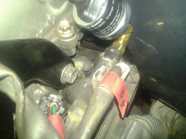

my fuel pressure gauge has turned up today 8) 8) but unfortunately the adapter bolt to fit it to the fuel rail hasn't :roll: :( :(

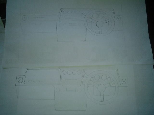

in other progress i started to make a new dash the other day- back to the top design. the problem was i was running wires to temparary positions so i wanted the dash in the final position so i can neaten up the wiring

the adapter bolt arrived
i trial fitted it but the sender is a lot bigger than i thought it would be and it fouls the bulkhead :roll: so ive ordered a 45deg adapter and hopefully that will allow it to fit :) the whole assembly is a lot closer to the bulkhead than i would have liked - if i can get a 1/8"npt banjo with a long stem on it i will swap it over and relocate the sender i the future - but once it's running i'll keep an eye on it :D

Postby Luke » Wed Jul 02, 2014 10:24 pm
no its the right part (even ordered it specially from usa) - it's to tap into the fuel rail to fit a fuel pressure gauge - it it was still in a supra it'd be ideal - its just that transit bulkhead thats in the way :lol:

Postby Luke » Thu Jul 03, 2014 8:40 pm
got it all fitted and running - not on the road as i didnt have time to put all the charge cooler back on
ran at 36psi on tickover and rose to 40psi when i revved it - not sure what it should be :?
here's the fittings it's about 1/2" off the bulkhead :|
next i'll take it for a run and see if the fuel cut is coming in too early :idea:
