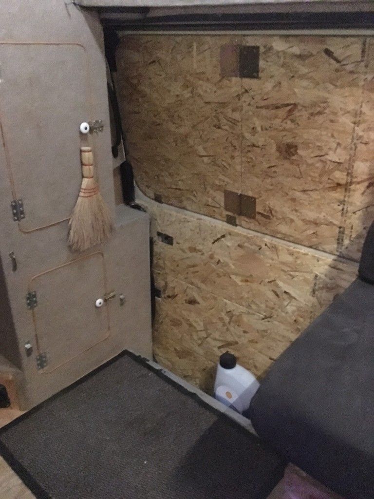

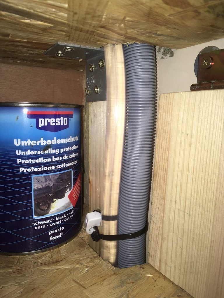

Postby axxez » Wed Oct 26, 2016 10:19 pm

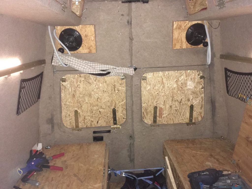

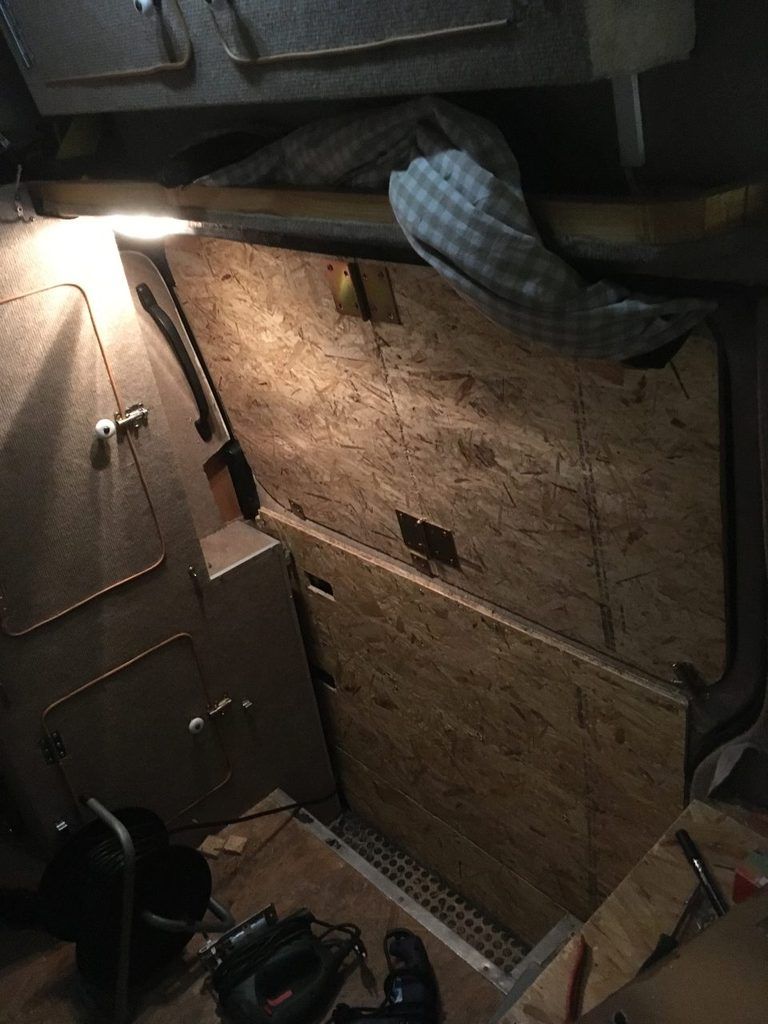

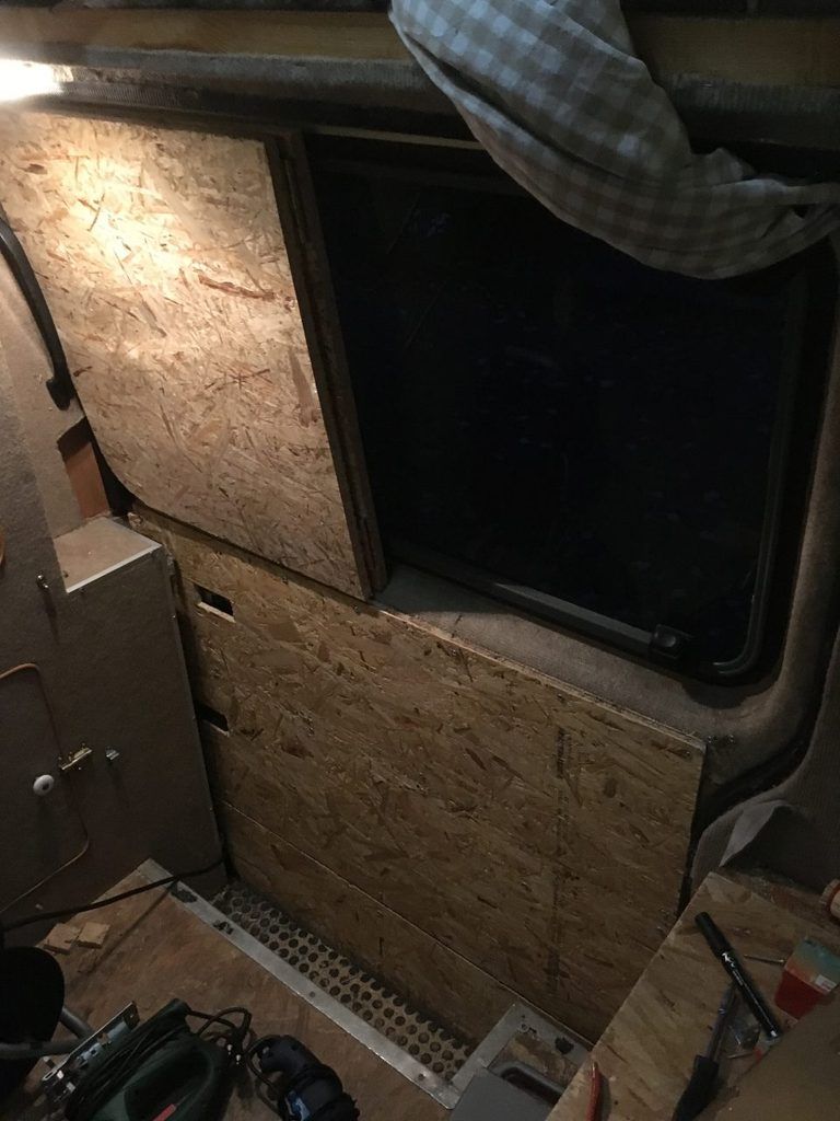

Those days I took care about the security and insulation of the van. Not finished yet, as the OSB will get painted and I will put some styrodur on the plates, but it works as designed :)

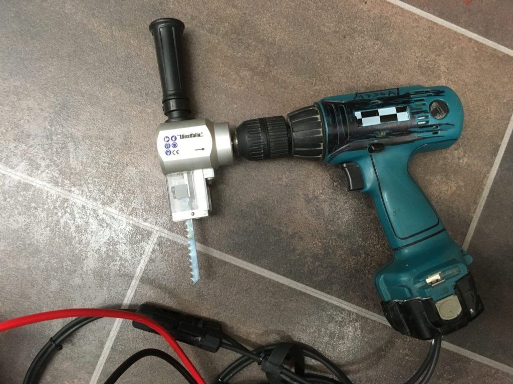

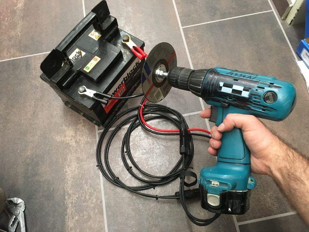

A little offtopic, but here is my 4-in-1 tool for on the road:
1. Drill
2. Angle Grinder
3. Jigsaw
4. Nibbler (when handle is bolted over the jigsaw, so the tool is flipped upside down)
Of course running on 12V battery :D
I actually build my whole van with only those 3 electric devices, although I used 220V tools.
If anyone is interested in this Westfalia tool:
https://www.westfalia.de/shops/werkzeug/saegen/stichsaegen/stichsaegen_zubehoer/1430232-westfalia-blechknabber-und-stichsaege-vorsatz.htm?art_nr=853370&gclid=CJThyqjmztACFckaGwodimkISg&utm_medium=1.+SEA&utm_source=Google%C2%A0Adwords+WWC+Produktdaten+DE%C2%A0%C2%A0%C2%A0%C2%A0%C2%A0%C2%A0%C2%A0&utm_campaign=Google%C2%A0Adwords+WWC+Produktdaten+DE%C2%A0%C2%A0%C2%A0%C2%A0%C2%A0%C2%A0%C2%A0

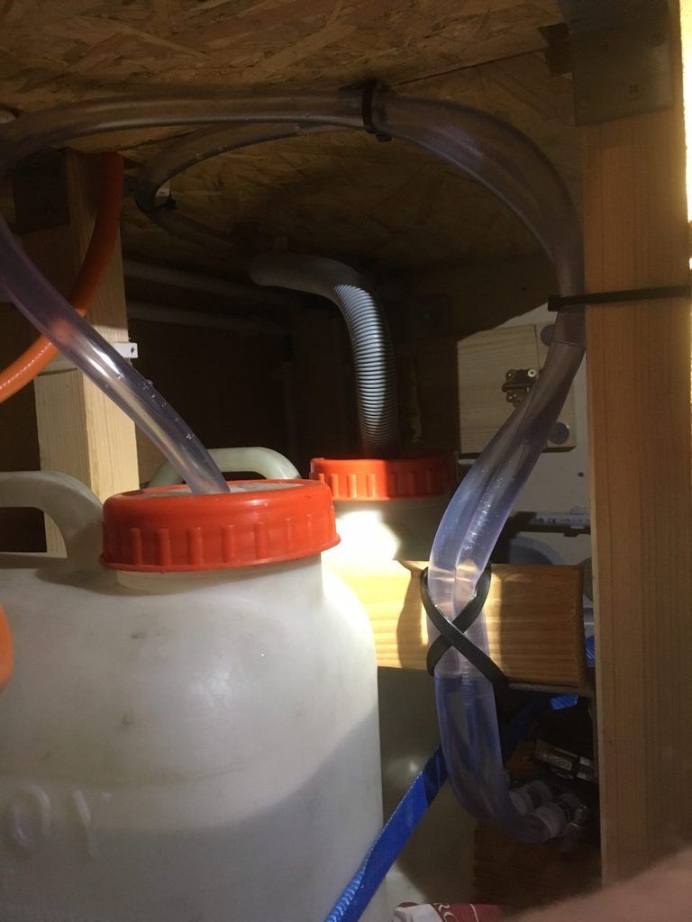

Postby axxez » Wed Dec 14, 2016 12:24 am

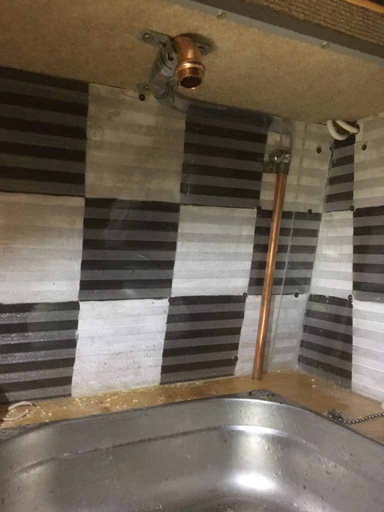

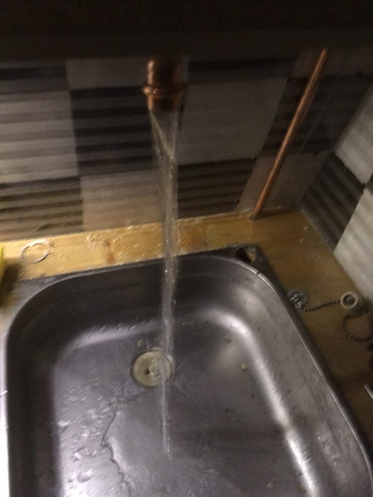

I got f*** tired of constantly destroyed electrical pumps and weak plastic mixing taps. After some research I found a mechanical foot-pump that works absolutely great! Not cheap for what you get in the end, but it's solid and nice. With a short bit of practise it's easy to create nearly constant water flow in the desired quantity.
Stupid idea: Maybe it is possible to get hot water by putting a candle next to the copper-pipe :D
Here are the pics:

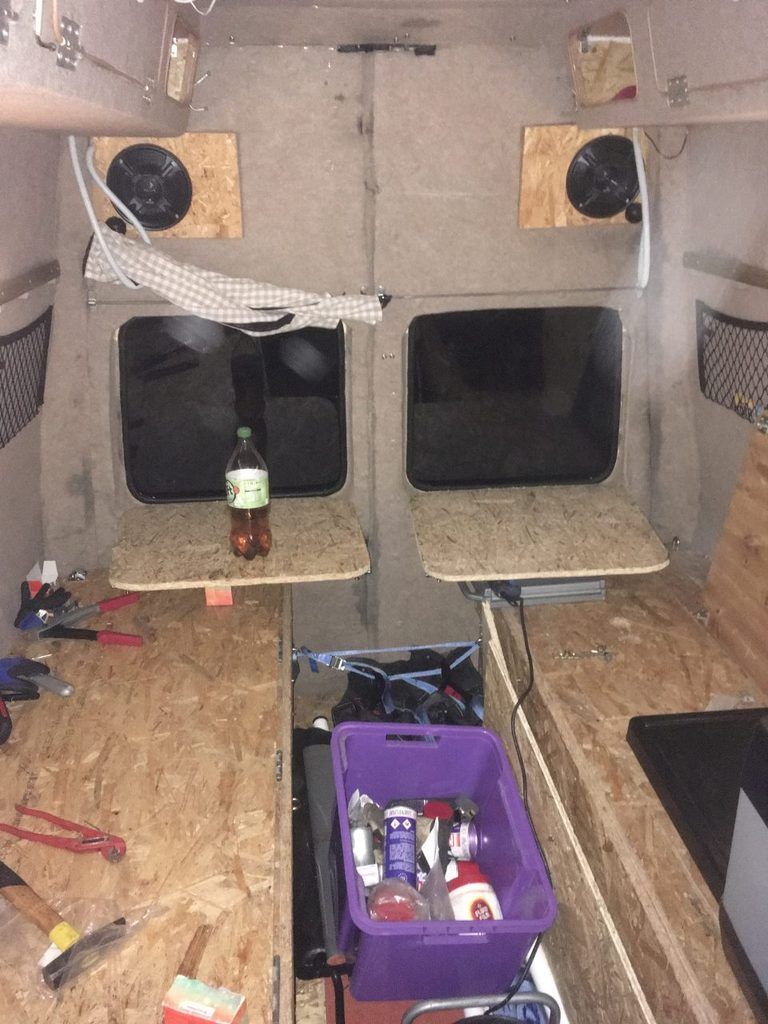

Postby axxez » Wed Dec 14, 2016 11:50 pm

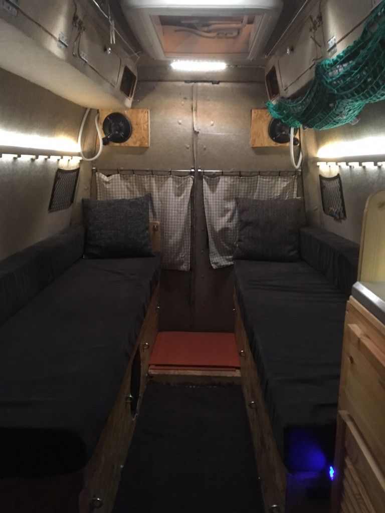

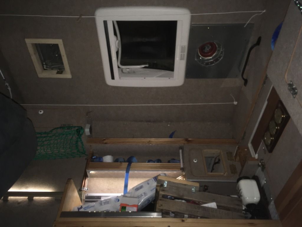

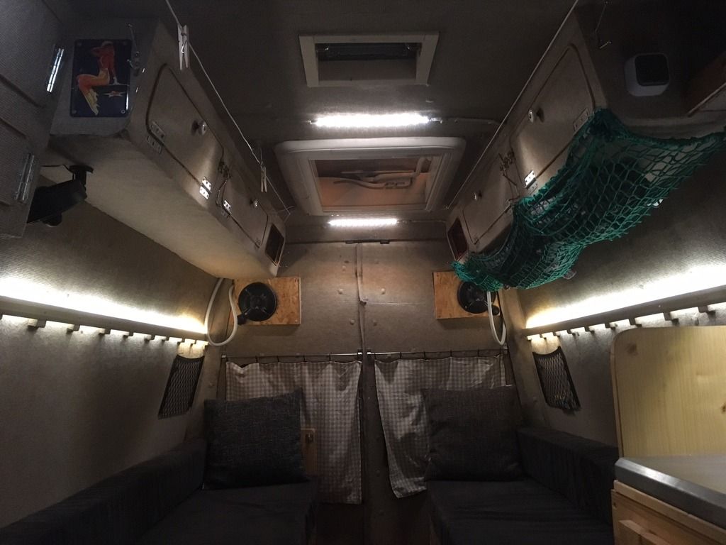

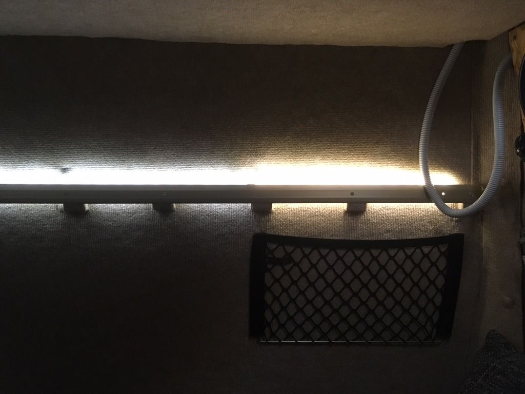

Cleaned up a little and made my van ready for a trip. So here is what it looks like when I travel. I will put another net to the left side. It is a solution for the annoying bed-sheets that did't find their space all the time.
I finally extended the led-stripes, what I planned for a long time. First I bought the wrong leds (24v instead of 12v) and now I just bought "warm white", as the rest of the stripes are "cold white". I decided that this was on purpose and for making the van unique, not by mistake.

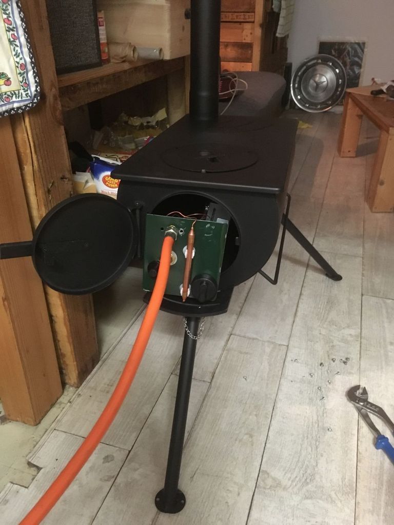

Postby axxez » Fri Jan 27, 2017 1:52 pm

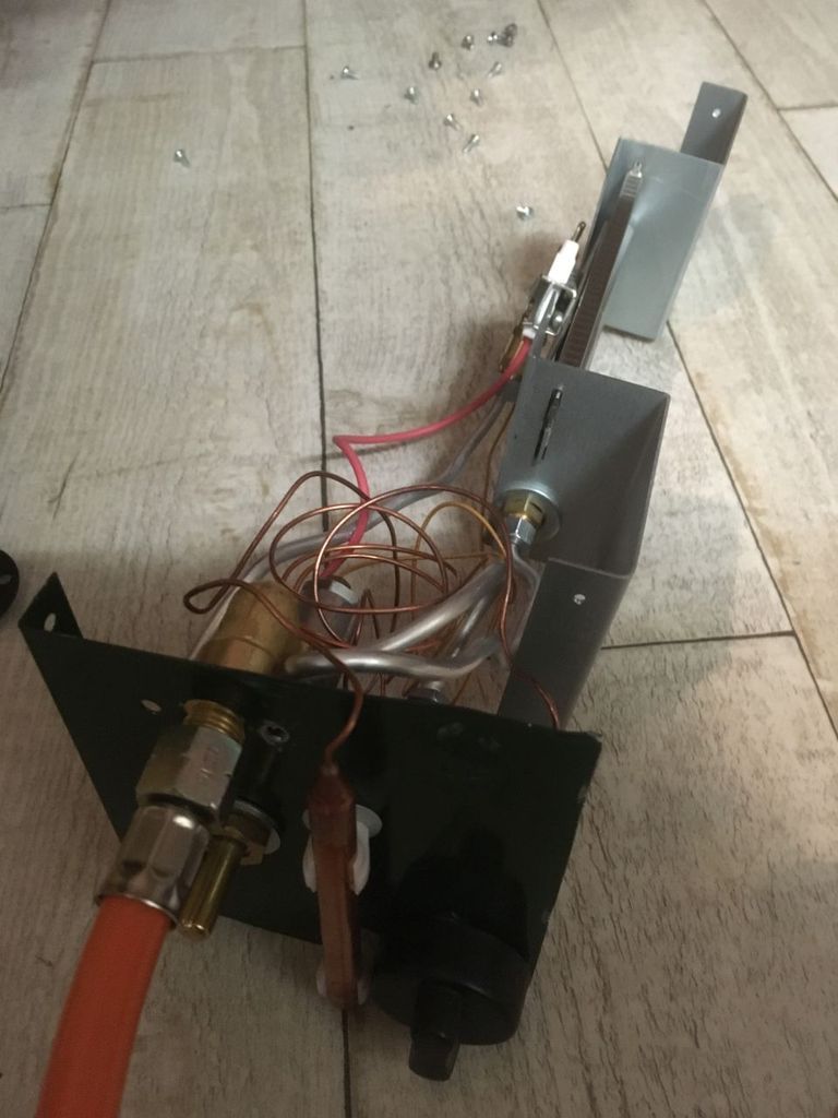

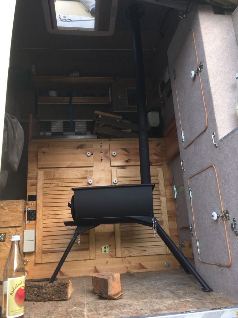

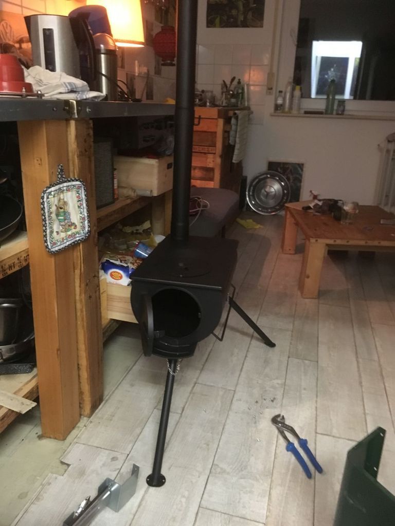

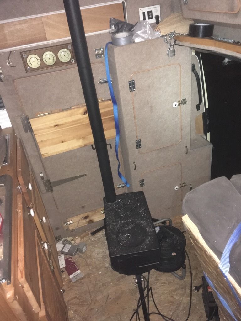

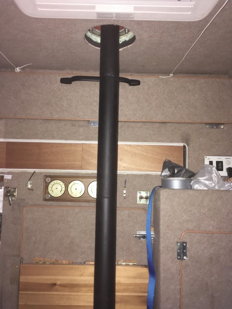

So... For the heating I needed an oven. I built one, which was in the pictures some pages earlier but this one didn't work proper and had some problems. So finally I went for a tent-stove made in England :)

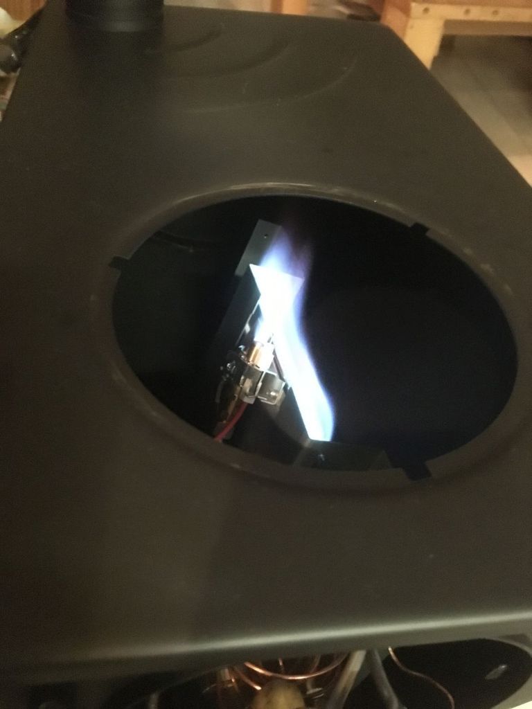

For redundancy or better, a backup I bought a gas-stove for outdoor use and modified it to fit into the tent-stove. Works nice in my testing environment. The deadly fumes are going where they should: through the stove-pipe.
I hope I will survive my crazy ideas... Of course it won't be used during sleep!

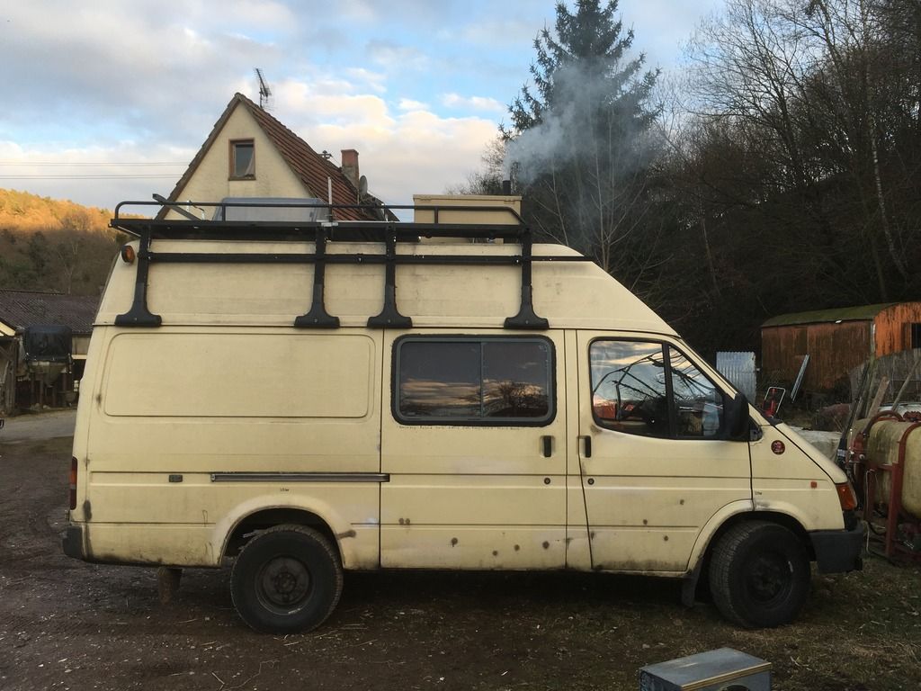

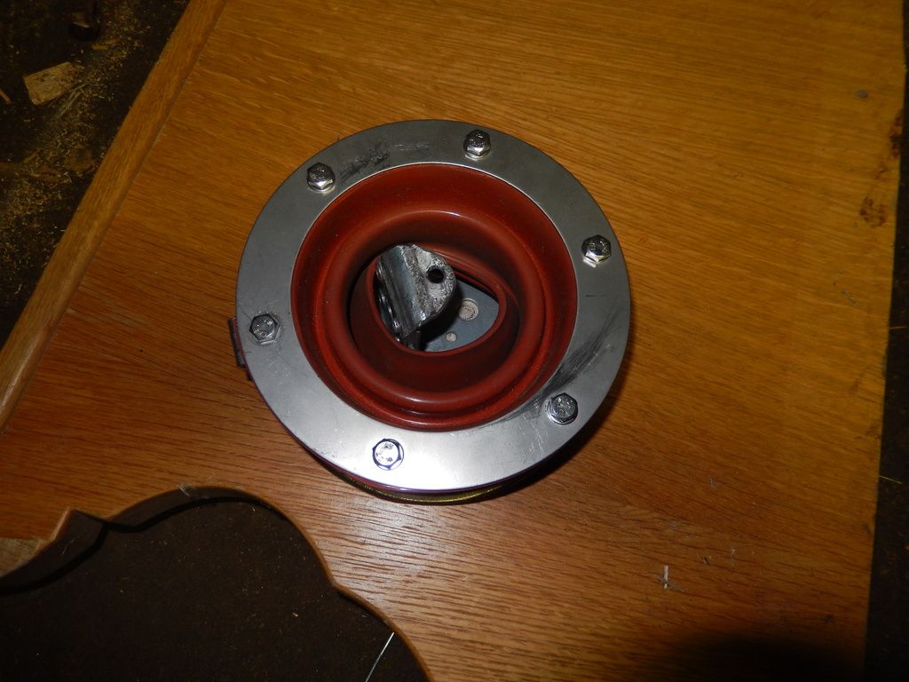

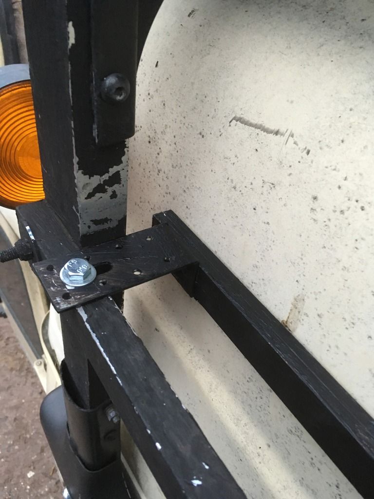

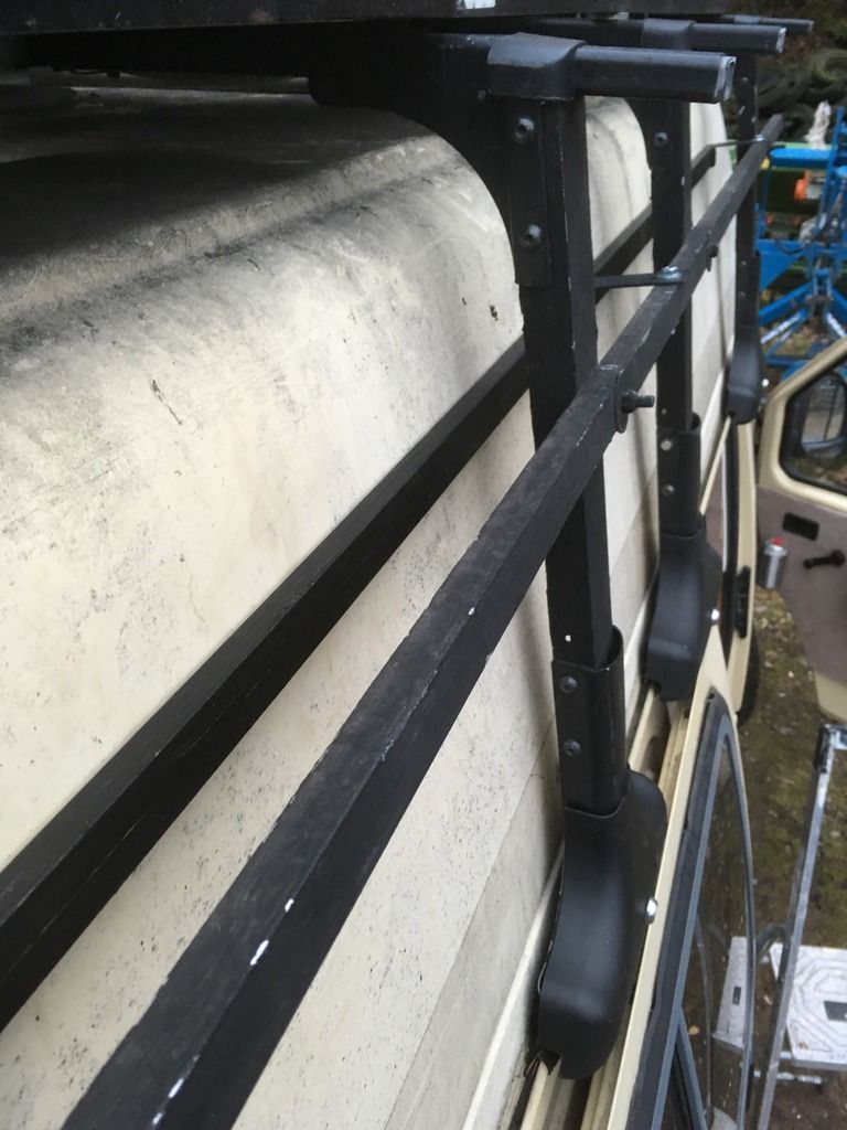

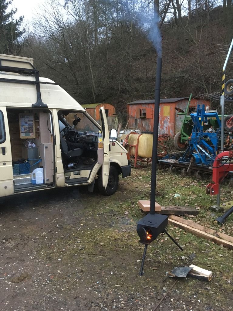

Worked on the car again today. As the roof-rack tends to move from left to right, thanks to the big height, I installed some extra aluminium rails. Most roof-racks that you can buy for high roofs do have punctual brackets, for which I would fear they might destroy the plastic roof. I hope it works with those rails, although the load might be also a bit punctual around the mounting-points. But let's see, it feels right and the rack is nearly not moving at all anymore.

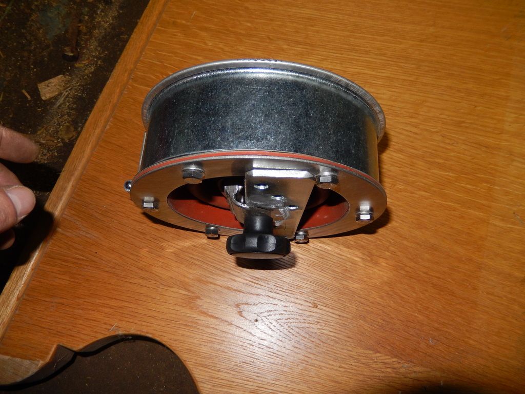

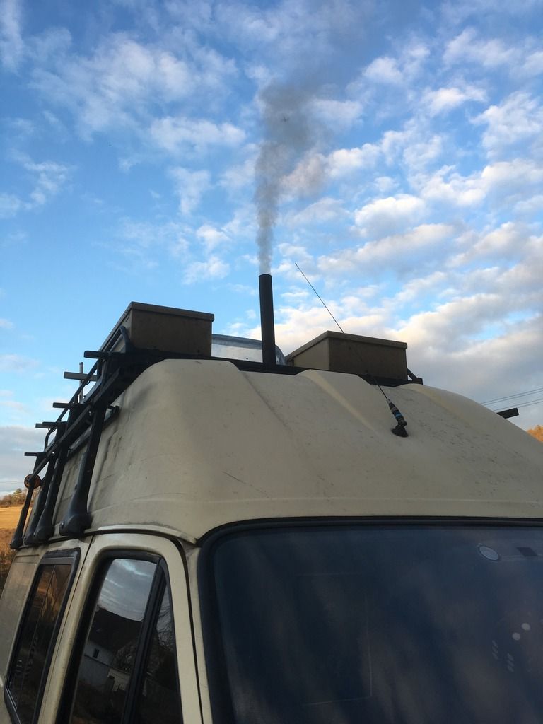

I also fired up my new oven for the first time with wood. Works great!!! The heat around the pipes is decent and the fire burns well without smoke going in the wrong direction (when the door is closed). The duct which is originally made for tents got a little bit modified by me, so it should / will work great on the roof of my car. Maybe I can find time to install it tomorrow.

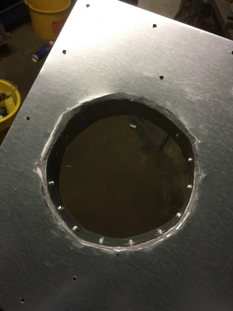

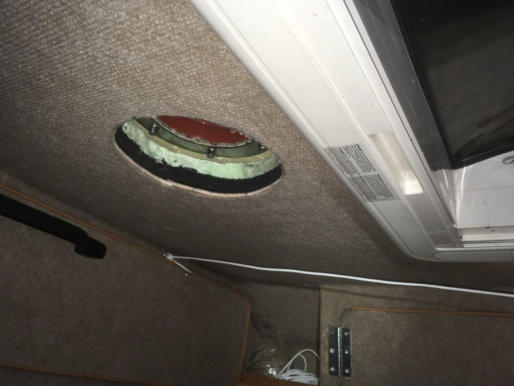

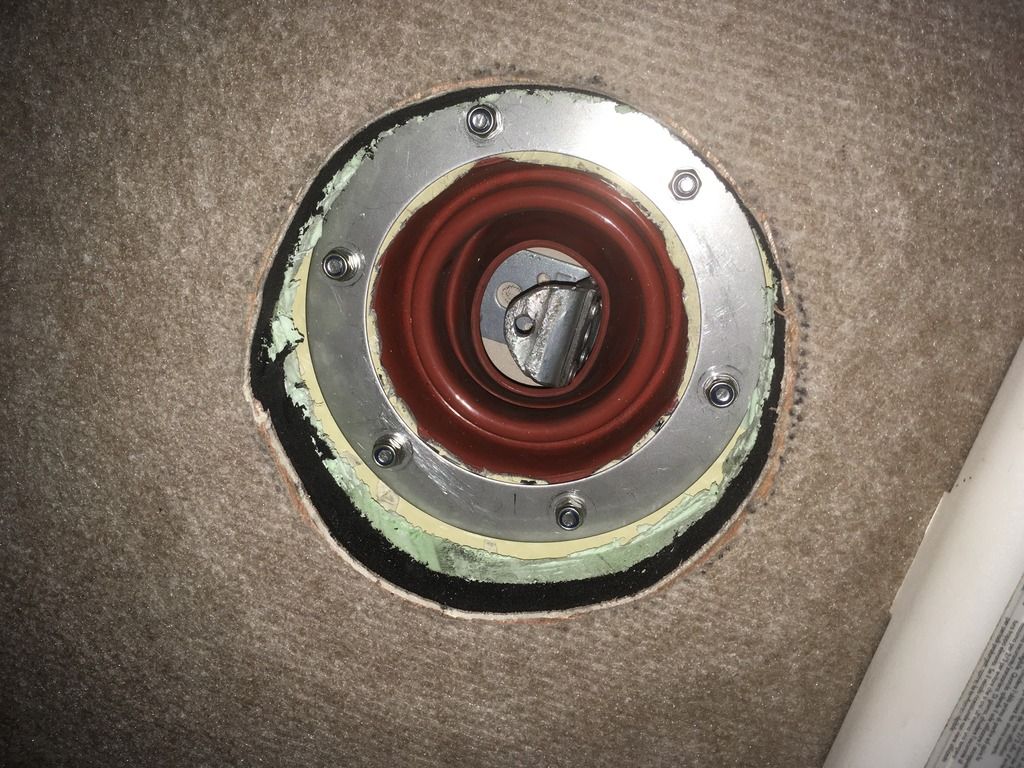

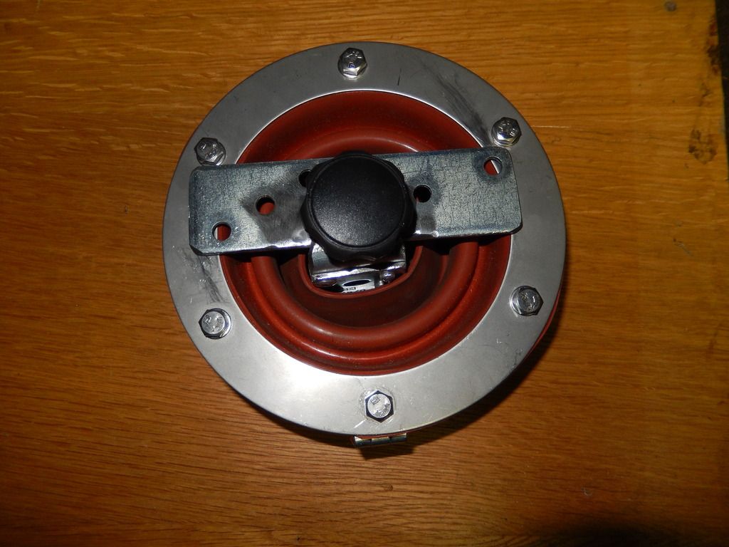

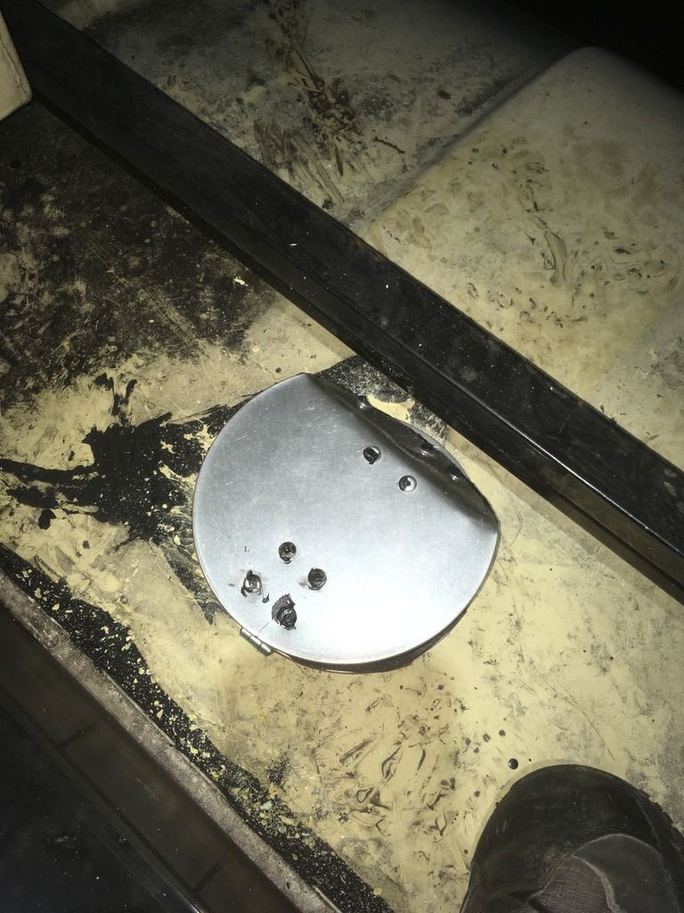

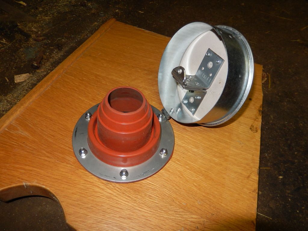

Postby axxez » Tue Feb 21, 2017 9:12 am

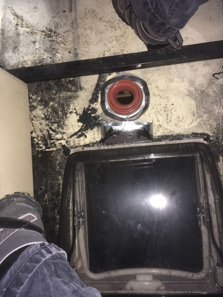

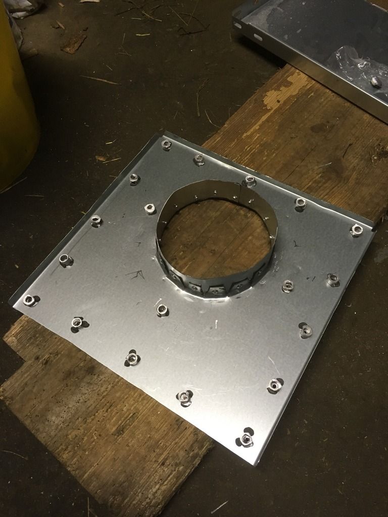

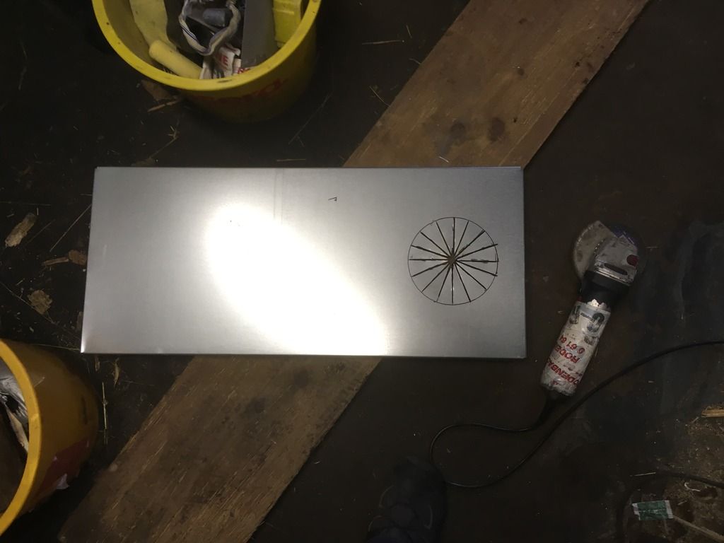

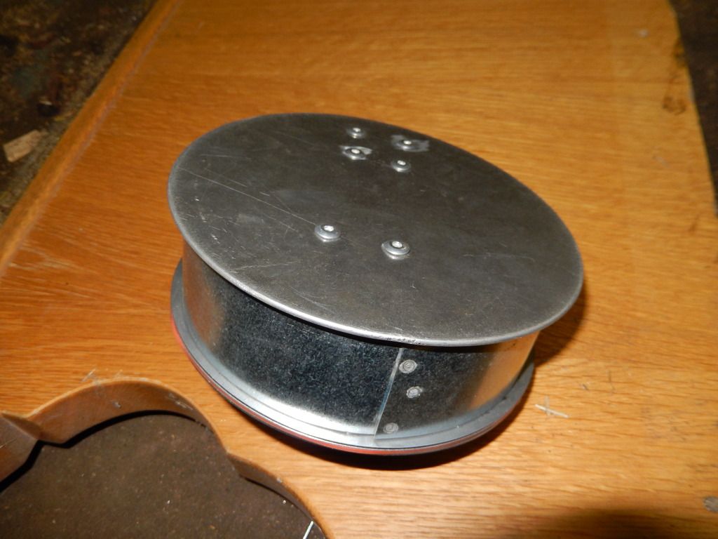

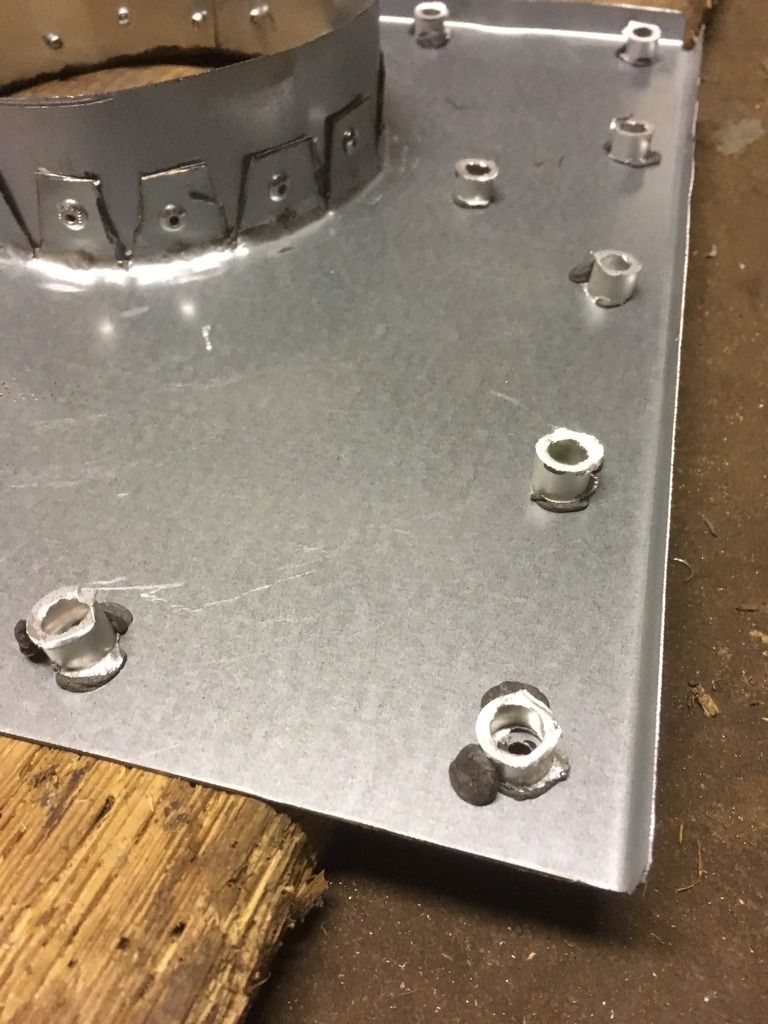

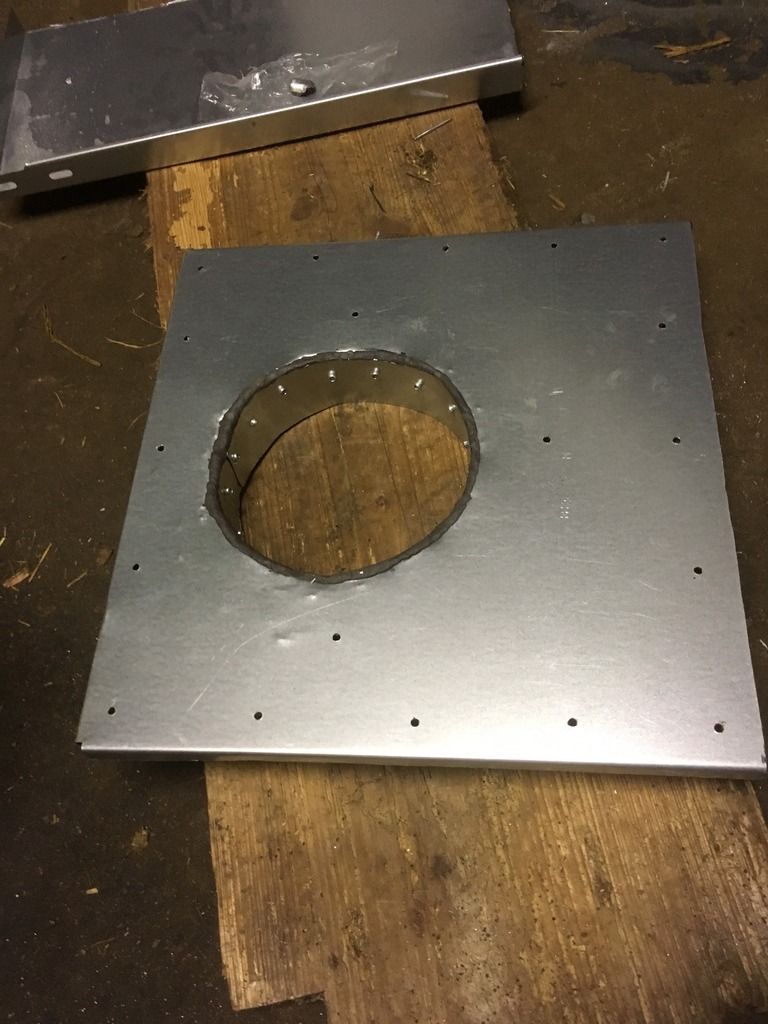

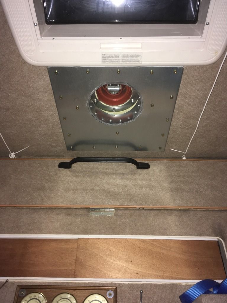

Theory vs. practice... Looked like an easy job, as usual but then became more complicated. A part of the roof-rack was in the way and also there was an old, closed hole for an antenna that was luckily in the radius of the hole I started to create. So I redesigned the cap.
The locking mechanism doesn't work as designed, as I forgot to calculate the 2mm roof :(
It's not done completely, an inside cover and duct needs to be done. But anyway it works and tonight I will check if it survived the rain.

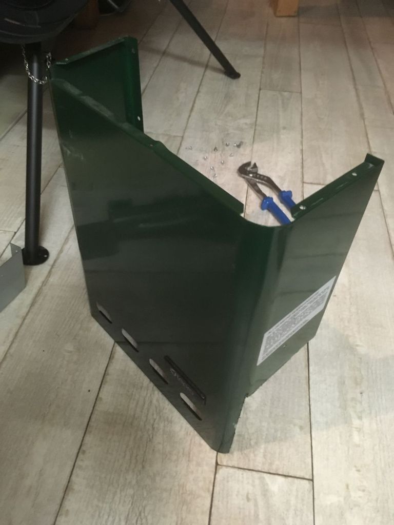

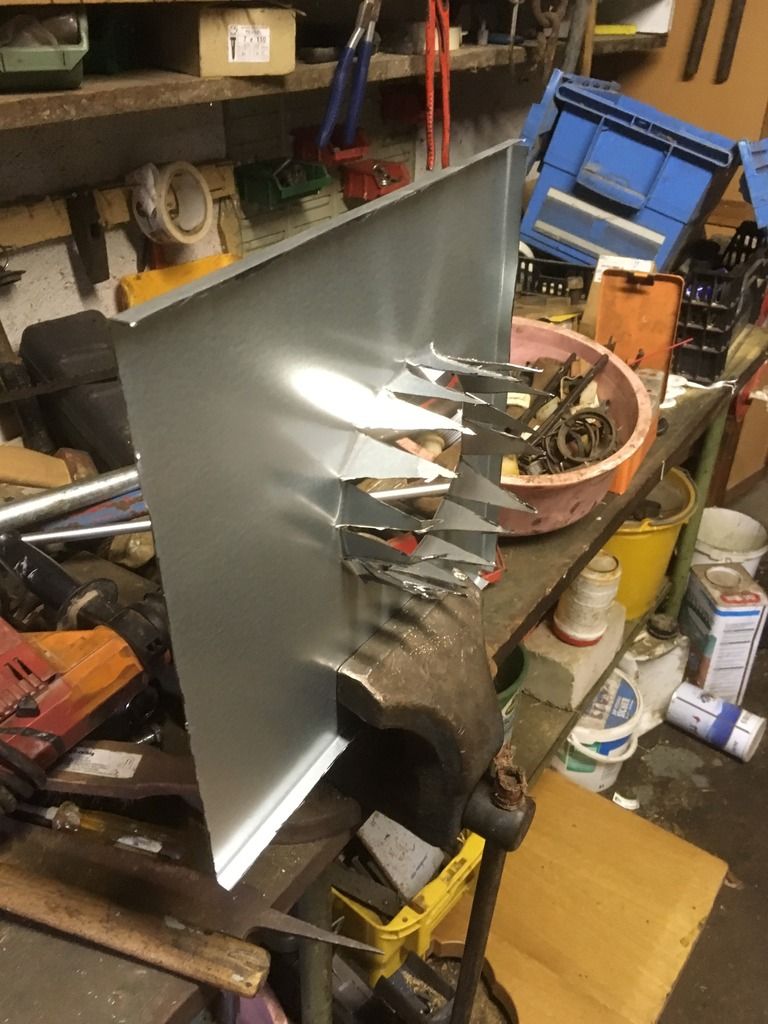

Postby axxez » Sun Feb 26, 2017 12:19 am
Worked on the stove vent today and then tried it out on wood, which is a bit tricky.. The car gets smoked very fast, so for starting a fire it's necessary to open all windows and maybe the door. The heat-shield that I build works good and things are not getting too hot after around 30 minutes of burning. It really doesn't need a lot of wood to produce enough heat for the small room. Tomorrow I might do a longer test run. Fire-extinguisher and enough water always nearby by the way!
I also bought a CO-detector(as well as a smoke detector) and tested it out by holding it directly over the stove-pipes. Works good and would interfere any sleep. Still I would never want to sleep next to it without stopping the fire and cleaning the glow.
axxez
Posts: 417
Joined: Thu Dec 01, 2011 1:39 pm
Re: Offroad MK3 Camper
Postby axxez » Mon Feb 27, 2017 8:58 am
Some more exessive testing led to the conclusion that before things around the stove heat up too much, the heat and air in the car is no more bareable. Outside it was 8 °C and inside I got 24-26 °C, maybe 30-40 °C on the furniture nearby.
