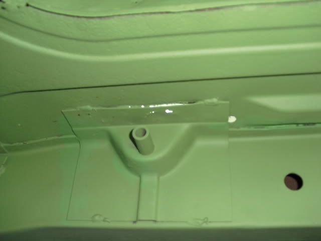

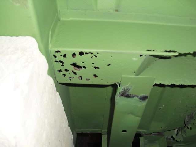

Postby malta transit » Thu Jul 21, 2011 9:35 pm

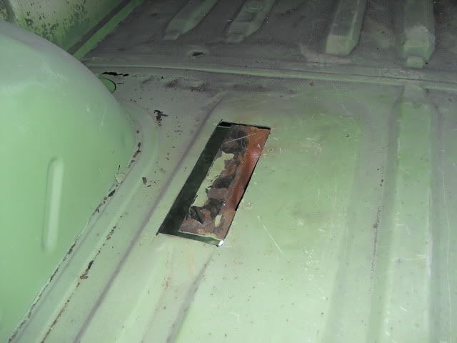

Well apart from moving the van from the back to the right hand side,all i did was cleaned a bit the back and inspected the hidden damage on the left hand side.
As i had encountered the same problem on the other side, i looked at the rusty holes on the floorboard were the mounting of the shock absorber from beneath, penetrates.
From below you can see better as you can see light.
So, i got my trusty grinder and cut out a rectangular shape, so i can weld up fresh metal, hopefully next week!!

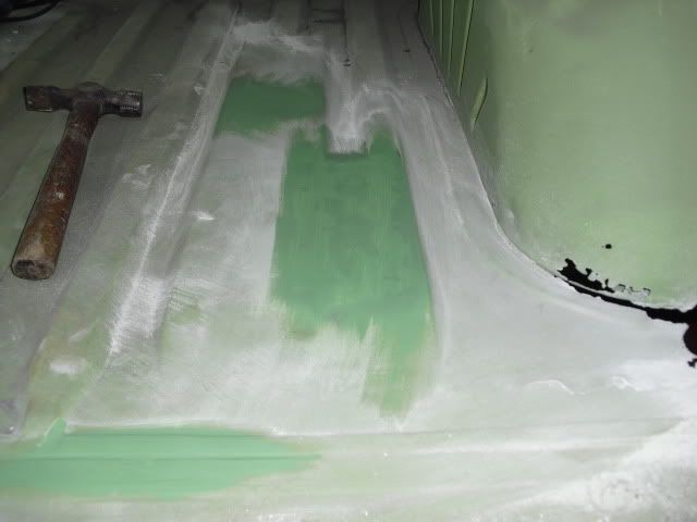

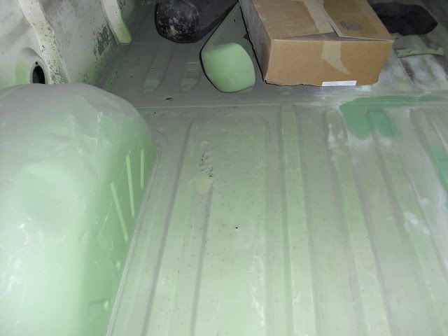

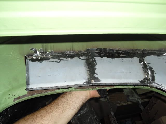

Postby malta transit » Thu Jul 28, 2011 6:55 am
This week all i v done was welded the rectangular patch, linished it and gave it a skim of filler and brushed painted it,
As to this rear part i smothed with filler and gave it a lick of paint. Not bad,as it came out well. You can't see were it was patched unless you knew :D

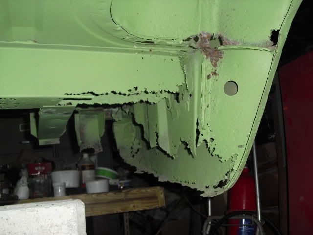

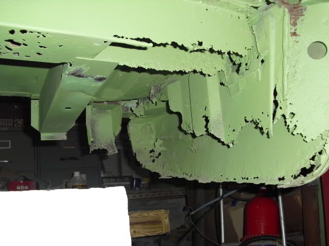

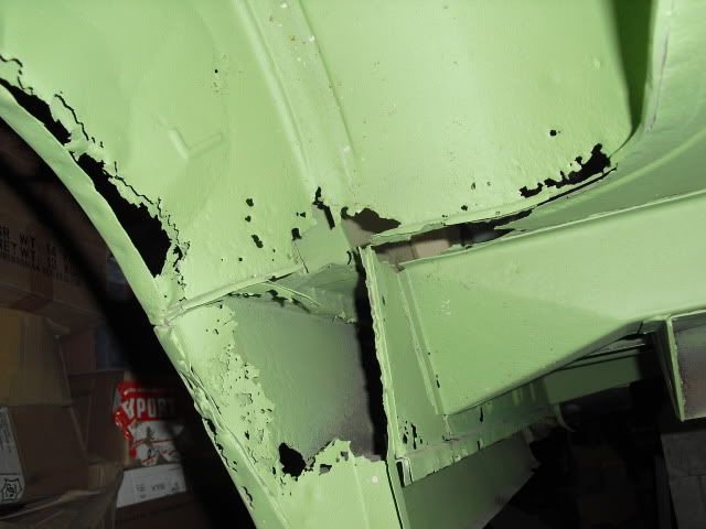

Postby malta transit » Sat Jul 30, 2011 7:41 am

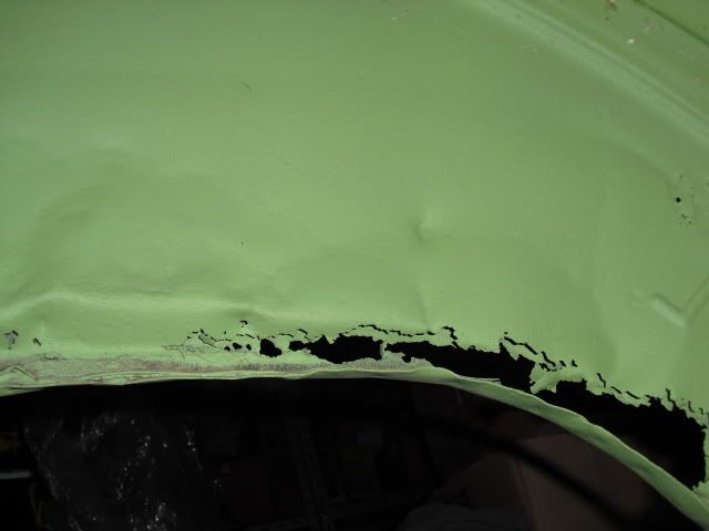

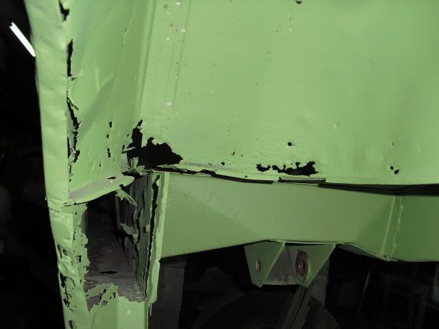

Today i started to inspect the other side from beneath. As you can see there is quiet a mess of rust and most panels have to be fabricated and changed as they are unobtainable.
After deciding were to start from ,i decided to start patching and repair the wheel well;

Postby noah » Sun Jul 31, 2011 7:42 pm
swiss cheese

Postby malta transit » Mon Aug 01, 2011 7:57 pm
noah wrote:swiss cheese
Green Swiss Cheese :lol:

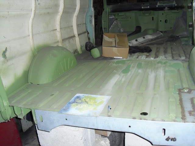

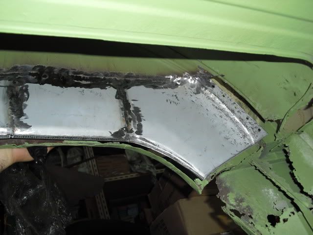

Postby malta transit » Sat Aug 20, 2011 9:46 pm
Well as i said , all i v done was some repair bits to fit wheel well. From this.....................................
To this................................................................................................................................
Next week i contiue as it takes ages to shape and fit................................................... 8)............
