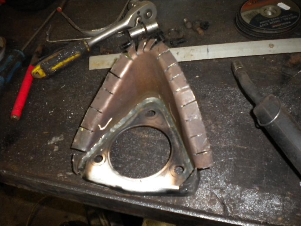

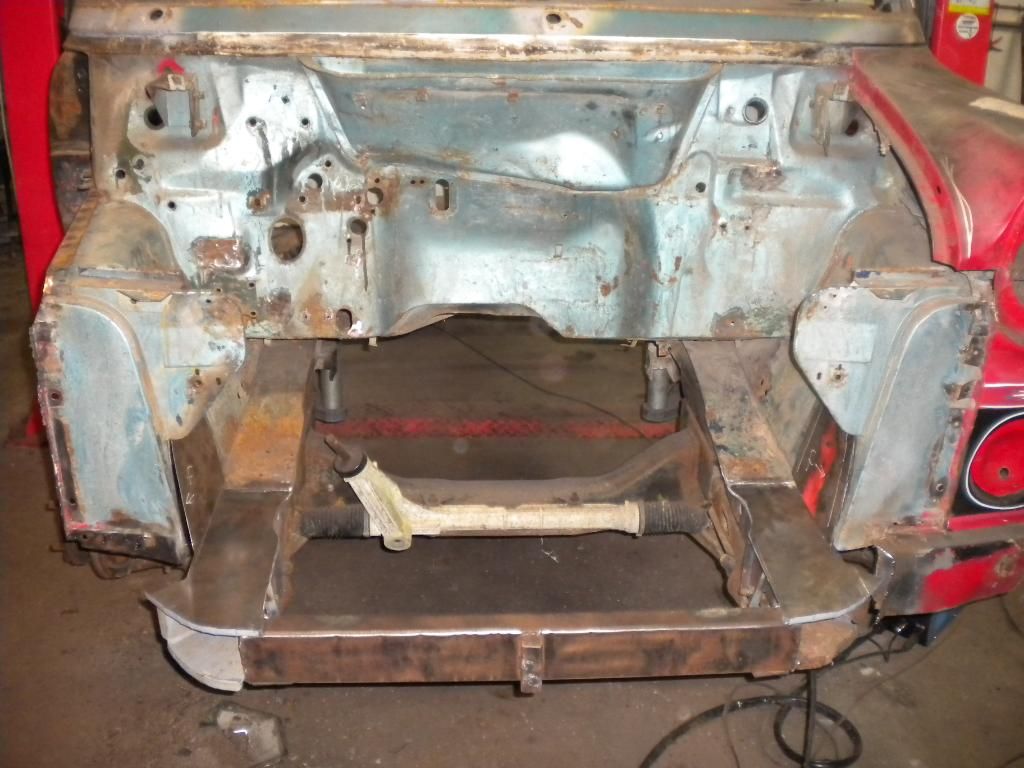

got the two filler sections shaped and tacked up in place.
then took down the subframe and welded up fully.

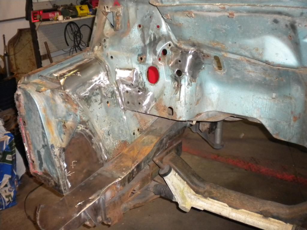

for the front fixings i had first thought about just using the existing spring hangers but even though the r/h one is in very good order..................
the l/h one has been plated over on each side with a bit of rot lurking underneath.

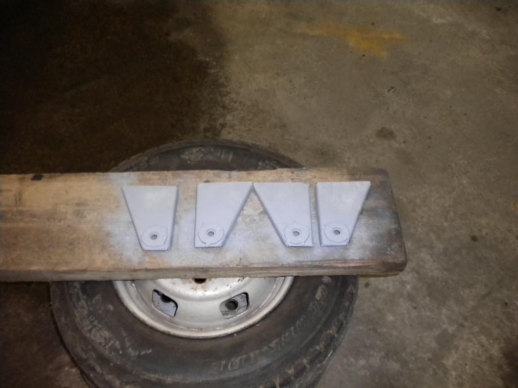

so the decision was made to go back to the bare legs and make up a set of tidyier looking drop brackets for the subframe.

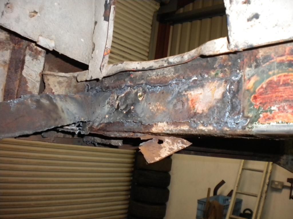

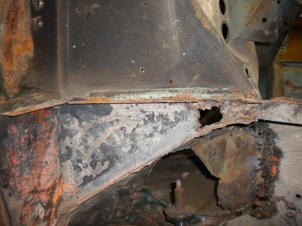

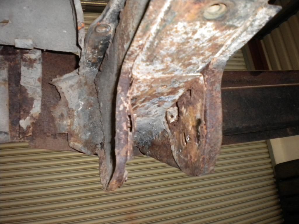

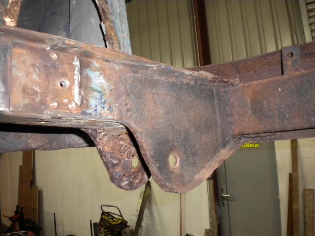

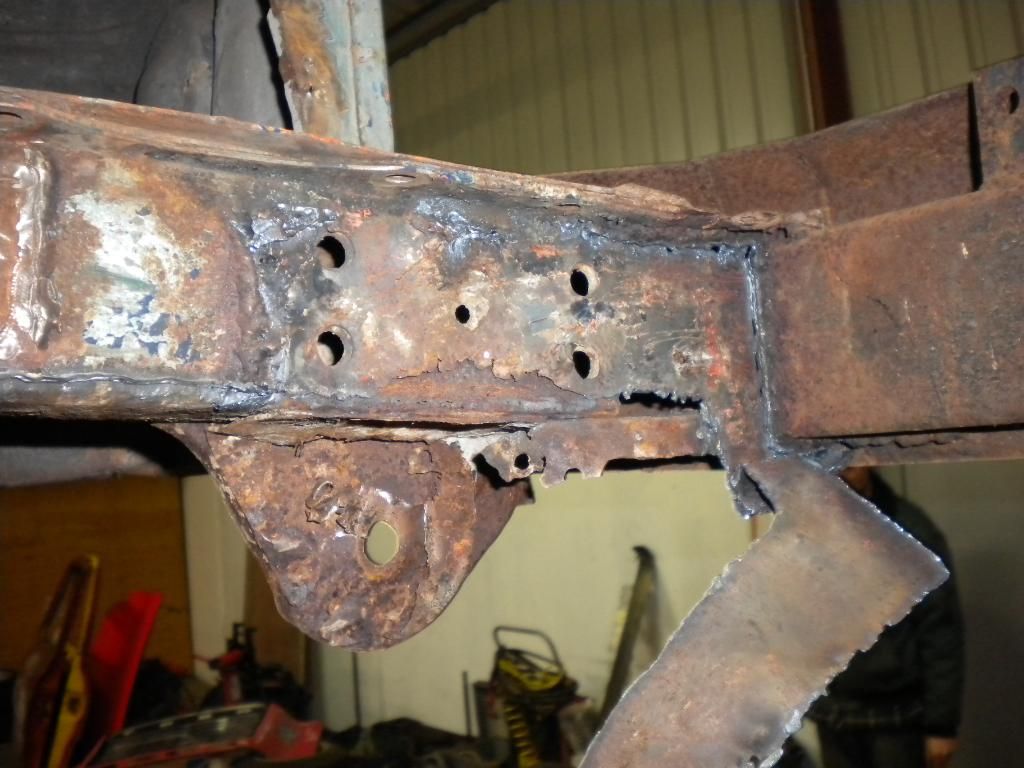

and surely when i started peeling the repair plates off i found some more nasties beginning to spread into the chassis on the left side. so we ill be cutting the last couple of inches out and making a piece to go in. this is slowing progress a little but i think its worth it as the rest of the chassis is so mint.

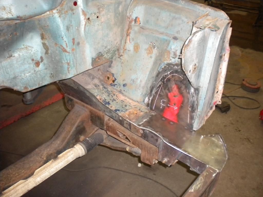

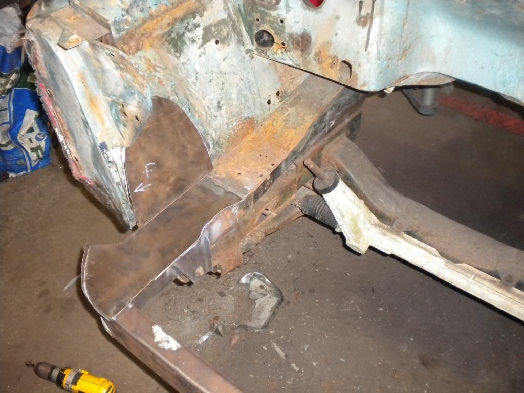

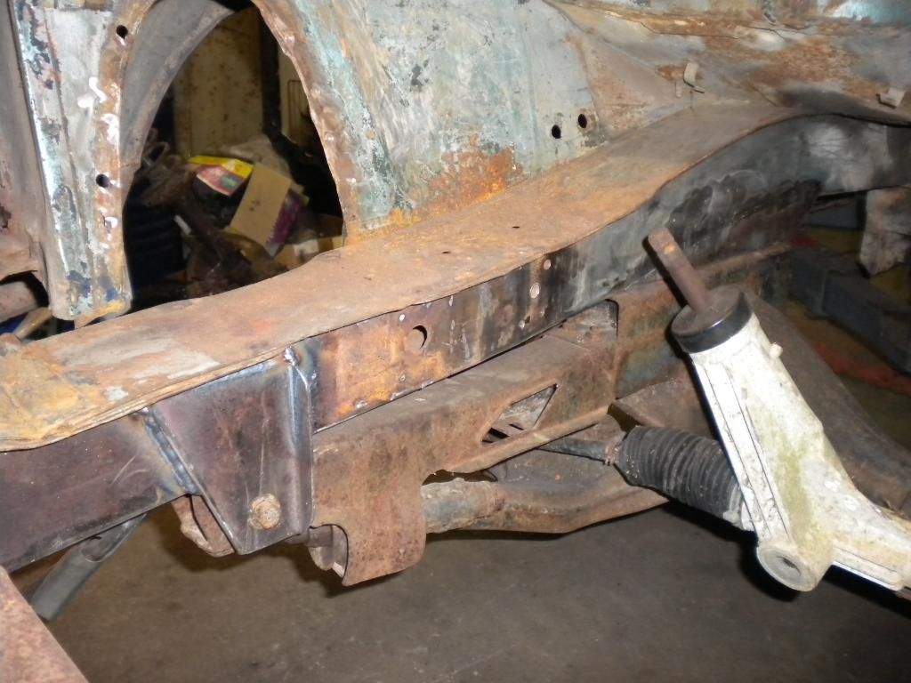

latest update,......

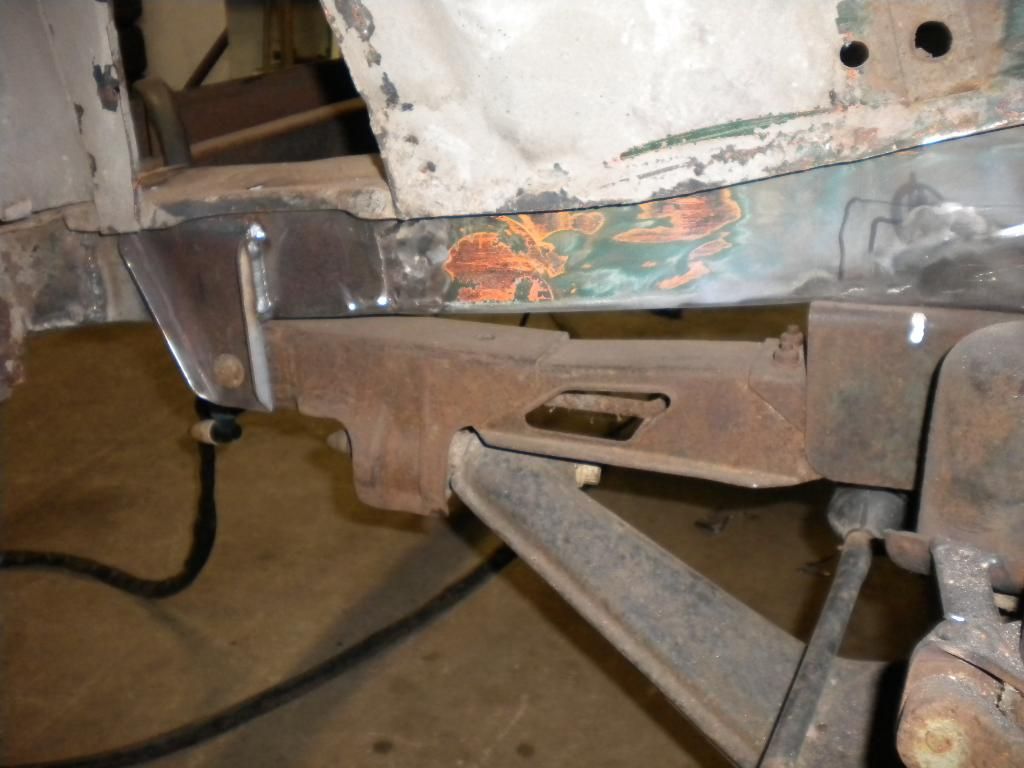

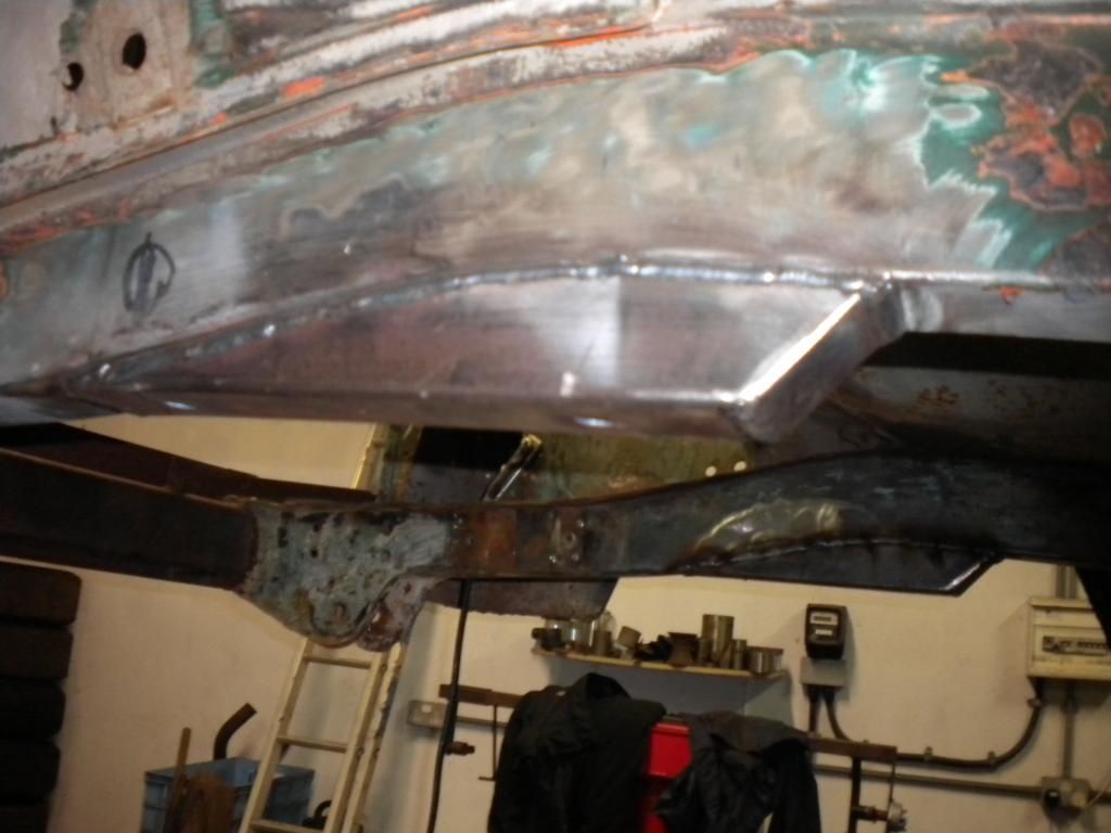

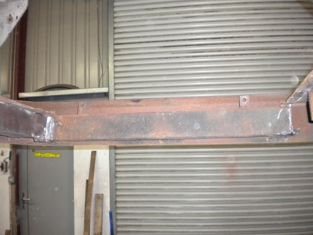

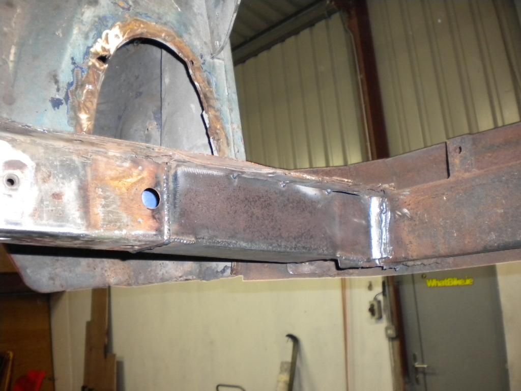

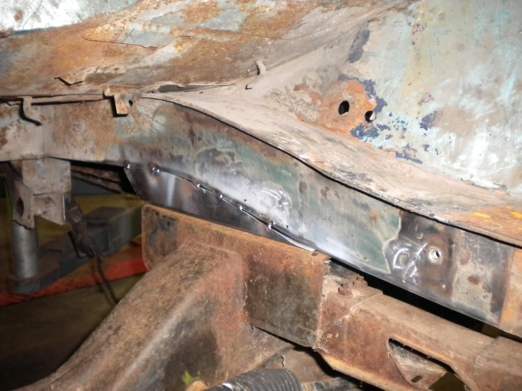

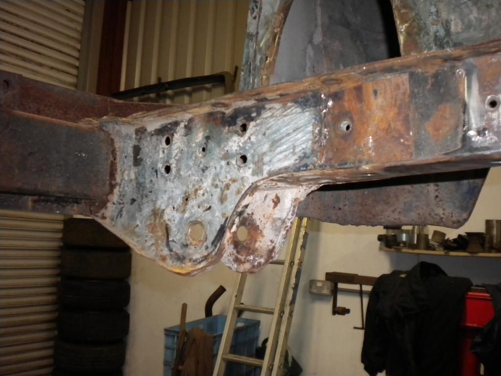

we continued with the chassis end repairs.

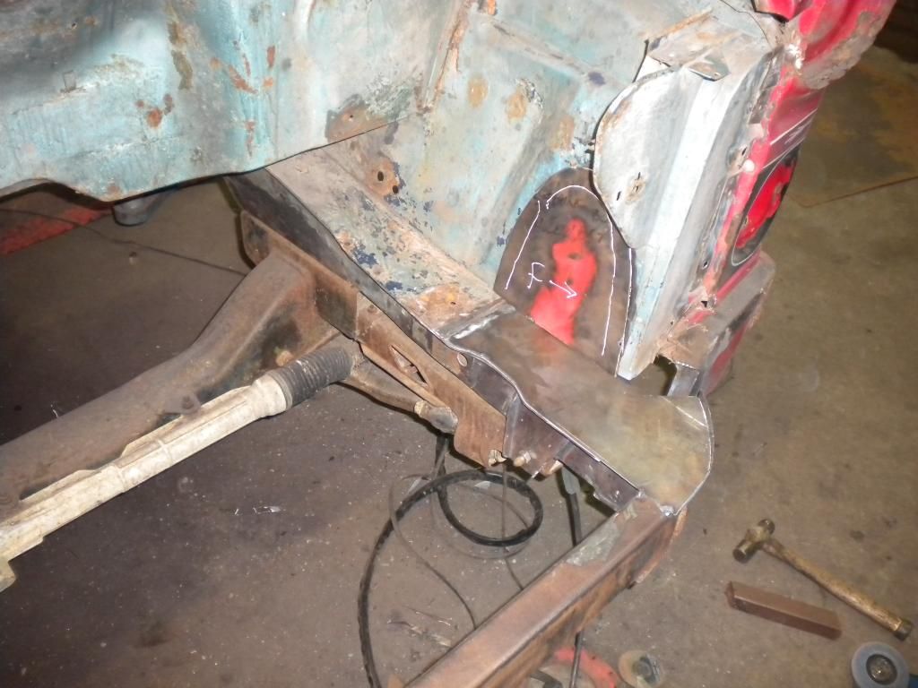

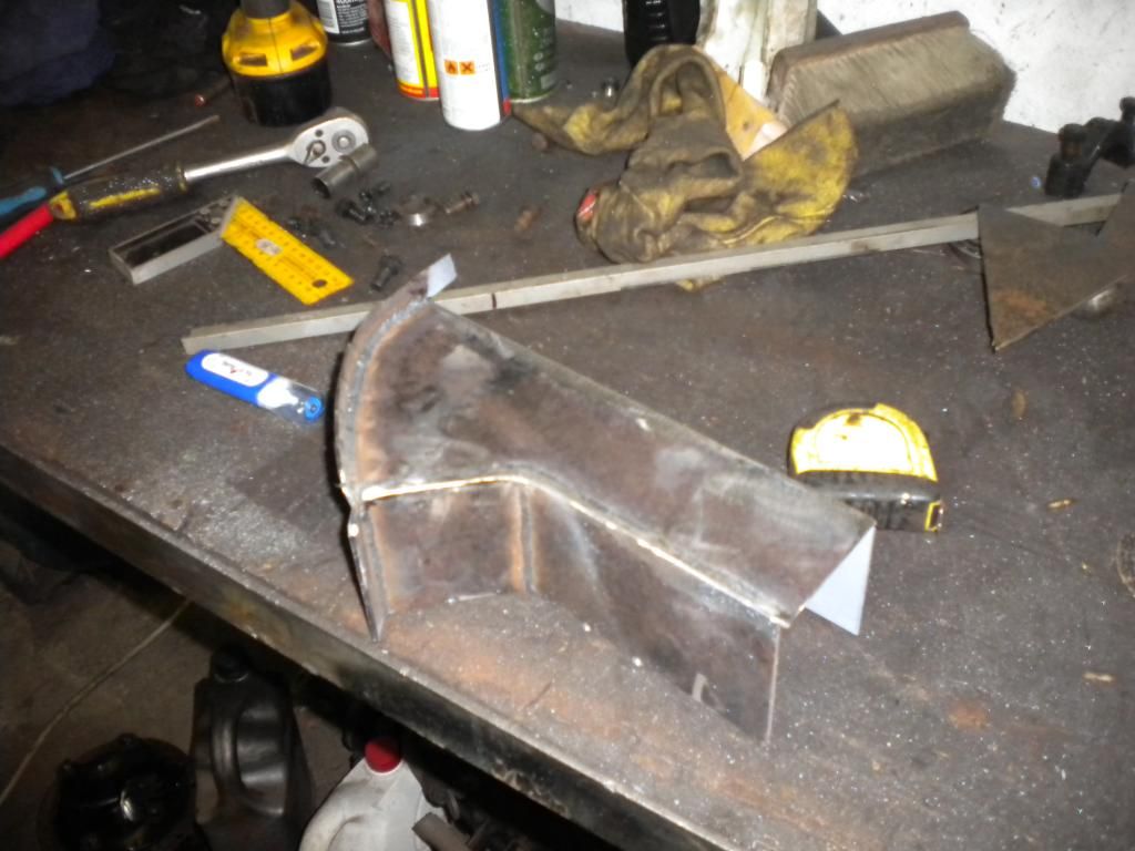

to save a bit of time i just removed the entire end of the r/h leg instead of peeling the spring hanger off it.
and heres the replacment section my mate made up, i think its fair to say hes a top notch fabricator.
there was a rectangular box section fitted across between the legs at some stage to replace the original crossmember. we decided to keep this as its good and solid and was fitted pretty well.

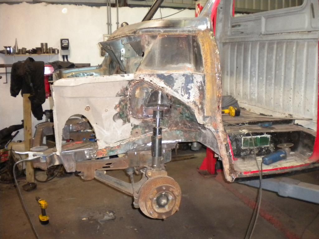

so once the repair sections were fitted it was in with the subframe again and after one last measuring session we got the front drop brackets welded in place.

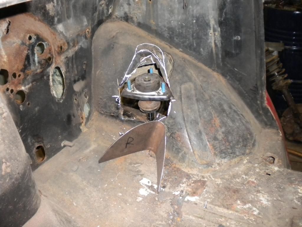

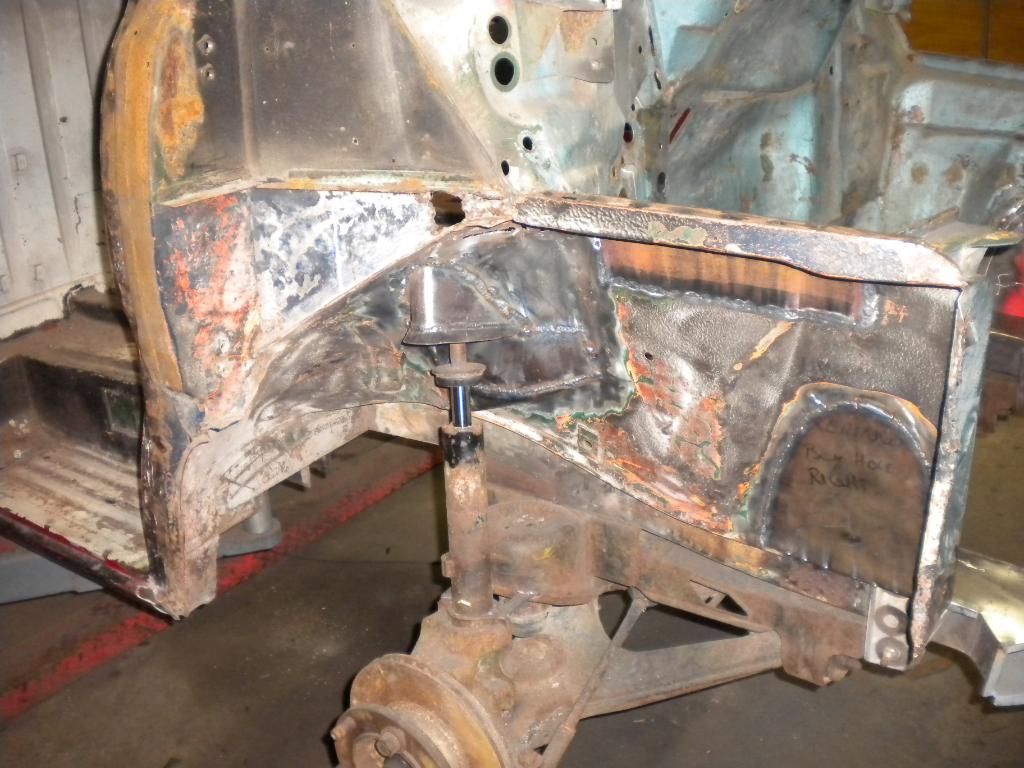

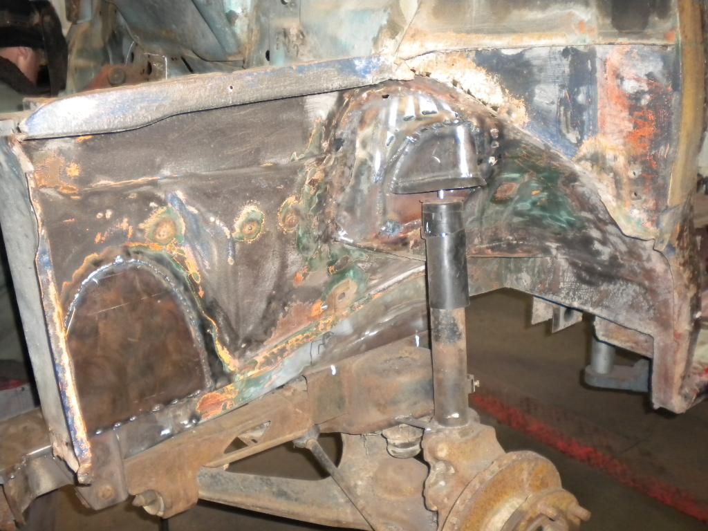

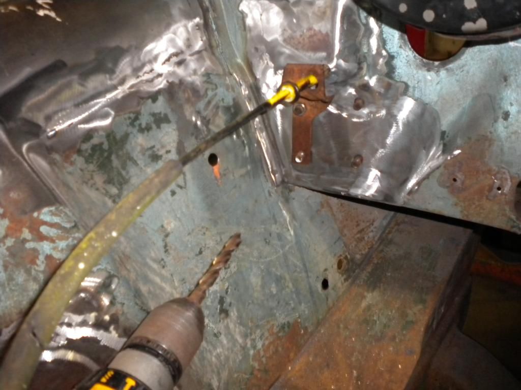

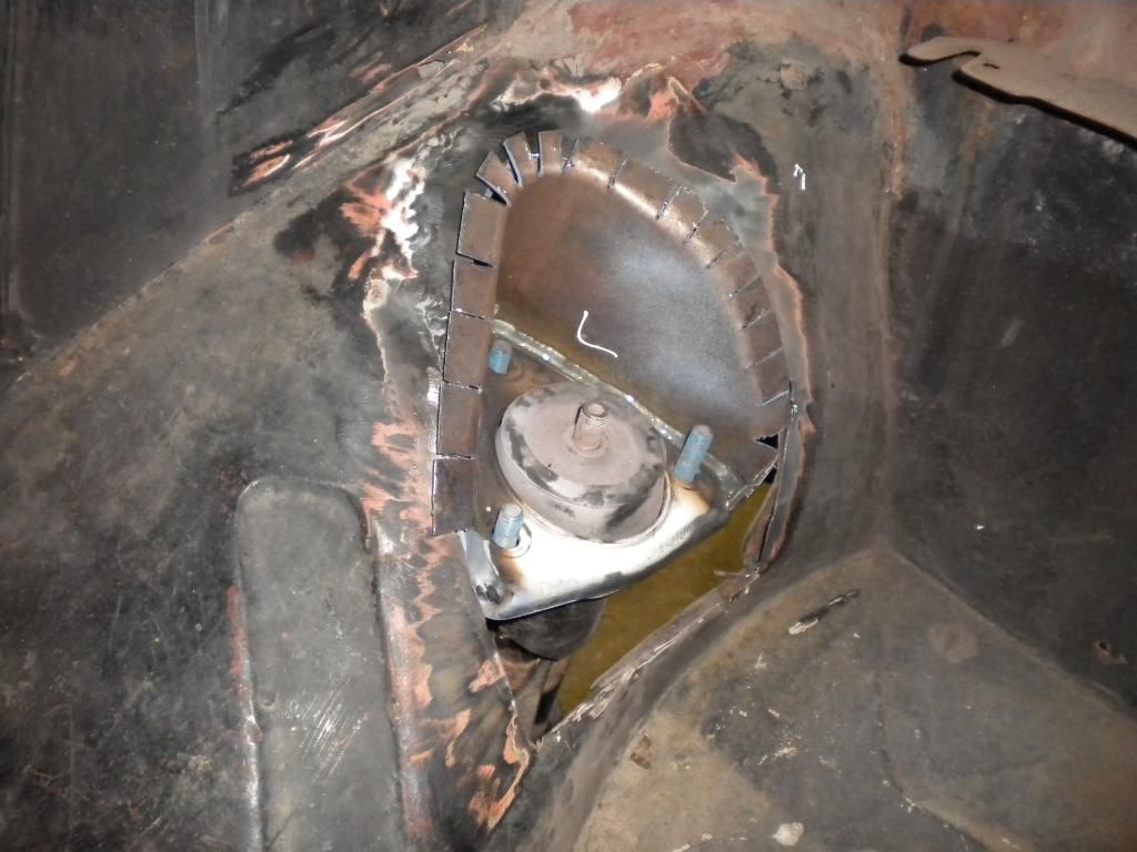

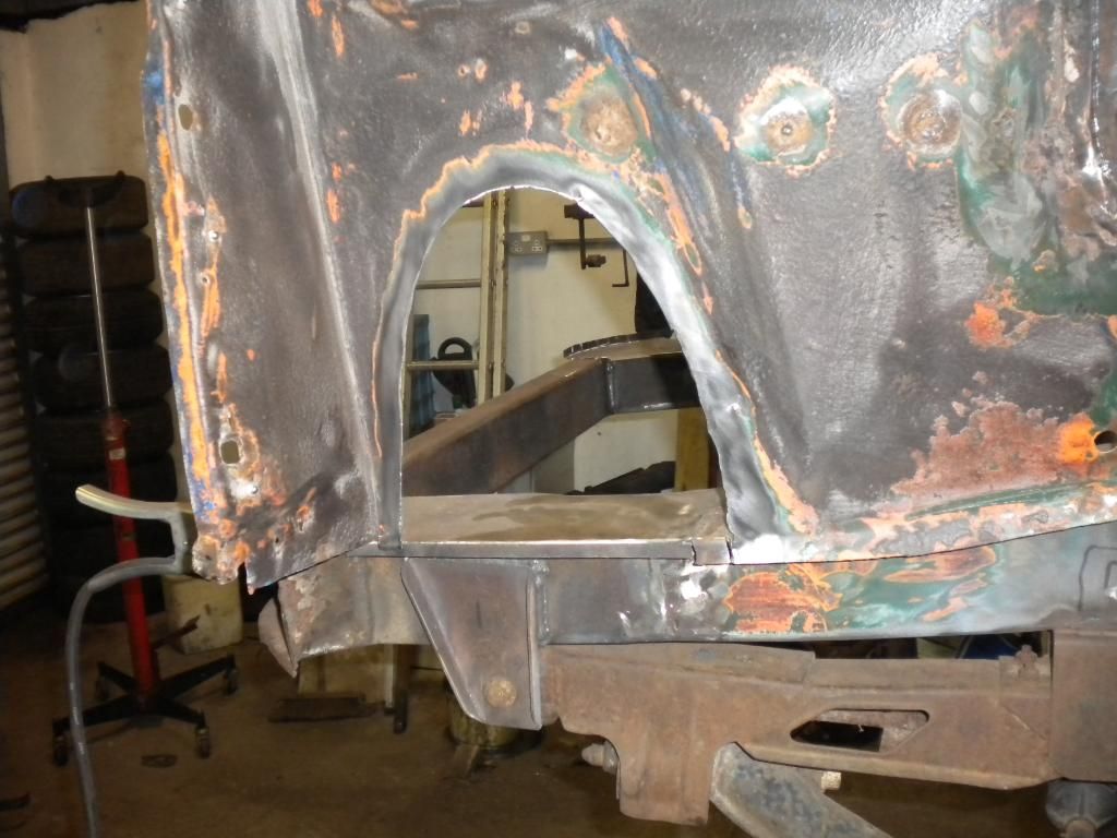

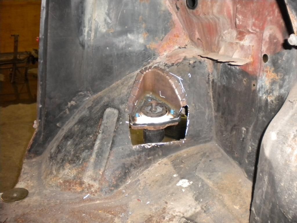

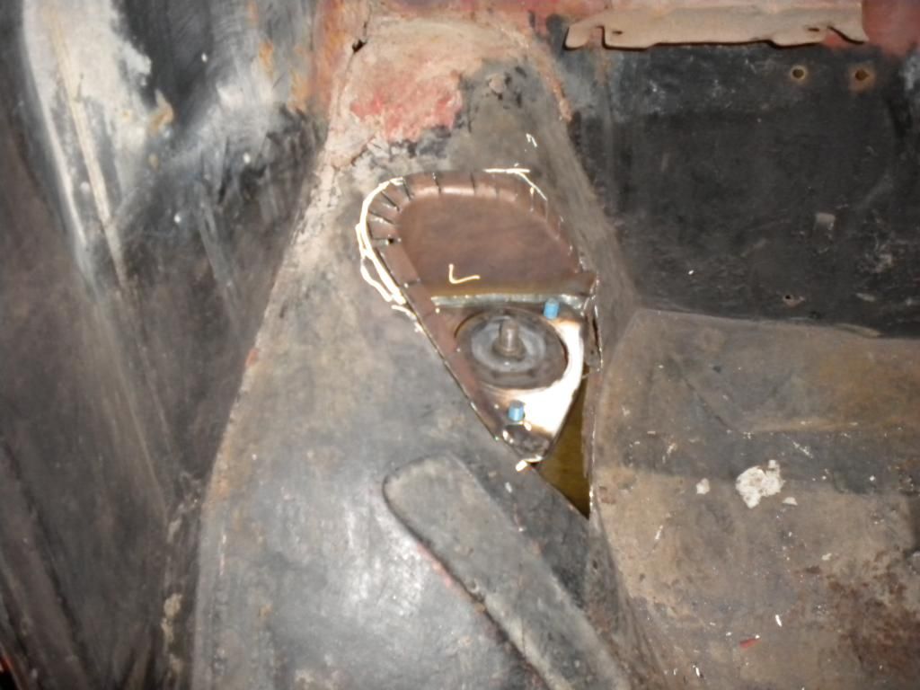

and next for the dreaded part of chopping through the inner wings to mount the mk5 top mount turrets.
after sizing up the height they should be mounted to allow enough shock travel frank once again came up up trumps with a mounting.
and in place, some trimming needed yet.
and thats as far as we are for the moment, i have to get some more 1.5mm sheet tomorrow to finish them.

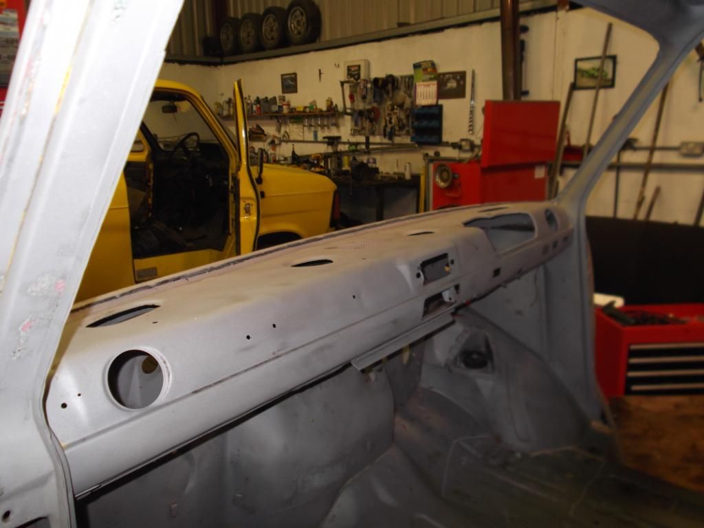

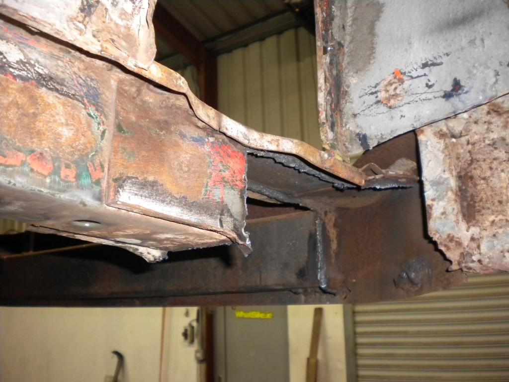

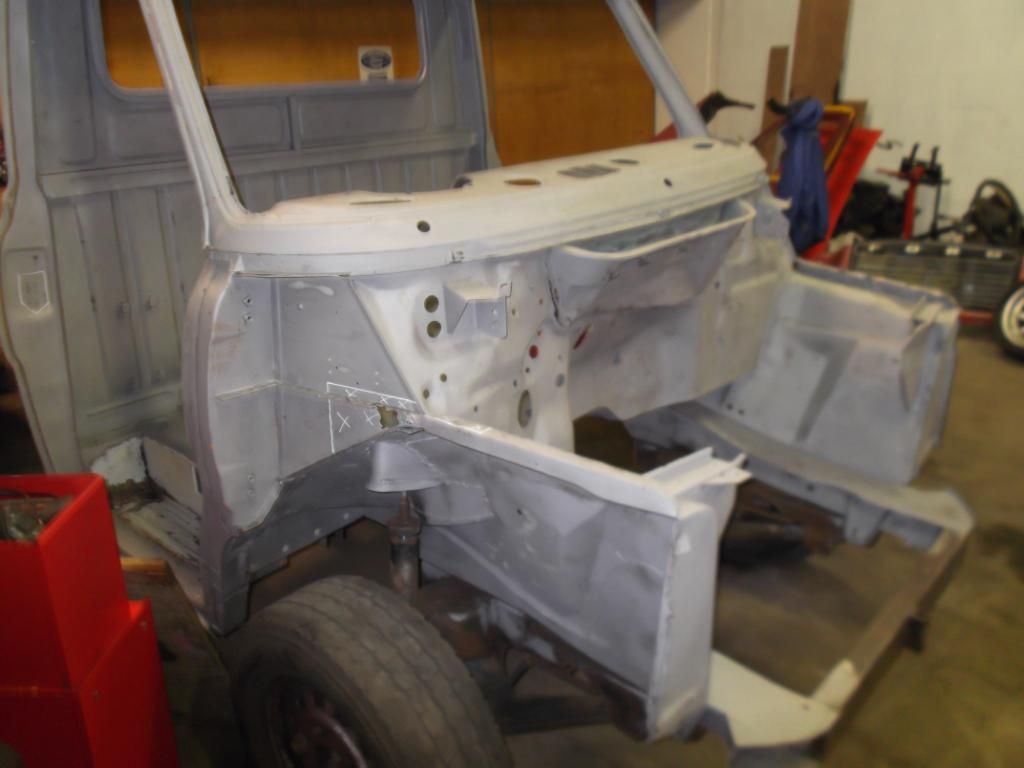

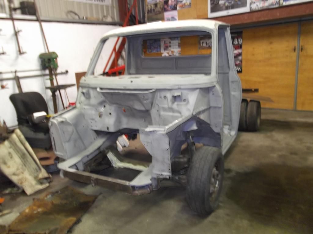

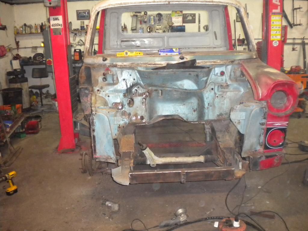

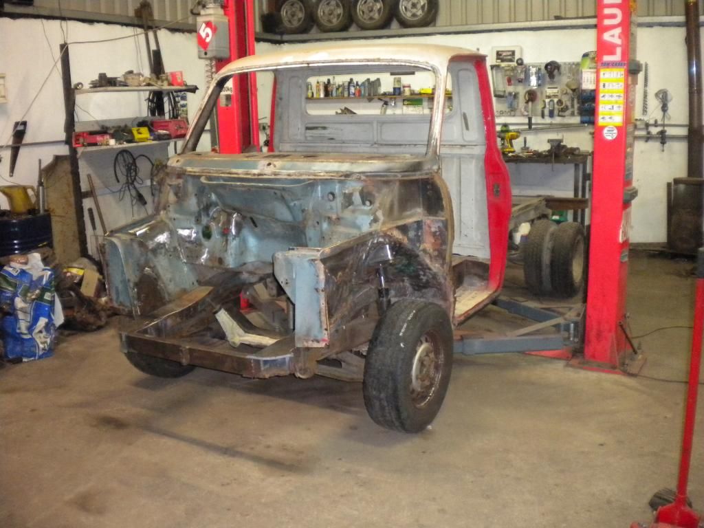

we got a good shift at this over the weekend, starting to make a decent bit of progress,......

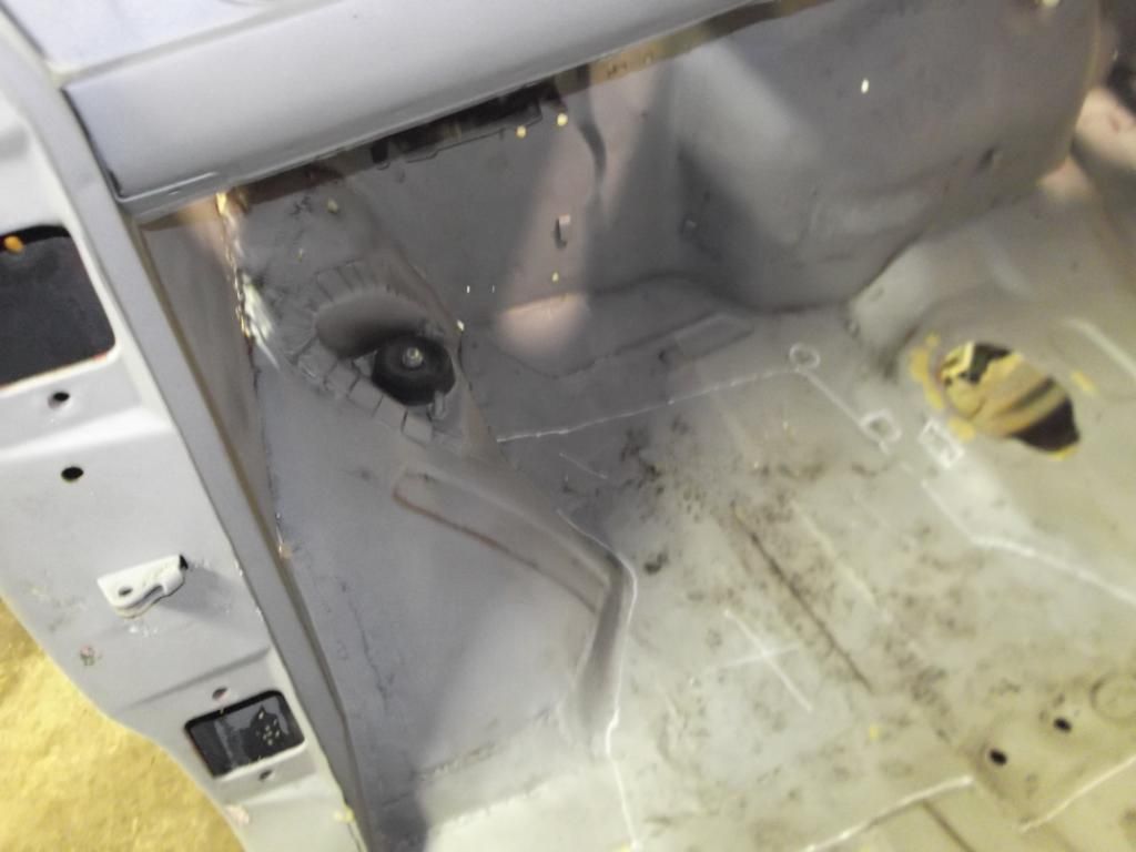

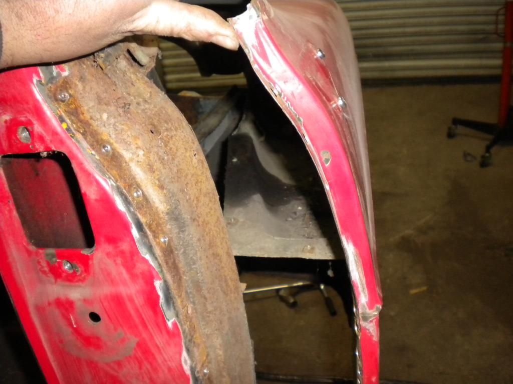

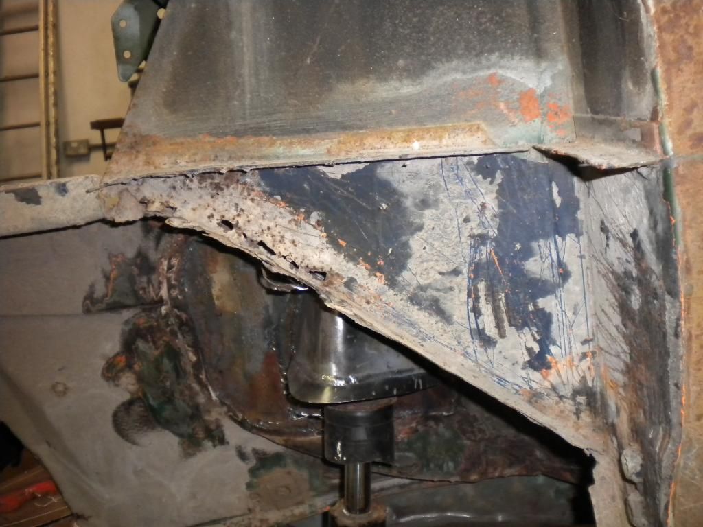

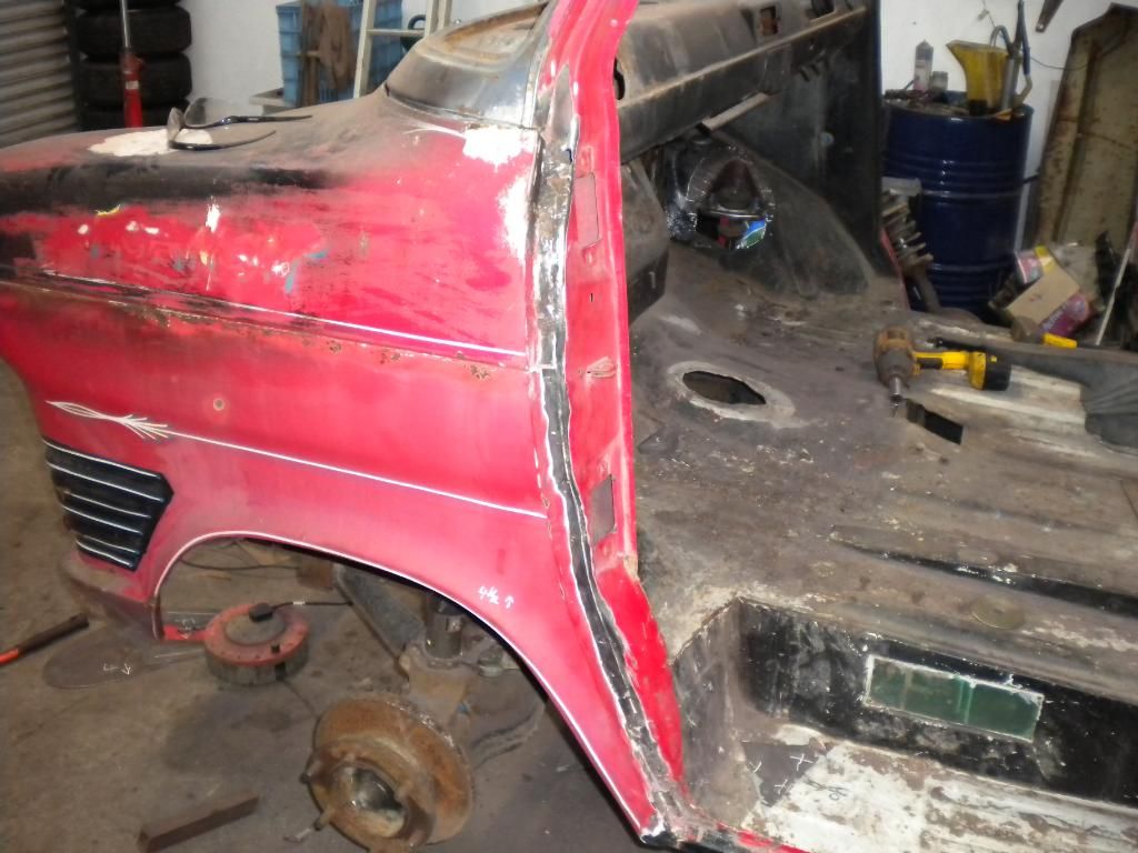

got the wings off with a bit of work, these vans really were well put together with the wings bolted internally aswell. i took them off as carefully as i could leaving the option of using them again if i cant find replacements.
the top chasis repair sections are now in as well.
underwing areas are not too bad, just a small repair section needed each side, having the wings off also gave good access to the top mount turrets to weld them up on the outside.

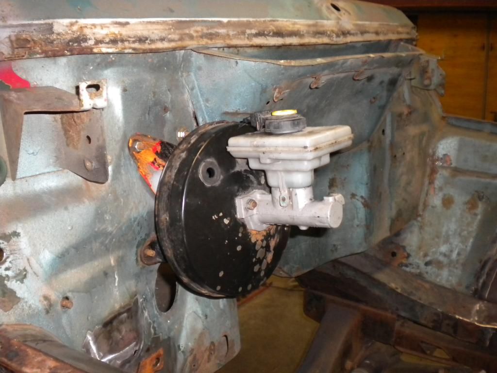

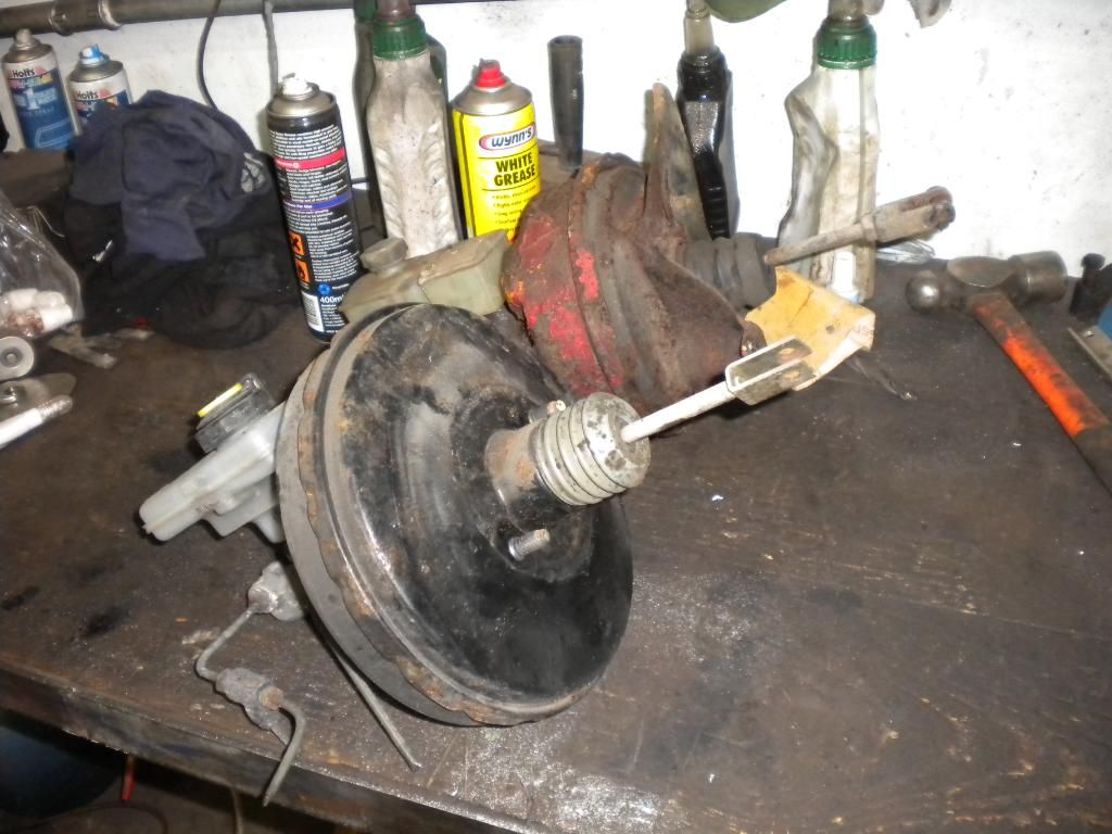

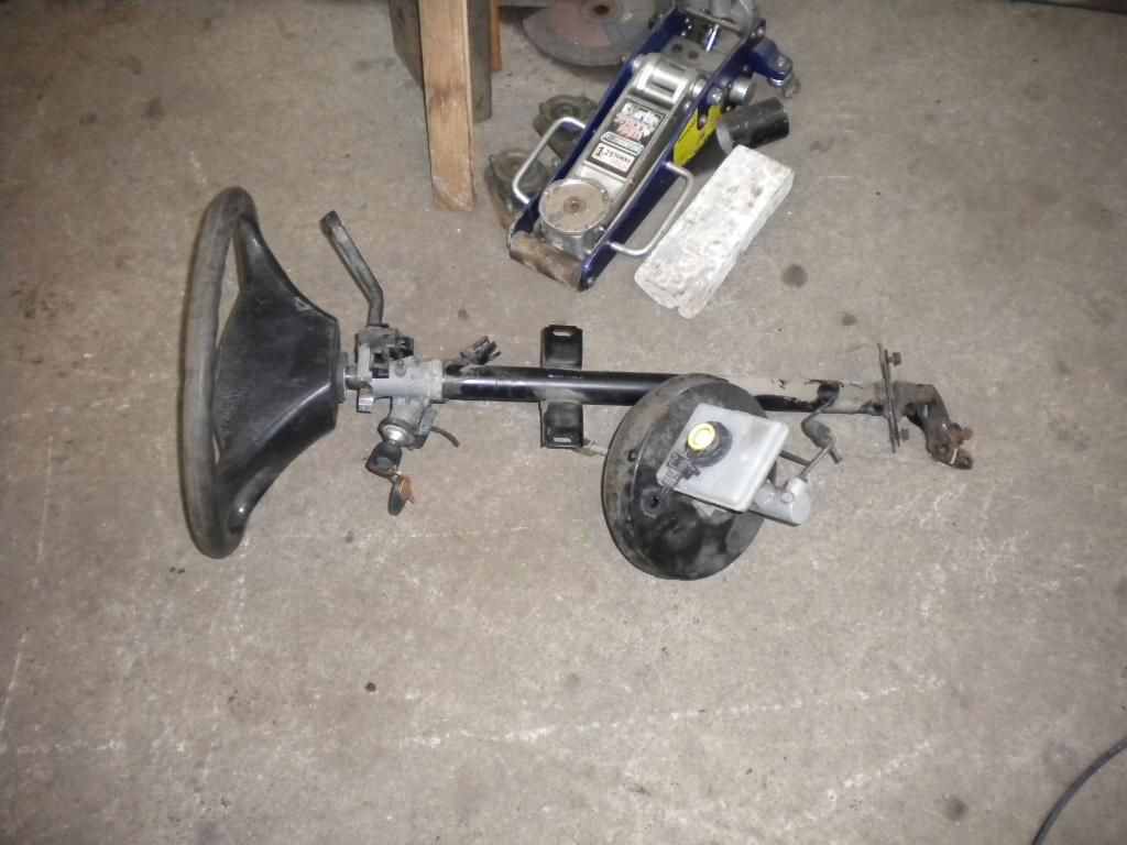

i nicked a few more bits from the mk5 for some mocking up.

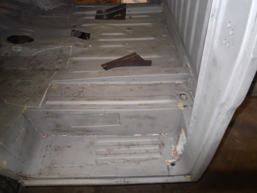

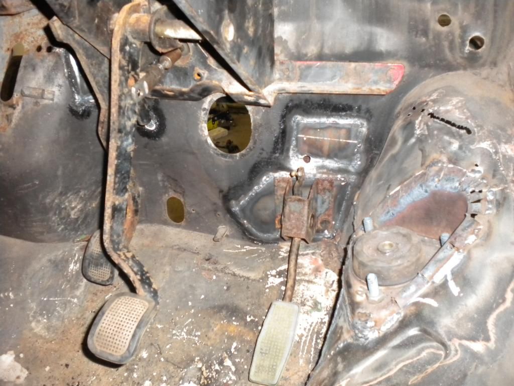

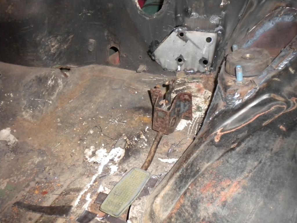

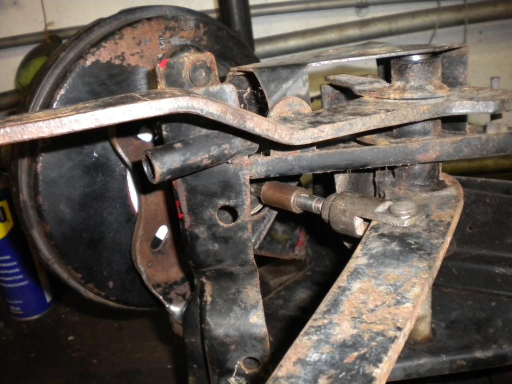

i also fitted a mk2 pedal setup which is a lot simpler than the mk1 pedal assembly. the bulkhead had cracked around the large hole used for the mk1 setup and needed replacing anyway.

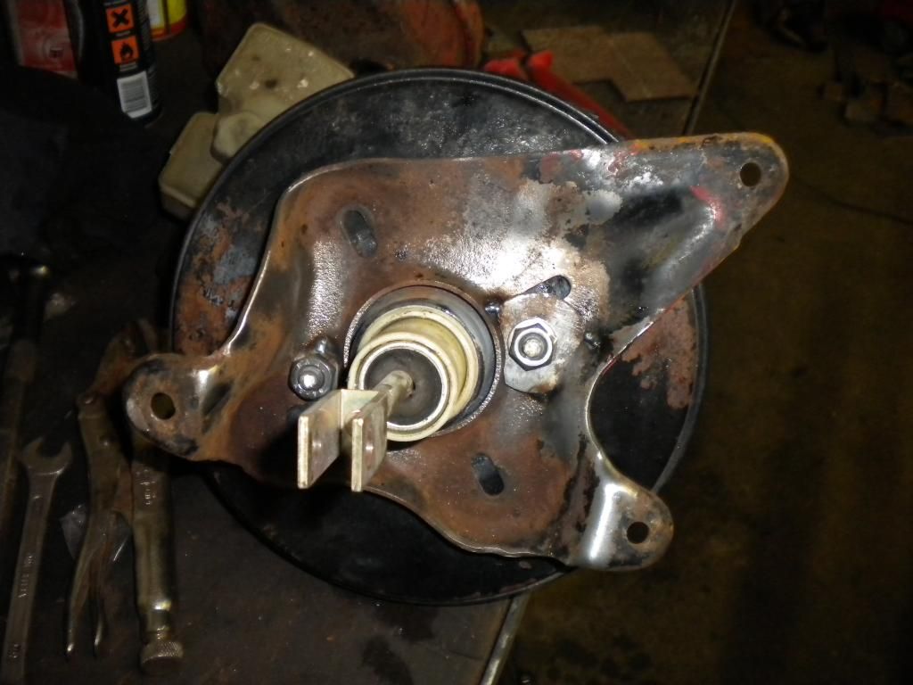

also set about modding the mk5 servo/cyl to fit.
re drilled the bracket to take the two bolt fixing.
i had to space it out a little as the brake was on slightly when it was bolted up to the bulkhead. so i just made up a shim from a bit of 2mm aluminum sheet.
the mk5 rod was a little short so i made up a sleeve and mated it to the mk1 end which has adjustment which ill be handy.
and sitting in place, worked out easier than i thought!
next plan is to take it for blasting before tackling the rest of the body repairs. ive got it rolling again on a pair of 6 stud mk5 rims i got the loan of.

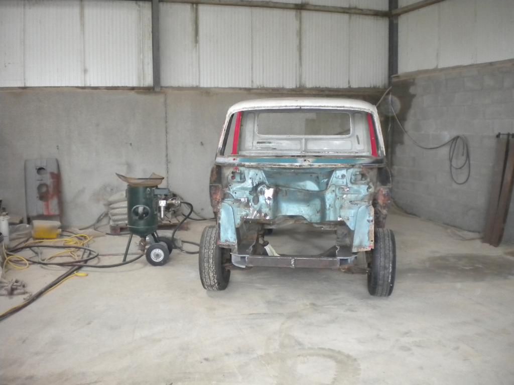

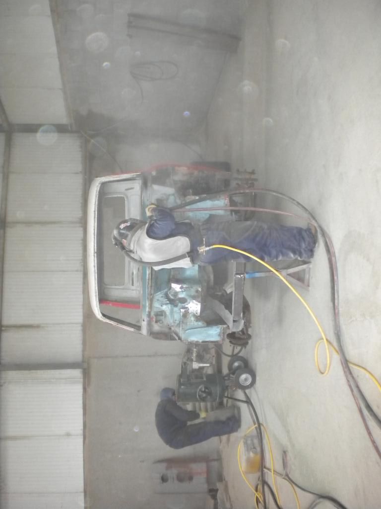

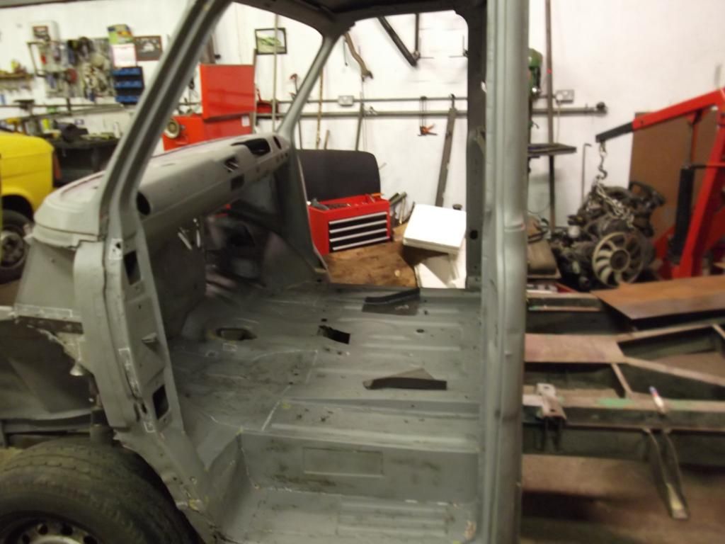

Postby oldskooler » Thu Feb 02, 2012 11:39 pm

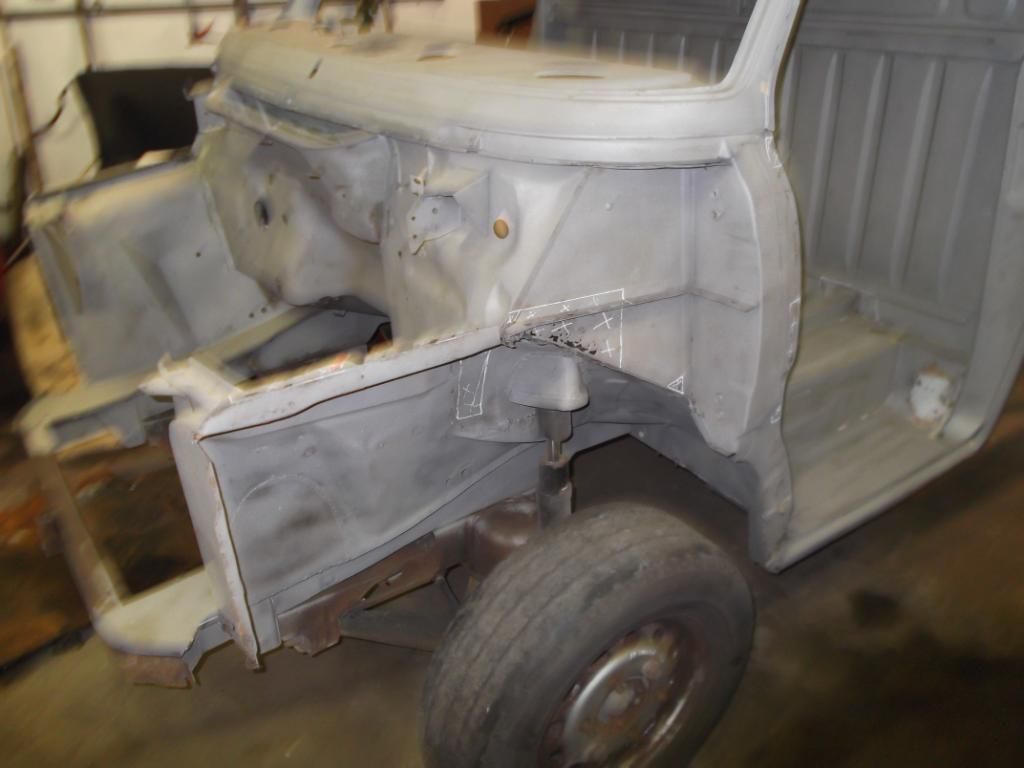

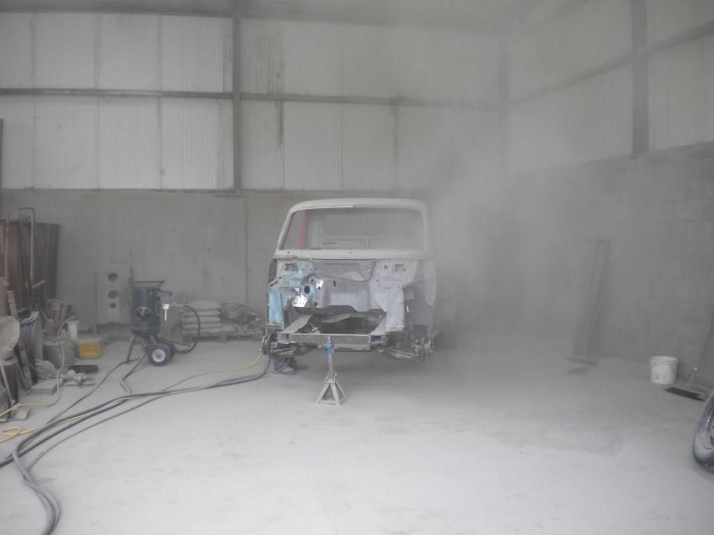

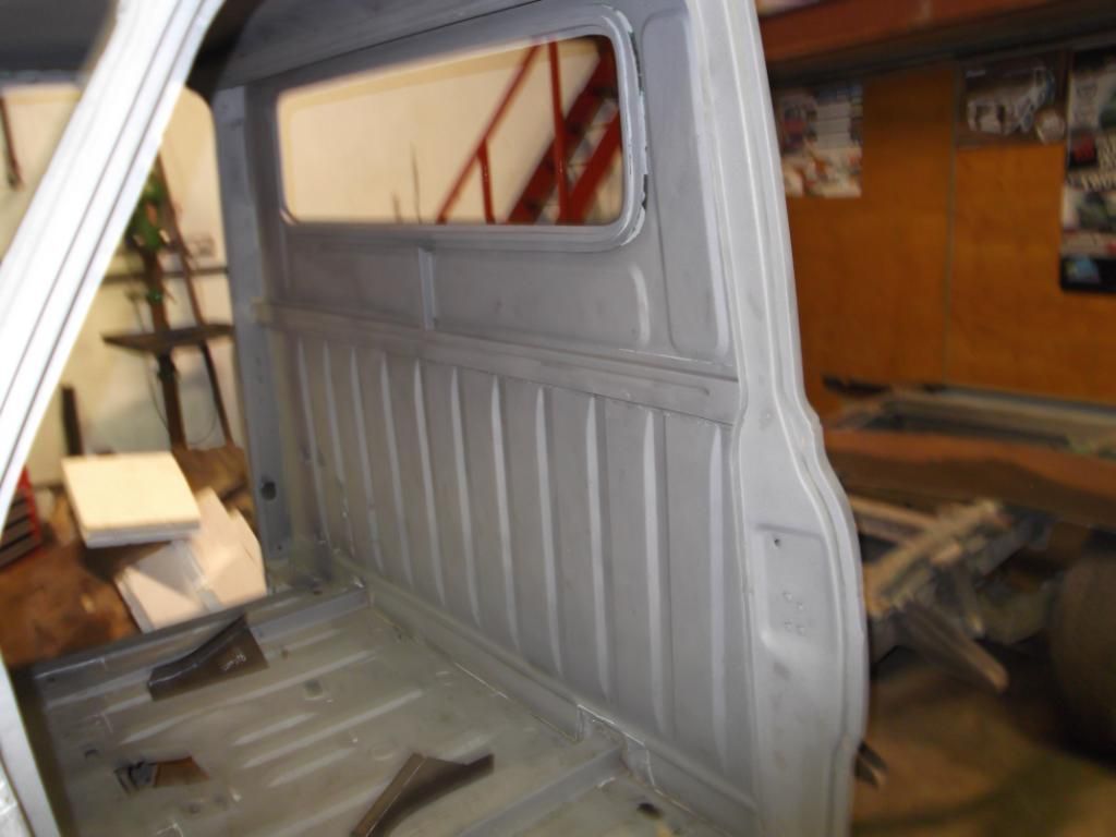

well with the recent spell of dry cold weather i managed to get her away for blasting and back dry thankfully.
it revealed a few patches and repairs i hadnt seen and a few more small repairs that are needed, but overall im well happy. the chassis and outriggers under the cab are mint. 8)
ill be bringing it back for a light blasting after we have done the rest of the repairs and ill get the back half of the chassis done then as it needs little or no work. then it ill be etch primed straight away hopefully.

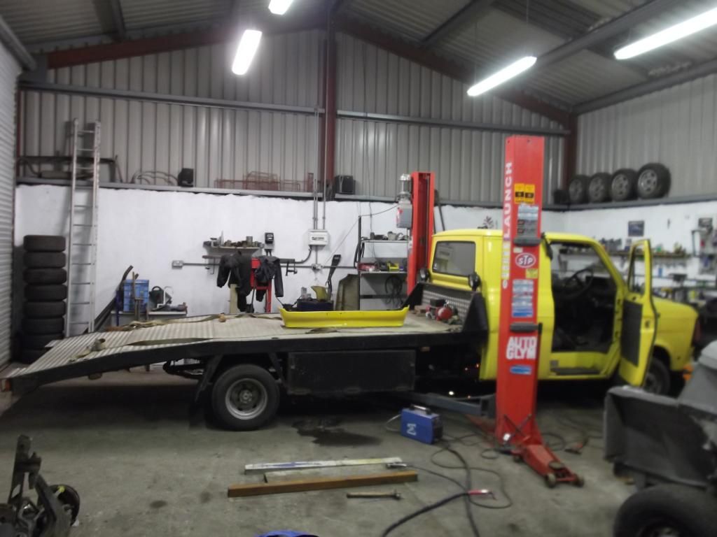

there will be a slight delay in progress for a while as we now have marks recovery on the lift for some cab floor and chassis attention for the mot. it makes the garage look pretty small when its on the lift!!
