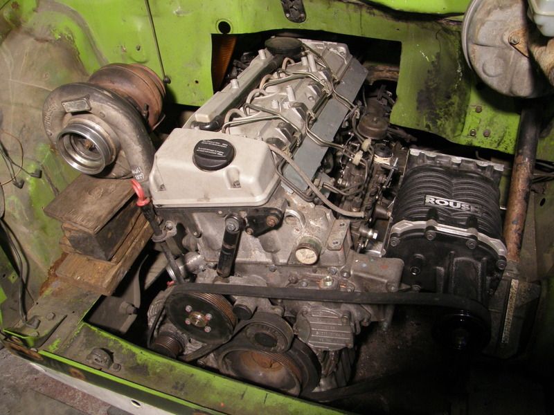

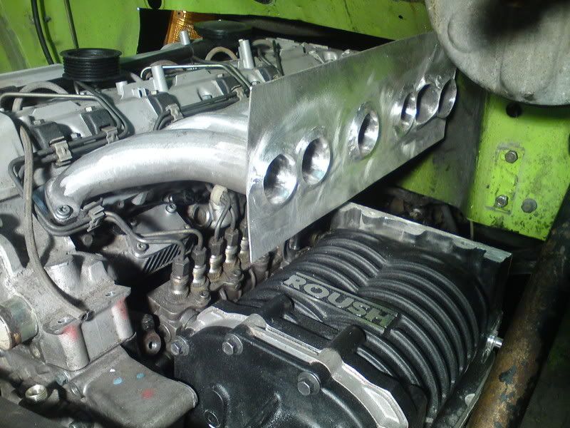

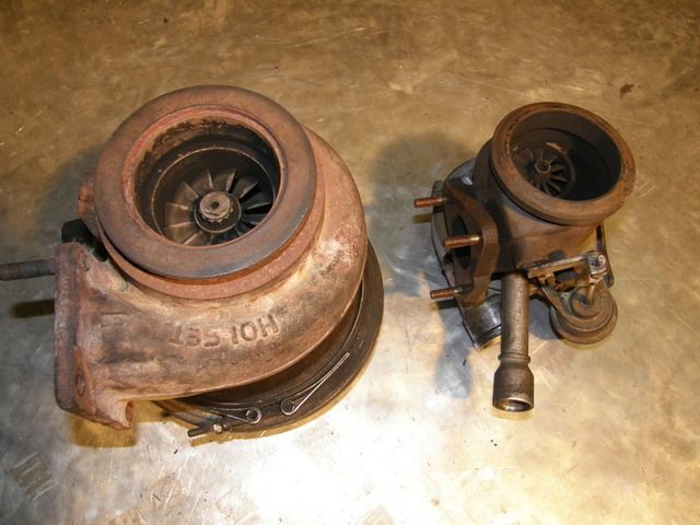

I have finally decided where to put the supercharger and made the bracket for it. Now I am working on the intake, I hope the plenum will flow equally much to each cylinder.Image

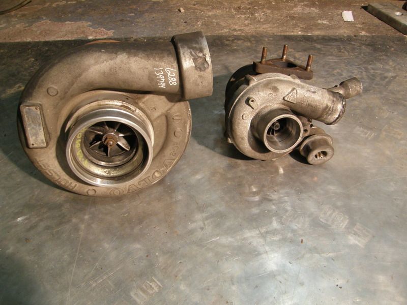

I was thinking why build a super diesel Transit when a super turbo diesel Transit will be faster, so I bought a turbo :D Maybe it is a little bit small? :lol:
Here it is next to the stock Mercedes turbo.

Postby transitandy » Thu May 10, 2012 11:39 pm
A bit different in size indeed :?:

is that a Holset HX55?
Nice either way :P
Just make sure you remove the intake silencer ring :twisted:

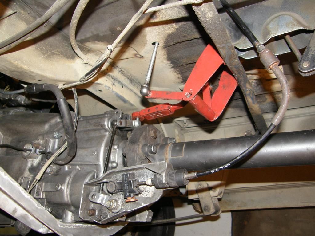

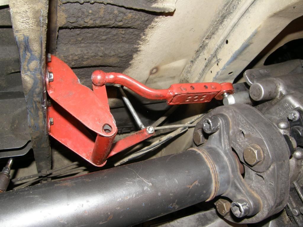

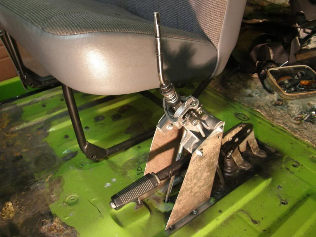

I have finally started to work on my Transit/mercedes project again:)
The 6 speed box came with the original shifter but I could not put it in the position it was meant to be. The Transit has no tunnel and there is a seat in the center of the car so the shifter had to be moved up and to the side. That meant some modifications with new linkage. Here are a few photos with what I made. It works ok but I need to drive the car to see if it needs further modification so I will wait with finishing touch.

Postby oldyellar » Wed Dec 12, 2012 8:28 pm
thats some fab fabrication mate 8)

Postby Luke » Wed Dec 12, 2012 8:44 pm
nice work 8) 8)
