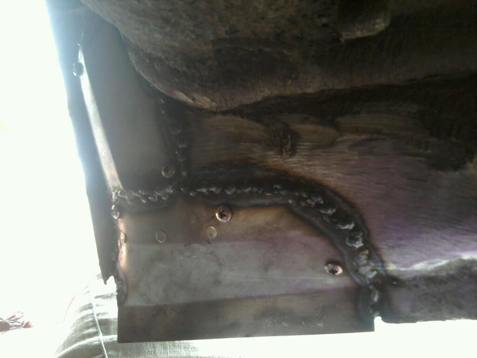

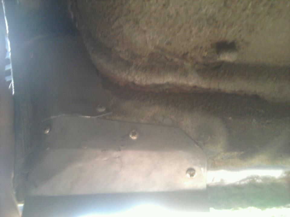

Patches in place ready for welding[/quote]
In a small garage i did a bit of work in once that was considered a good repair for mot as long as it was plastered with filler and underseal after

Patch welded in :)
Well, that was good progress today. I got the wheel bearing changed, the patches welded in (thanks Murray!) and one set of brake pads in. Final push tomorrow, then back to the test centre Wednesday!
