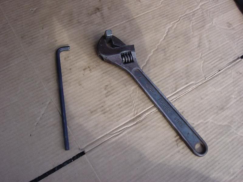

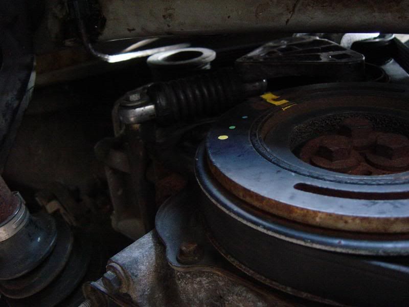

Got the belt and tensioners done this morning....never again! :evil: What a crap job, remove alternator and wedge out of the way (it will not come out! [got the 105A one too 8) ]) Remove the two alternator mounts, one steel and one alloy, and replace with the donor bits, the top alloy one has one of the idlers and the tensioner assembly, the bottom steel mount has the hole for the tensioner spring. The other idler sits on a stud, (already there :!: ) totally out of sight under the engine mount. All the pics I took are crap, due to the very limited space at the front of the engine.
Getting the belt on was a total tw*t too, tensioner pulley needs to be removed, the one the TIS says cannot be removed in situ. :? , belt fitted, tensioner replaced and compressed using makeshift tool on the right:-
...belt slipped over pulleys, and tensioner released to tension belt.
Makeshift tool for undoing / replacing the tensioner is the ground down 8mm allen key on the left.
Engine running and everything ok........so far.

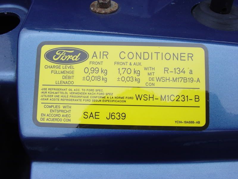

Cheers Mark, and thanks for the pic of the label position,
making it look authentic now:- 8) 8) 8)
Went to Fords for this, to be told "unobtainable that sort of thing, all chucked away when a vehicle goes out of production" :(
so had a word with the parts man who could be arsed, and 1 x 4156175 Decal YC1H 19A688 AB ordered successfully! This is the same as your TDCi Mark, just hope it's the same as the early ones. :?
